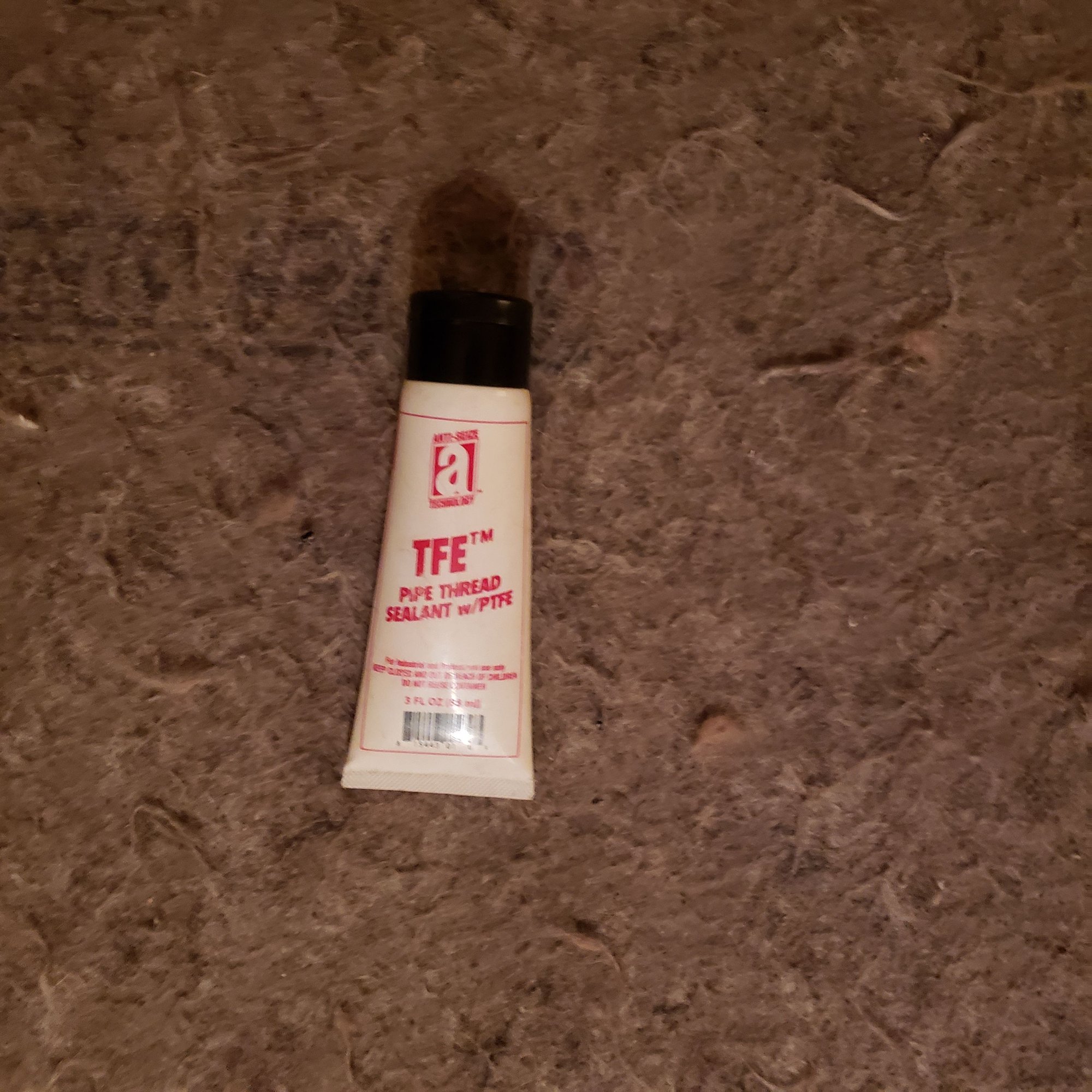

Do not use the glue on the bolts
That adhesive on the gaskets + thread sealer on the bolts
You would have hell to pay if you used that adhesive on the bolts
This is the thread sealer I use on the bolts

I can’t get a photo of the other stuff because I have stuff piled in front of the drawer it’s in.
Old Apr 3, 2023 | 09:16 PM
Anonymous12's Avatar
Anonymous12
Joined: Jan 2023
Posts: 1,172
Likes: 114
ok, I didn’t mean to say it’s for the bolts if I did. I have anti seize for those. And i have some blue loctite I’ve been told to use for those. I’ll use the anti-seize on the timing cover part of the bolt and the loctite on the threads.
