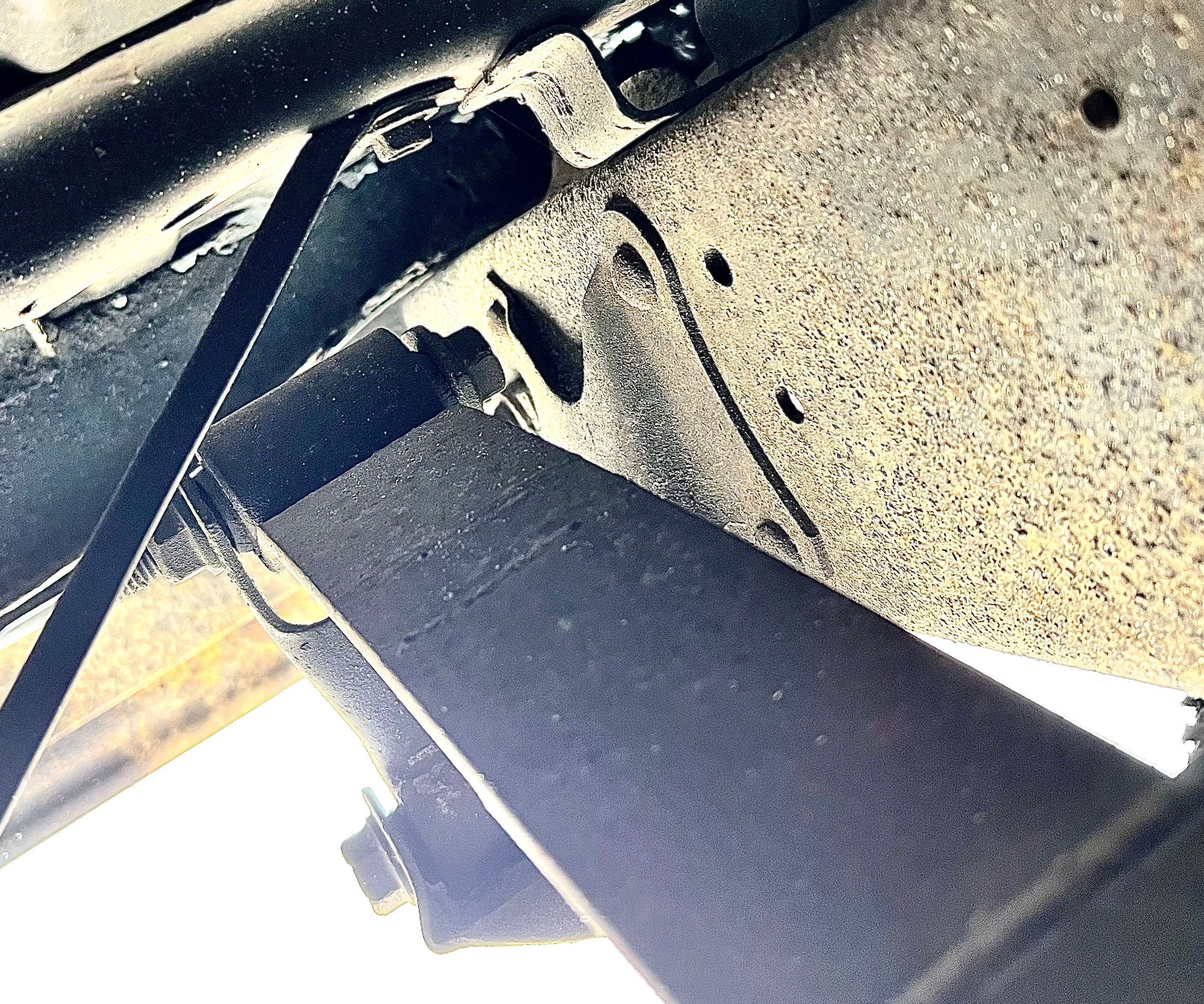

Before:
After:
Getting the rivets out of the hanger were the largest challenge. Ended up cutting the rivet heads off after cutting an X and trying to air chisel them failed to work. Then proceeded to hammer on them with an air hammer combined with a 3lb sledge and punch for what seemed like a total of about 6 hours spread across 2 days. Finally got them in and bolted up but the leaf springs no longer lined up with the holes. A combination of a jack under the axle and a bottle jack between the leaf spring and the frame straightened out the leaf spring enough to pull it into alignment with a stout screwdriver.
The fronts were fairly easy, just a lot of rusted bolts. The top of the shock complete broke off when unbolting it, which prompted a trip to Advance for a pair of Monroe Gas-Matic front shocks since they most matched the dimensions of the DJM drop shocks (and I needed them asap). They work pretty well so far. Other than that, I cut off 1.5 coils off of each of the front coils. I'm sure the new shocks are adding a bit to the ride height (maybe not). Overall not as drastic a drop as I was thinking, but when I upgrade the wheels/tires to a Torq II they'll likely tuck a little nicer.
