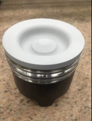

By a machine shop outside Atlanta. Ceramic top/Teflon skirt.

I forgot to mention that Swamps also ceramic coated my pistons so maybe that made up for lost volume? They did not share specifics with me so I am speculating at best.
