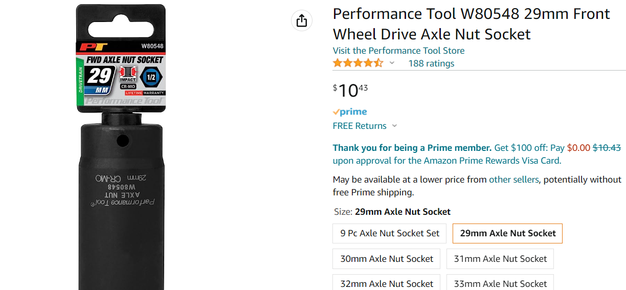

This was a trial-and-error adventure. I saw a post saying the NAPA 29mm axle nut socket fit. I must've gotten a different one because the one I got was too short as was all the other 29mm and 1-1/8 sockets my local napa had. The guy at the counter said all deep well sockets are going to be the same length when I asked to see another behind the counter. I gave up on NAPA and I saw a review for the one O'Reilly's had working for a 7.3L diesel. I assumed the IPR and bought it. I can confirm this one fits beautifully: Part # W80548.
If anyone reads this in the future, Bob's instructions for torquing the tin nut specifies in-lbs, not ft-lbs. I questioned it being higher than the ipr to hpop torque, being just a tin nut but dismissed all rationale with 'no, Bob would know.' Well, yes Bob does know... it was I who don't know - how to read. I finally came to my senses and reread his instructions before wrenching on, anticipating the click.

There is definitely a difference between an axle nut socket and a deep well socket. Unless a special IPR removal tool is built, made or bought, an axle nut socket in the appropriate size as Cousin Carl provided will work. I have a 3D printed IPR wrench that may or may not work, but I also have the same socket that was pictured above.
It is a bit cheaper on Amazoo for anyone interested in picking one up before it is needed.
