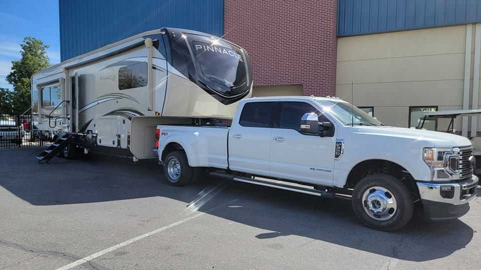

My first RV was a Open Range 28ft bumper pull. It was about 7K or so loaded. I pulled it with a 1500 Ram. It was fine on flat ground but it hunted for gears on mountain climbs etc. I got rid of the 1500 and got a Ram 2500. It was so much nicer towing with the 3/4 ton - I eventually for a 34 foot Grand Design reflection which was about 10K loaded. Still nice to pull with the 3/4 ton. I later went to a 3500 SRW and eventually went to a 3500 DRW when I started transporting for travel nurses etc. One thing I always say - its better to have more truck than not enough. I find that the problem is not always what the truck can pull, but payload capacity. I know a lot of guys who have 3/4 ton trucks pulling big toy haulers with heavy pin weights. They are literally maxed out on payload if not 500 lbs over etc...
My Jayco Pinnacle is 16K loaded with a pin weight of 3,200 lbs. For a 3/4 ton truck that is generally over payload capacity, at least on Rams - not sure about the F250 - I am not as familiar with their weight ratings.
Ford says my payload max is 5,254lbs and max tow of 32,500. They also list a max tounge load for a 5th wheel hitch as 4,875 lbs - I am guessing that total pin weight?
I prefer a DRW over a SRW for towing any day - less sway and just a better tow all the way around. On my Reflection I stopped using the sway bar on the WDH with the dually altogether.
The Pinnacle we just got pulls really nice with the F350 - I am really glad I gave Ford a try. That's hard to say having been a RAM guy for 20+ years!
