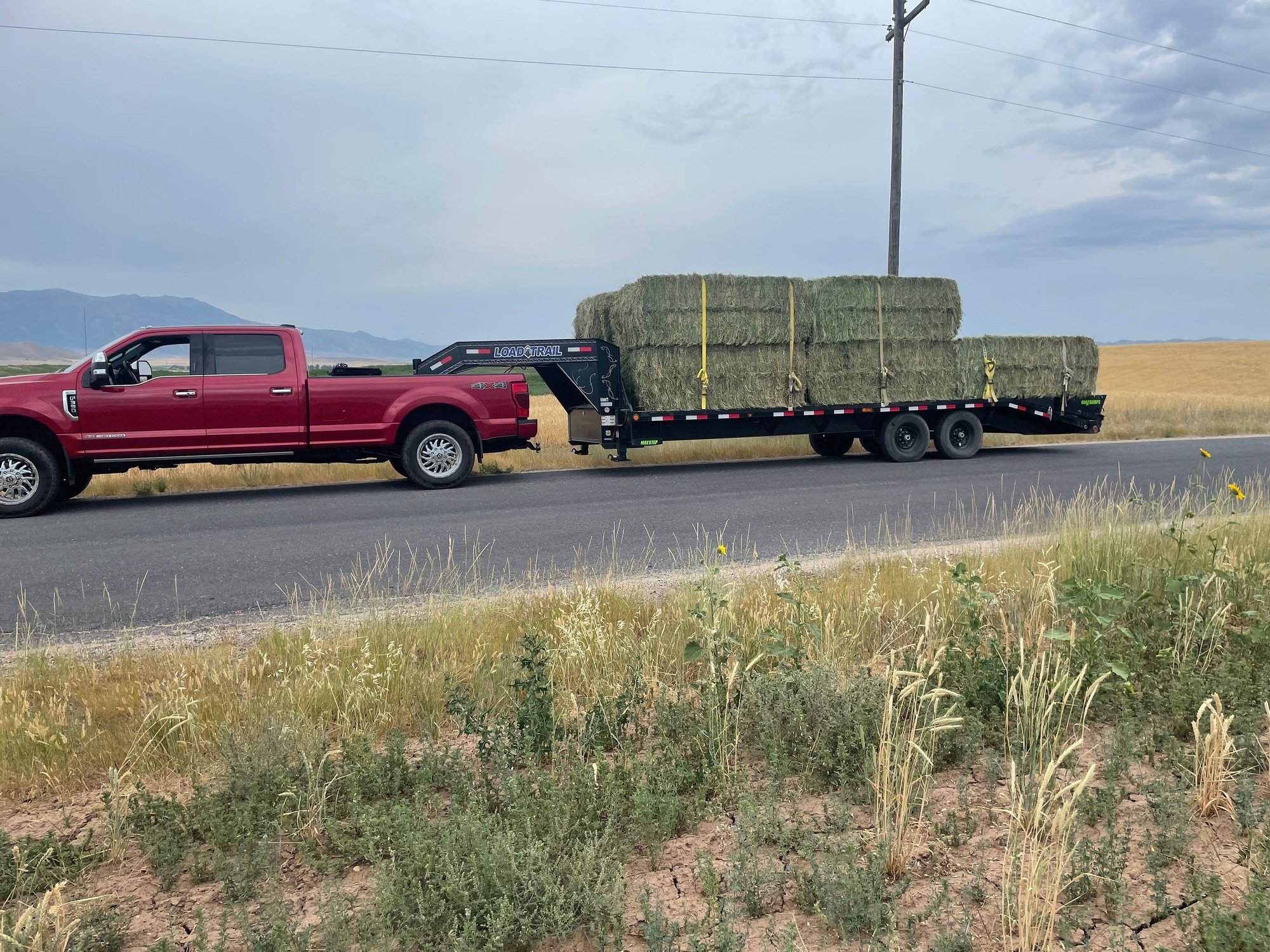

And hauling hay on the GN I'm 26,740 lbs but only 6160lbs the Rear axle With this load I was more worried about the trailer tire rating, This load had 15,300 lbs on the trailer axles. And the farmer was say, Hey we can put three more bales on the rear.

That would help. Problem is I borrow this trailer when I need a load of hay and it's not mine to change. Owner just hauls a couple SXS on it. He is a trailer dealer and swaps out his demo trailers almost yearly, So no incentive to pull tires and replace
Beggars can't be fussy. I just live with in the limits

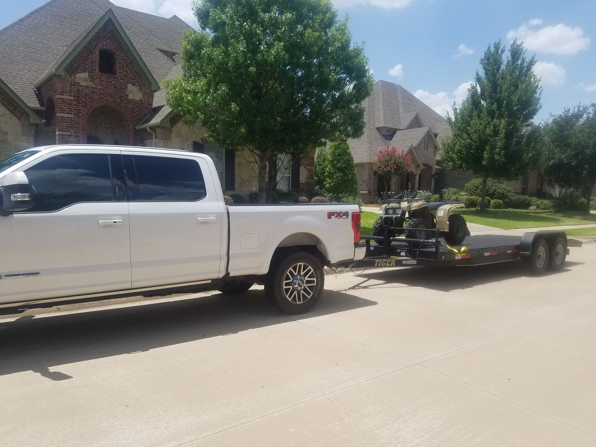

My current set up and a couple of sketchy times from the past:
