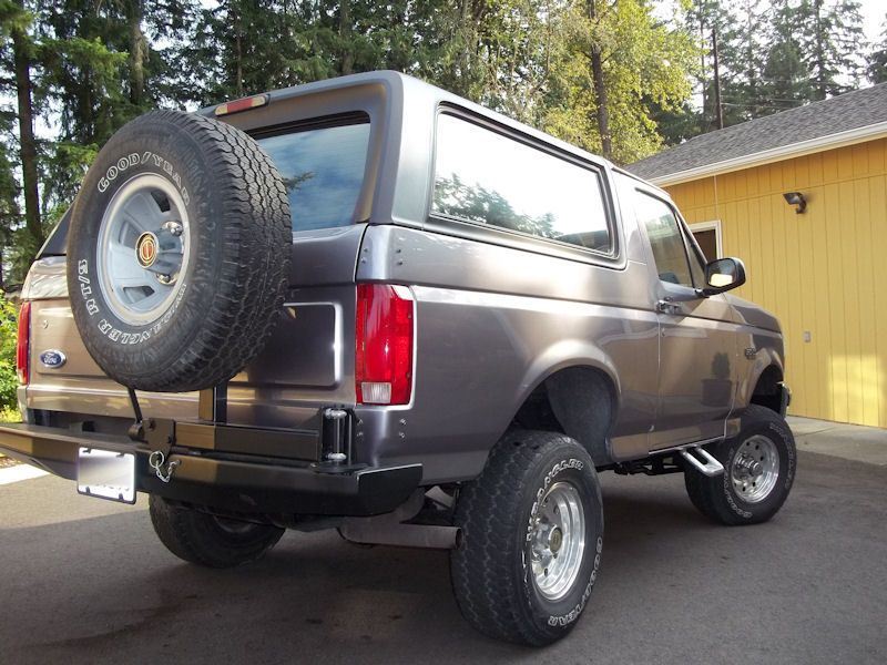

he bumper is a ProtoFab Rocksolid rear bumper.
I think I bought it in 2017.
https://protofab4x4.com/product/1980...k-rear-bumper/
The Bronco is once again away from the house today but here is a pic just days after I got it home from the new paint job
They can be used on trucks too with some modifications to the mounting brackets
As I understand it if your tailgate has the OEM aluminum trim (as my original gate did) the trim may come in contact with a part of the bumper.

Thanks for the bumper pics. I really like it!

They sell em without the racks too. A bare bumper is $755 F.O.B. Arizona
They have 10% off going thru end of March.
Probably 60 day back order though
