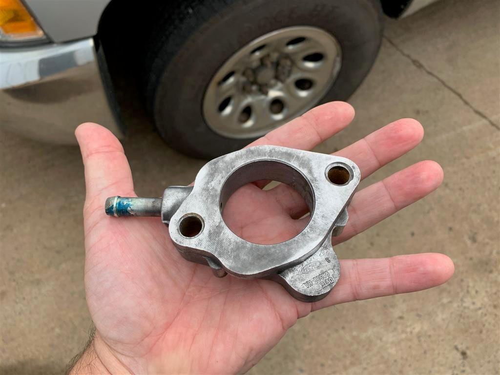

The Non-EGR 4.9 trucks came with a spacer instead of the EGR valve assembly. They were really common on Canadian trucks as our emission laws were much weaker than the US at the time. Here's what the factory spacer looked like on the '86 4.9 that I installed in my old 1980. It had a little ear, or tab, at the front to cover the EGR hole. I think they're kind of hard to find these days though.
There used to be block-off plates available for the factory EGR valve. I see Stinger still has them available. That's probably the quickest and easiest solution.

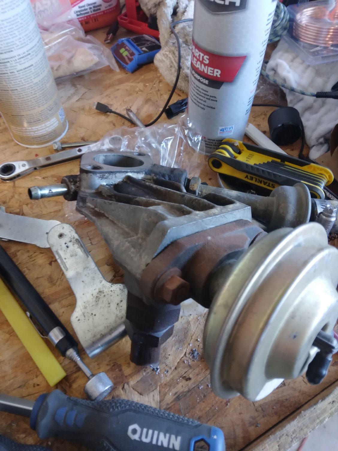

I wish l could have found one of those... "kind of hard to find" is an understement.
Not quite understanding the system, l just started hacking my EGR setup apart to make a carb spacer...
Still in tact.
Carb pad you're left with. That little hole out front is going to cause me some trouble...
First cut(s). Ain't no going back now.
Shaped with a grinder. The big hole got filled with high-temp epoxy and JB Weld. I painted it black because, well... l had some black paint and a thing that wasn't painted black yet. No choice, really.
This is where l ended up.
The little (.597", IIRC) exhaust port has a steel slug (actually, a punch-out from a gang box when l did some electrical work around the house) epoxy-d' over the top... it failed pretty quickly.
Now it has a "basket" of stainless steel mesh stuffed into it and filled with more of the hi-temp JB Weld and it's holding together. When l have the intake off, I'll have it tapped for a pipe plug... l just don't have a tap that big.
Was it worth the extra hassle over just buying a blockoff plate for the EGR? Not really. It's cleaner and looks better, but that little high-riding 1bbl still looks kinda silly w the air cleaner off. No matter, it's done now and there ain't no turning back.

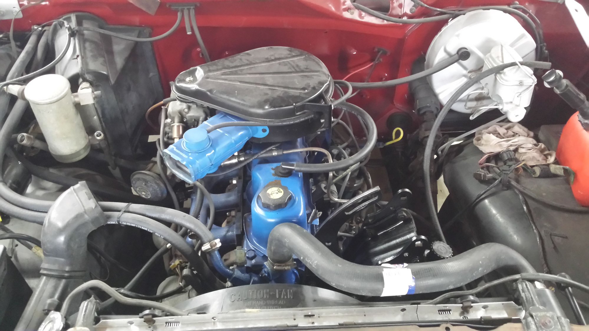

Rebuilt engine and no EGR tube
So I just put in my rebuilt 300 6 in my 1980 F100. There are no emissions left on the motor. When I pulled the engine apart I removed and plugged the EGR tube from the exhaust manifold to the EGR plate. The engine runs great except at idle. The engine shakes like crazy to the point if you drive in 3rd at 1000 rpm the truck bucks.
It could be my rebuilt carb I put on in July is already shot. Or my question is could the truck need the pressure from the Manifold to the EGR plate to even out the carb? the truck has no computer it’s bare bones. I replaced everything in the ignition system with stock parts.
