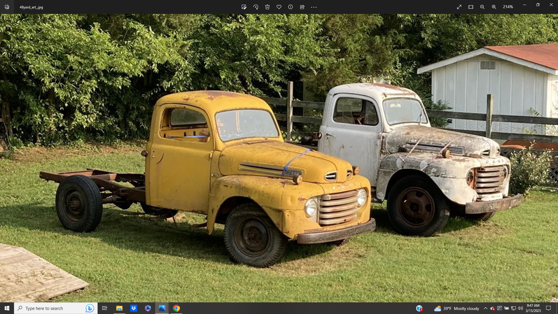

Alrighty, I clicked on the links in the post and it will take you to the photo.
So, in the meantime, the pic of the trucks on the trailer was taken somewhere in Illinois on the way from ND to Tennessee.
I thought it was SO COOL to be seen hauling MY trucks to Tennessee. (I know... I'm a 74 y.o. boy child.)
I call the second pic "Yard Art" as my wife loves art.
So, I blessed her with some art. (I'm so good to her.)
She was, indeed, SO BLESSED that she wasn't able to utter a word for a day and a half.
Wasn't that WONDERFUL ?!?!

Your yellow truck appears to be F5 cab and sheet metal (or, the emblems, at least) installed on an F2/3 chassis. The argent grille and lack of stainless trim suggests it may be 49/50. It could be a hodge-podge of parts from many sources to build a truck. Only more forensic investigation will tell. The frame is considerably shorter and lighter duty than the white truck. It also has the Dana floating axle and 8 lug hubs. The frame could be from any 48-52 F2/3 truck. The stamped chassis number will tell the tale, if you can find it.
Early 48's had the serial number stamped on the left side, as that's how Ford's earlier vehicles were done. Sometime during 48 model year it got moved to the right front as seen in the pic above.

Good eye Wayne. Only thing I'd question is the cowl/firewall tag doesn't get changed very often with a cab switch. Although if the firewall is red, it's possible the cab and front end are from different trucks - making it a real mix of pieces... Interesting puzzle!
"The other truck looks to be chrome yellow though the firewall is red (go figure). I call that "the yellow truck." I think you'll understand why in a moment. The yellow truck is the subject of my original post in this thread. As mentioned originally, the cowl tag number on that one is *88RT**62355* "

Yes, that's why I said it could be a hodge-podge of parts to build a truck. The F5 emblems and the 88RT tag suggests the cab was from a '48 larger truck, the front sheet metal could have come from the same truck, or be original to the F2/3 chassis with a replacement cab, or all the parts could be a conglomeration...so many questions and theories... This is the fun part of the hobby for me, the forensic investigation. I'd really like to know the number on the yellow truck chassis.

Ask and ye shall receive, Wayne. Found the S/N on the RH side of the frame next to the motor mount as was suggested earlier. Also found, on the RH motor mount member, another "21C" which I'll bet is one digit removed from the LH one.
Okay.. now for the big S/N reveal: *88RY62355*
Well, this just gets more interestinger and interestinger. Are the frame and cab a pair or are they brothers from a different mother who JUST HAPPEN to have the same sequence number?
