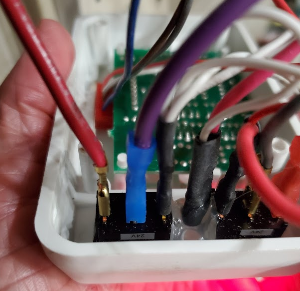

I was in the middle of a shower today and my water pump system stopped pumping. The water pump is a REMCO that is a couple years old. It's a few more gallons per minute than the prior pump which may or may not have been the OEM pump. The REMCO works good, when it's pumping. I've had an issue before where the system stopped in the middle of a shower. The last time, it was a fuse that had blown. I've experienced some odd behaviour the past few days with the water pump system. I turn on the switch and it doesn't do anything. Then other times I turn on the switch, get no light on the switch, but the pump runs. It's in that state right now.
The REMCO 55 AquaJet-ARV water pump is rated for 10 amps max and the fuse is also 10 amps. That's cutting it close so I can see blowing the fuse. Both times I had issues with the shower has been when I shut off the water flow at the shower head. I don't know if that matters, but it's consistent.
This time when I was in the middle of a shower , there was no red trouble light next to the fuse. I pulled the fuse and checked it with my meter and it had continuity. It looked fine also. Just in case, I replaced the fuse. It started working, but the switch isn't lighted like it should be. This seems like a simple issue with the switch. But usually a switch either works or it doesn't, right?
The only spec I can find on the switch is that it has a label that says 24v. Maybe the switch can't handle the higher amps of a 12v system? The water heater and water pump switches are the same. If the water pump system fails again on this trip I'll try swapping the two switches and see what happens. It's back to working for now, so any testing that I did with the switch wouldn't tell me anything. Other than the light isn't working.

In attempt to finish my shower, I pulled two of the leads off the switch and bought them into contact. I got nothing. No pump action. The two on the left are the ones I pulled. I'm pretty sure they made contact, but I didn't use a wire to jumper them. I was in a hurry.
While troubleshooting, I did check the wires near the pump. No loose connections. There is an inline fuse near the pump, which checked out OK also.

I'm still leaning towards the switch as the problem. If the pump itself was dead, the lighted switch would still light up. At one point, the switch light was no illuminating when the pump was operating. Then another time, the light was off and the pump was not operating at all.

I pulled the switch. Kind of a PITA since the factory put a bunch of glue next to it to hold an indicator light in the panel. The old switch is the same as I posted a link to except that the new switch is LED. I ordered two and I'll replace the water pump and water heater switches.
