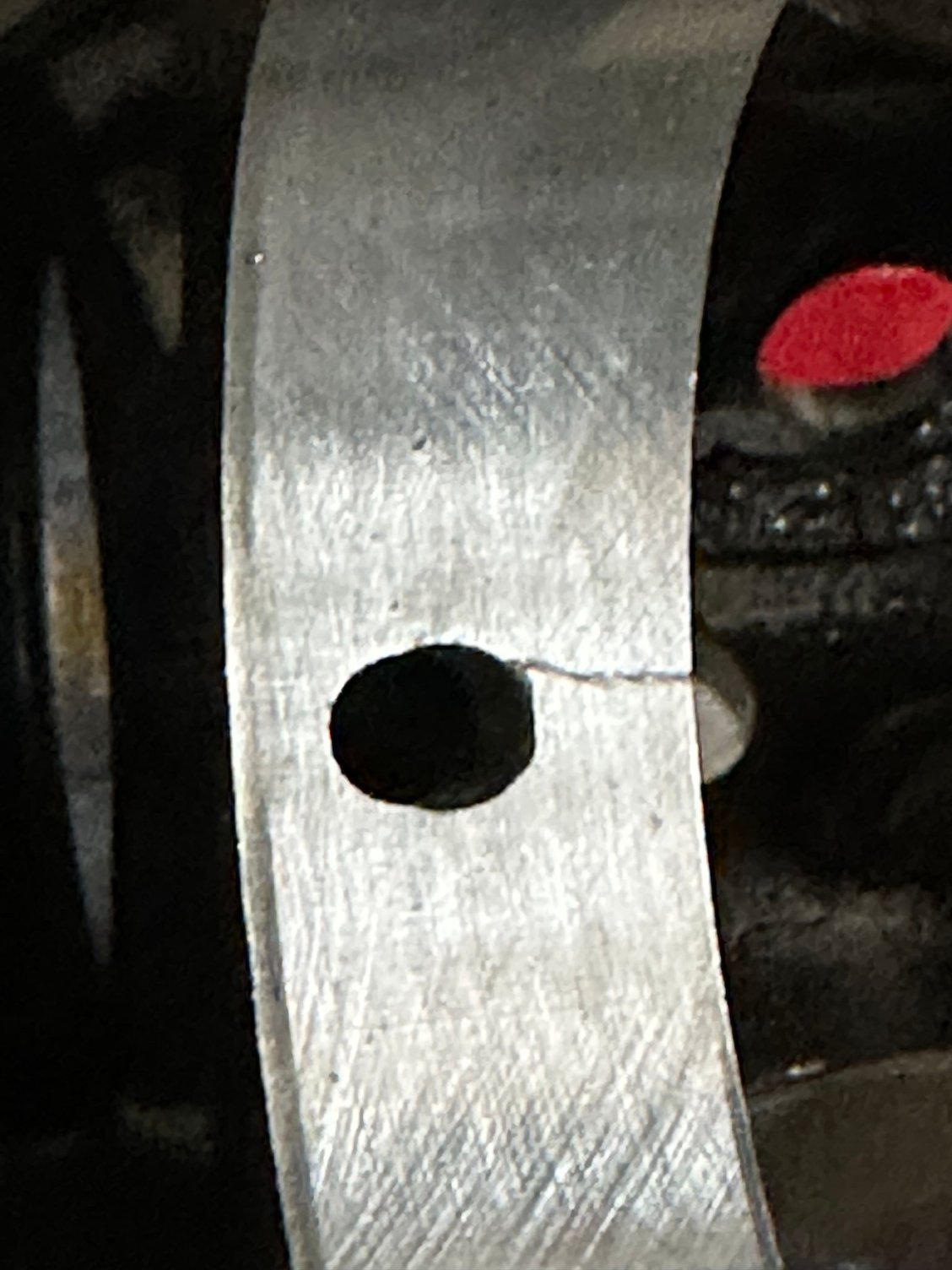

I think I found the source of my low pressure at running temp. I feel pretty confident that this crack was not there at rebuild. Makes me ill.

Usually cracked main webbing will give a really erratic oil pressure that isn't necessarily low all the time but tends to jump around in a weird way. With that said. Cracks from the main up to the cam hole are pretty common on FE blocks that have been run hard in the past. I've found a crack like that in a customer's 427 block.

The bearing must have truly been starved because some of the rod and main bearings had major wear/damage which likely contributed to the low pressure. Super disheartening.
