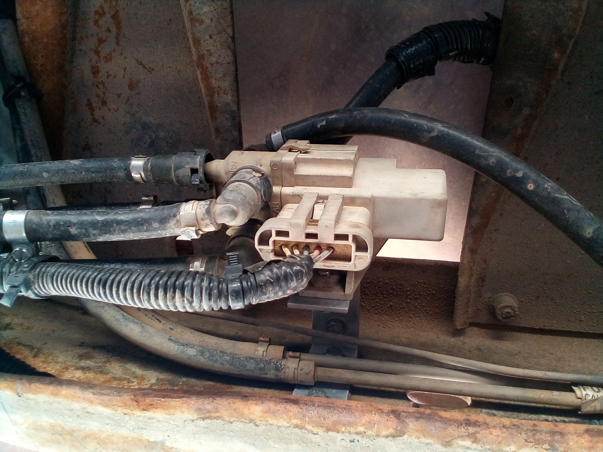

My Marty's kit had been going strong for almost two years now, mine has the walbro pump, and is claimed to be good for up to 205cc injectors. I bought an extra pump just in case, and did the Spectre rear tank as well, and cut access holes over the two tanks. I dont know about fuel starvation issues with the walbro, but I do know it filled both of the huge filters in a couple of seconds. I had intended to prefill the filters before running the pump, but forgot. I also made a new bracket for my selector valve and moved it forward so it can be easily replaced.

Looks good, it came with a gauge under the hood and you wired one in ur cab?

I wired it in, the fuel pressure regulator in Marty's kit comes with a mechanical gauge for setting the correct fuel pressure. You would normally remove after setting pressure that and replace with a plug that also comes with the kit. I replaced it with an electronic pressure sensor instead, going to a glowshift gauge in the cab.
