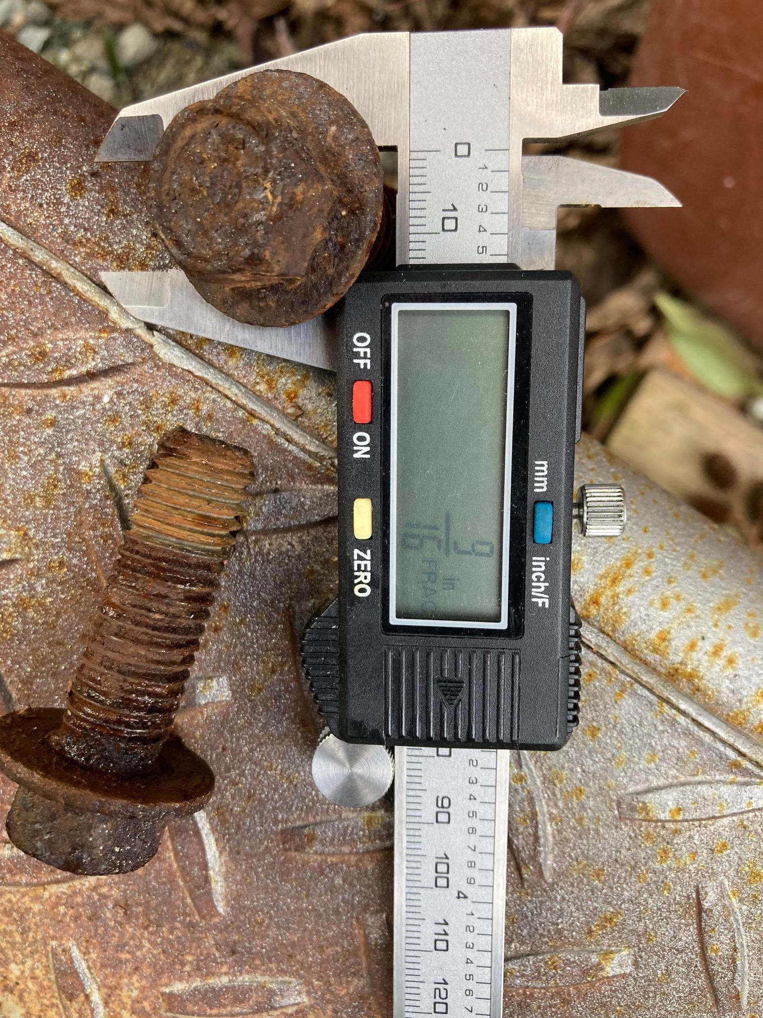

Does anyone know the size and thread count on the rear bumper (the one's where the nut is inside the frame). I have tried the search, but can't seem to find this information

Nobody can say for sure, at least half the rear bumpers were added by the dealer and it depends on what it is.
Most use 1/2" bolts but I have seen 9/16" used. both fine and coarse thread are possible as well.

9/16 course thread bolts are what were used on my 78 F350.

Wanted to close this out, the bolts are 9/16*12tpi.
In case someone else is looking for them.
I can't see ford changing them a lot as these nuts are welded to the inside of the frame. And changes cost money.
the 79 f250 i am working on are the same.
my search skills suck on this forum
