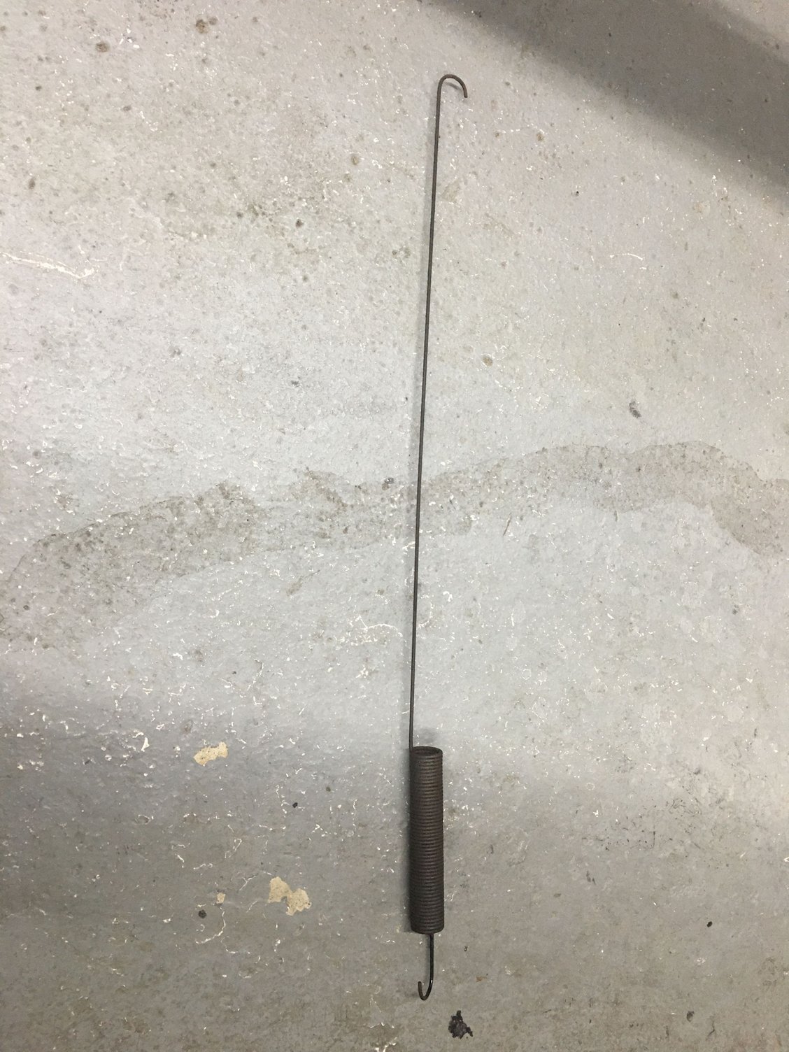

Unidentified spring
No matter how many pictures you take during a restoration, there’s always one you should have taken but didn’t. Sigh.
For the life of me I cannot remember what this incredibly long spring does and I don’t have a picture
of it. 23.5” hook end to hook end. Ebrake maybe? I’m at a loss. Anyone have a clue?

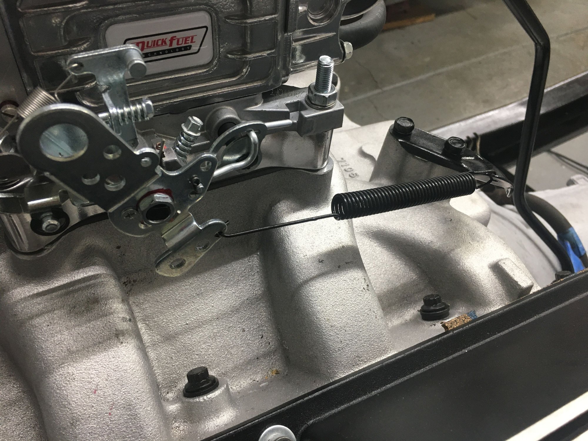

It was in the box I labeled “engine” (possibly by mistake) so I was thinking an abnormally long throttle return spring, but the darn thing is longer than the intake manifold, and this is the way that I set up the return spring (much shorter) based on the pictures I had of the stock setup.

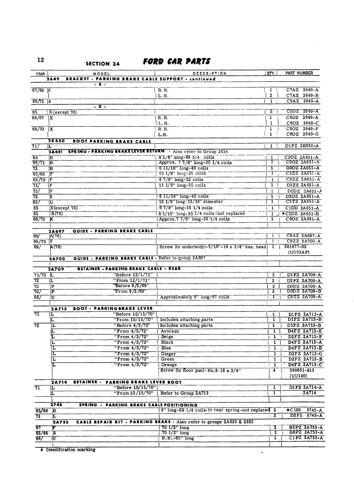

3rd on park brake spring, unless you want the carb linkage to hook to the rear bumper. #2A651

Y’all are the best. Thanks so much. I thought it was parking brake related and had been foolishly tossed in the engine bin, but couldn’t figure out exactly where it went until the pics and diagrams were posted.

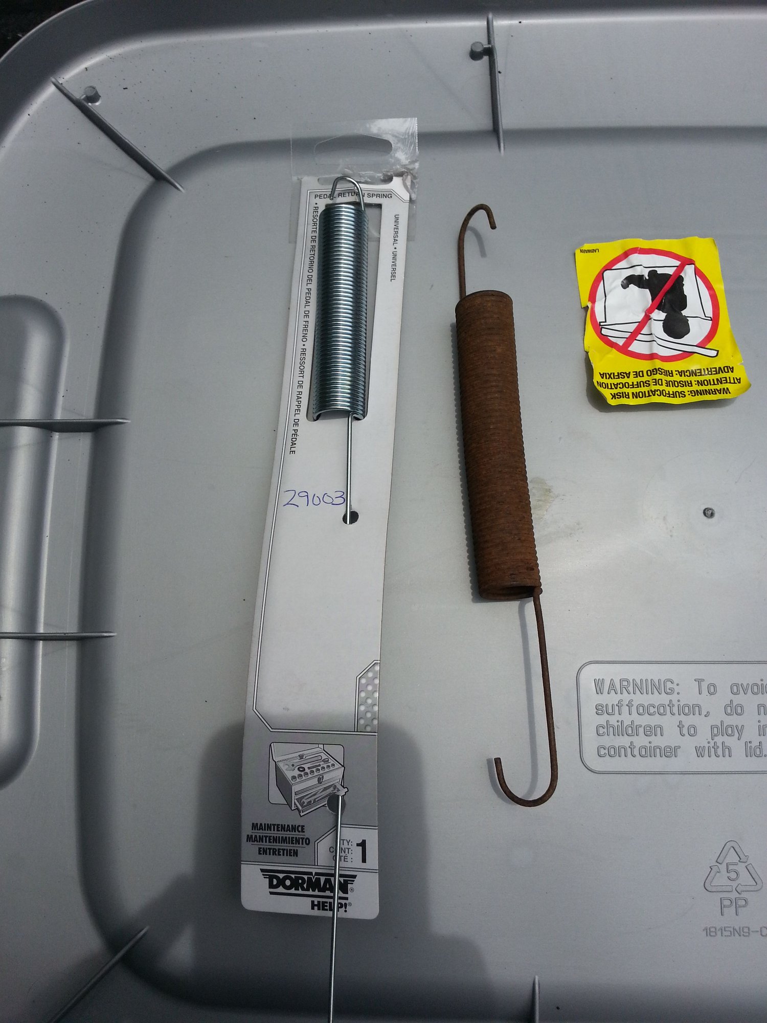

This is what I used for my parking brake spring. Dorman Help makes a generic replacement spring (#29003) that can be bent and cut to fit if yours needs replacing. Autozone usually has them in stock whereas Orielly usually has to order them.

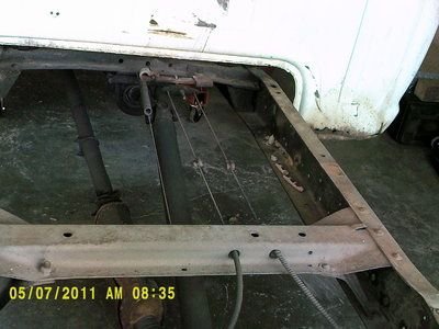

After a lot of digging this morning, I found the following thread that shows great images of the parking brake cables from a 73 long bed. Of course, the venerable Rich chimed in with some great information. Mike has a great pic as well.
https://www.ford-trucks.com/forums/1...ke-detail.html
It seems like there are two different setups. Mine uses the version that Rich has where there isn't an equalizer bar bolted to the cross member. Hopefully this helps someone in the future because the diagrams in the service manual or parts catalogs can make you think you either lost parts or lost your mind if you don't have the bar that bolts to the cross member.
