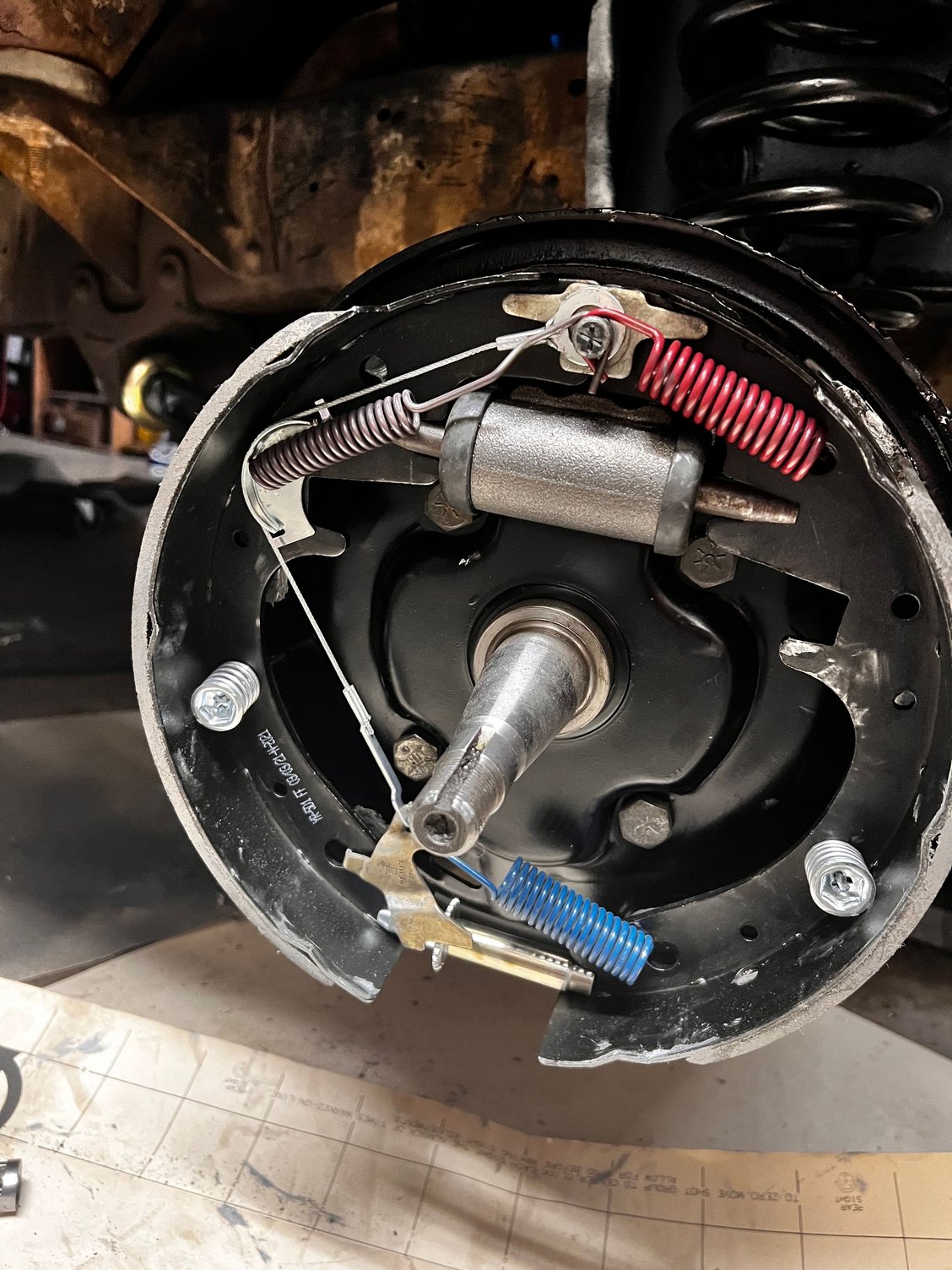

Here’s what it looks like when hub is removed and shoes.
Wheel bearings are housed in the hub.
I looked in my phone to see what pictures I have of the disassembly. They’re on my old phone but also on my build post if you pull that up and scroll way down.
take your cotter pin out and the castle nut and washer. Then pull your hub off it should be caked full of grease. If you find parts of bearings you need to clean all the grease out and remove old bearings and replace them. While that’s off check for play in your king pin by grabbing the sounding and moving up and down, if you can wiggle it you need to replace your king pins like I had to. I could wiggle them like 1/4 of an inch

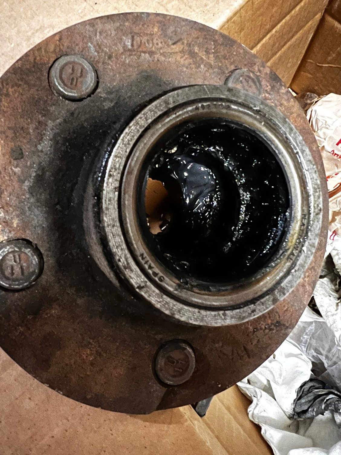

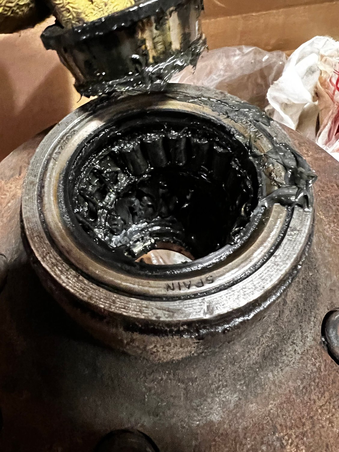

Thank-you for your help !!! I may post a photo of the cone I have referenced . I still want to know if the hub comes off with the drum
When I removed the dust cap there is an enormous amount of grease covering the spindle is why I did not go any further !!! Did not want to attack that mess unless I need to ......I knew the bearing would come out and make a bigger mess........The cast iron cone looking part attached to the hub is also very confusing .....It looks to be separate from the hub , but fits very tightly and sturdy against the hub
