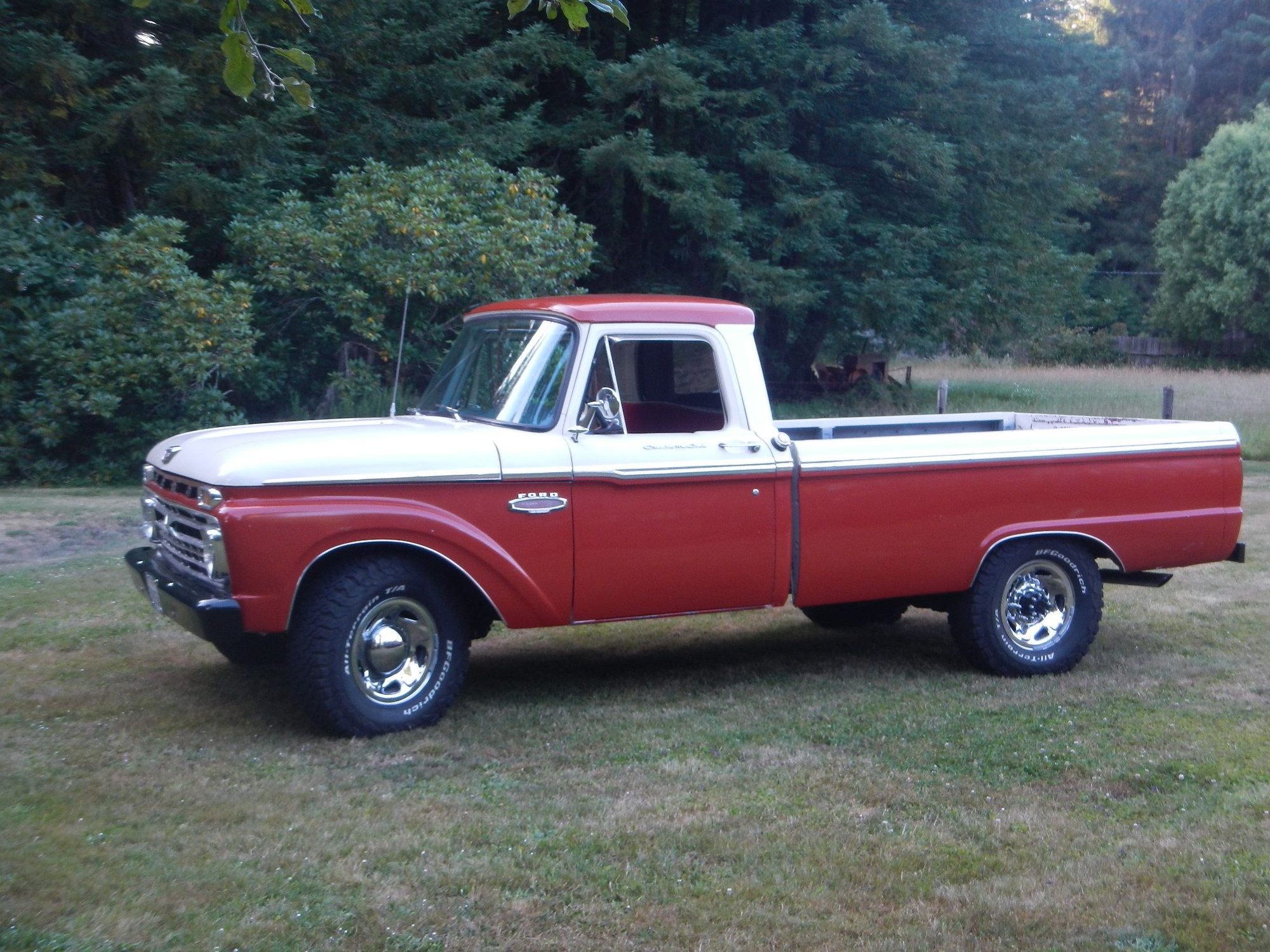

Running BFG AT 265x75 16 E-rated. Put them on in 2015. Dodge 16x7 wheels. I drive 5 days a week about 100-200mi and they are about half way down. Never had a problem and don't even carry a spare. I went with a taller tire to offset the 410 gears which allows it to cruise 65-70mph @ 3000rpms.
That's a beautiful truck Christmas.
I went with the tallest 15 I could get to fit my stock wheels with 3.70 gears and overdrive @3000 rpm I'm somewhere over 90 and I can take both hands off the wheel.

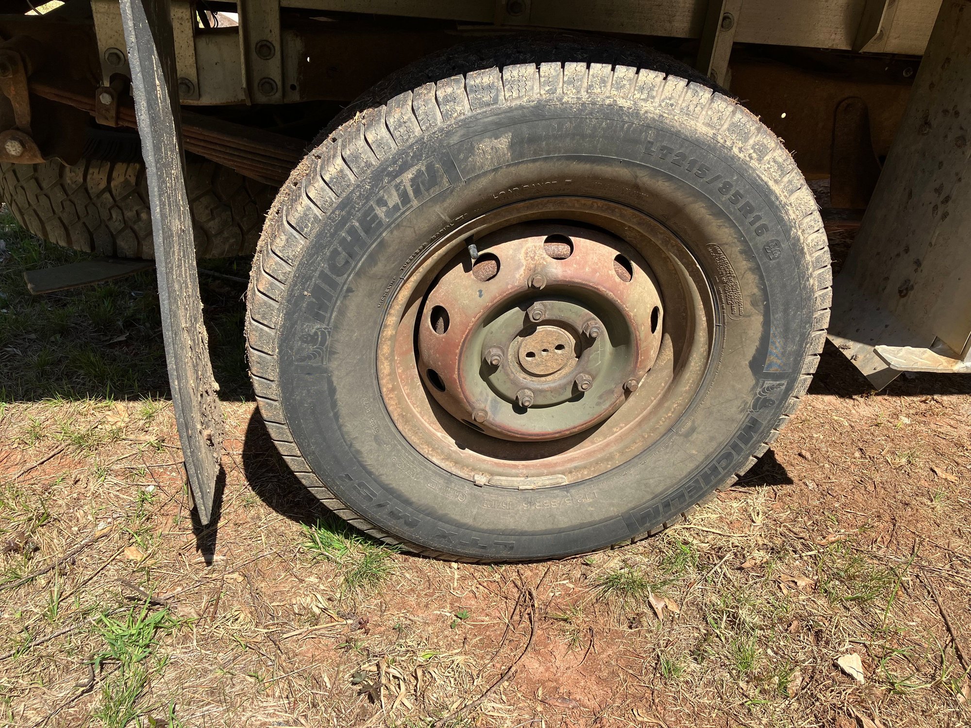

Hey mmthskibum,
I run 16" Michelin radial tires & radial inner tubes on my '65 2WD F100. Tire size...LT215/85R16. I have a 300 with a HD4 speed & 3.70 r&p. Runs smooth as silk.
These tires will be 10 yrs old in June. When I am not using my truck I put plywood over the tires to slow down dry rot from the sun. Seems to be working. Not one crack in the side walls. Still lots of tread. I also rotate them every other oil change.
All the best, Pete

tire pics
Hi,
Sorry to take so long with pics. Here they are. As you can see my truck is my portable fab shop. The "box" behind the cab keeps the Miller eng. generator welder out of the weather. The diesel tank is to fill up my mini-hoe. That comes off when welding takes place. My truck weighs in @ 5,300 #'s...or 300# past the 5,000 GVW. Had a 300 put in two weeks ago. Way stronger than the trusty 240. It got me around for 31 yrs...169,000 miles. I live in a county that wanted to tax me $600.00 per year for the county vehicle tax. They thought my truck was all perty n stuff. Naw, the appearance does not affect performance. The little bldg behind is where my hoe will be stored. 62 miles one way. 42 miles Interstate...20 miles two lane. A great cruise round trip. Need to say...I check tire pressure once a month, whether I want to or not. (spare too).All the best, Pete
