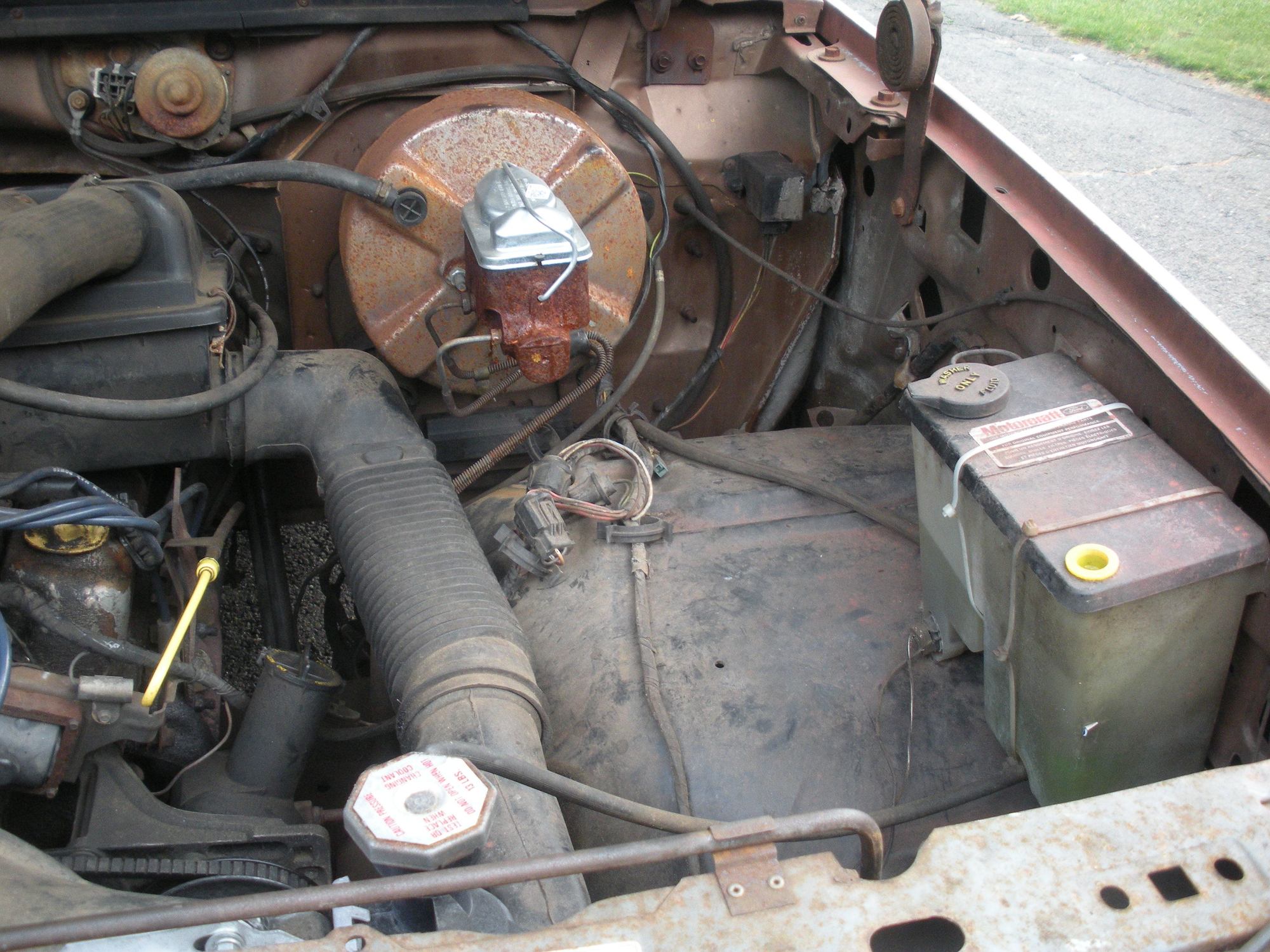

My '83 F-150 has a trailer brake control. The hydraulic line to it from the master cylinder was cracked by the PO's mechanic when installing a new carb and manifold. This hydraulic line was 'T'd off the front brake line coming from the master cylinder. I broke the line off getting the fitting out of the 'T'. I tried to re-connect the front brake like to the port where the brass T fitting was, but I couldn't get that fitting started. So, I took the broken off fitting, and the brass "T" to the local O'Reilly's to see if I could get a plug for the brass "T". I got a plug, and had to get a thread adapter to get it to screw into the "T".
The problem is the plug is a loose fit in the adapter. I don't think anti-seize will take up the slack.
Is there a plug available in the thread size of the smaller flared fitting? I am an amature machinist and have a lathe and mill. If necessary, I could make a brass plug. What would you do?
took a picture to clarify...

I am guessing the ports in the Tee are for flare fittings like a metal brake line.
The plug you need also needs to be for a flare to fit into the port.
None of the brake lines use NPT as that sounds like what the plug you got that fits loose is and is bottoming out on the flare part of the Tee.
It is the flare that seals not the threads.
They do make flare plugs but might be hard to come by now days.
Also make sure it is for SAE flares and not metric flares as they are different.

Here's the plug you need. I am guessing from the pictures the lines you are working with are 3/16 brake lines. This plug is for 3/16 brake lines that have 3/8-24 threads. If you want to double check this, get a regular fine thread 3/8-24 bolt and see if it threads into where you want the plug. That is the reason why you are having problems with it fitting and sealing, those brake line threads are regular straight machine threads, the seal is the cone in the middle. It doesn't show it in the picture, but this plug should have a concave cone in the middle to seal against the convex cone in your tee fitting.
You said you are a amateur machinist. Are you getting the jist of it? Pipe threads are tapered and seal with the threads and thread tape. Brake line fittings are straight thread and no thread tape is required, they seal with the tapered cone in the middle of the fitting.

Why don't you take a picture of what you have going on. I thought you were going to keep the Tee and get a plug? Someone's suggestion of a coupler would be a possibility? If the line is the same going in the tee and going out, a coupler should work. Then you would not have to mess with the weird fitting going into the master cylinder. They have couplers with the cones made in them on each side of the coupler. Just make sure you get the right thing, as you found out you can't trust the kids at the parts stores.
If the fitting is the same on each side of the tee, then take the tee to the store and buy a coupler the same size. There are many ways to repair this, since you do not have any tools to do it you want the path of least resistance.

I did take a picture after the fact and added it to the first post in this thread.

Is the brake line going to the front brakes the same size as the Tee going into the master front port?
If so you already have the Tee out just screw the line into the master.
This way you dont have to deal with the Tee, adapter or plug.
If you really need to move the truck put the Tee back in place and where that broken line went get a short piece of line cut 1 end off and fold the other over 2 or 3 times and compress it as tight as you can to seal it. You should be able to move the truck and have a little pedal.

Looks like he has a short piece of flair tube in the picture, so use pliers and crimp the very end, then fill the tube with JB weld and stick in the tee. Let it cure a bit before installing.
