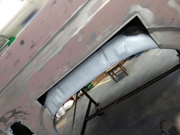

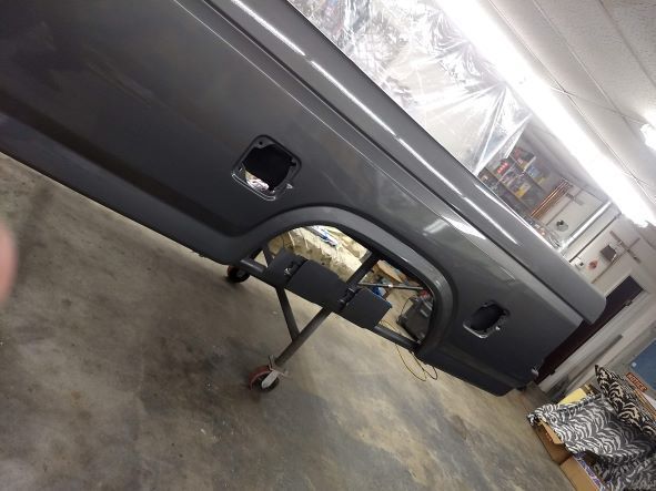

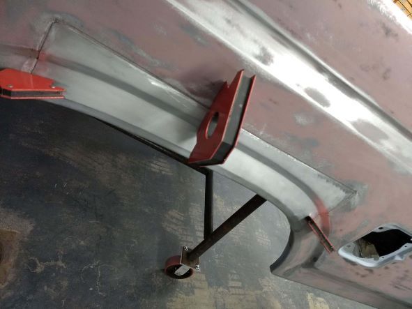

Originally Posted by diggerrigger
In newer cars and trucks, body metal is getting really thin and/or aluminum. Makes welding panels much more difficult. Body shops are switching to adhesives. My paint guru who owns a local paint supply house talked me into using adhesive on my truck's rusted out wheel arches. First attempt and so far couldn't be happier with the results.
I have a couple questions on your wheel arch replacement. Are the tops of the wheel arches squared off on all the styleside beds? So the replacement wheel arch is square topped to fit in?
What kind of fasteners did you use to secure the wheel arch into place? Looks like some kind of pop rivet or...?
I believe all styleside bed and front wheel openings are square top 1980-86. The replacement panels from Tabco match. I used only a portion of the panels.
The fasteners are Clecos. Made for this work. My paint guru loaned them to me. When adhesive has set you pull the Clecos and clean them in thinner. The holes are filled with fiberglass resin as bondo would absorb moisture.

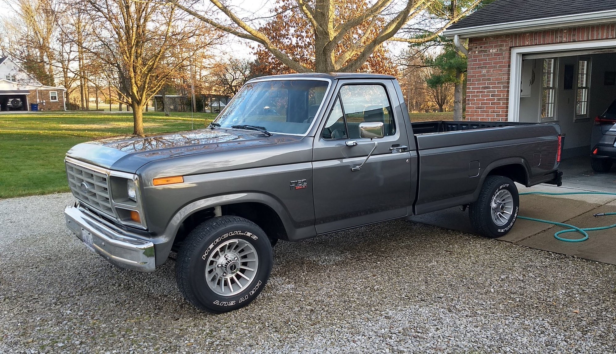

Originally Posted by Moore31
What color is that?
It's a common modern color. Ford CX gray. But seems every manufacturer these days has the same color. I think my wife's '19 Lexus is the same color.

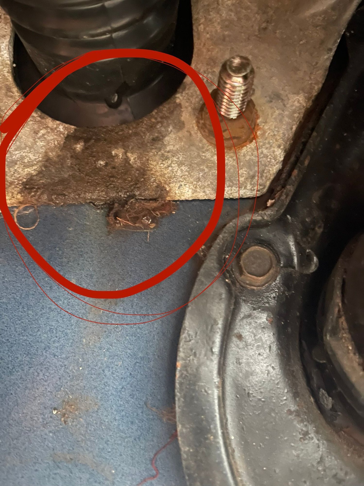

Well I got some 3M seam sealer, finished cleaning the cowl out, painted, than used 3M seam sealer. Seems to have sealed it up good. After some rain we got last night I noticed a small spot but idk if it was from the cowl being off still and the hood weather stripping to.
Back glass still leaking… unfortunately silicone didn’t help that.
But on the passenger side by the panel it has a small leak and on the drivers side to.
This might have been due to the cowl being off and no good weather stripping on. Because I’ve checked the cowl and it hasn’t leaked.
This I’m not sure, because of the panels being off when I check the cowl for leaks it splatters in them or runs through the screw holes
Sounds like the cowl trench is sealed but you have some leaks coming into the side kick panels. Remove the panels and dry everything out. Might have to cover or garage your truck? Or wait for a dry spell...
When dry apply water using a small spray bottle or squeeze bottle to the area between the cowl and fender. There is a seam between the window post and the cab. It's seam sealed but sometimes leaks there. I used seam sealer in that joint and it stopped the side leak.
There is a recent thread on rear window sealing. Title of the thread includes rear window. Should be close to the top of the threads.

Check the 3M Seam Sealer for holes. It shrinks up to about 1/2 its applied volume. It can pull itself apart if applied too thick. It is best used for seams like this.

Where is the leak coming out of on the front? After experimentation I found my Ranger only made the pass side carpet wet when that side was parked down hill compared to the driver's side. I pulled the carpet back, and while it was raining I found it was coming from the seam from the floor/toe panel and the vertical kickpanel area. After investigating, I found this area is pretty much impossible to get to without pulling the fender and cutting the cab open. It's the air chamber formed on each side of the cab.
I didn't know if it would hold, but I let it dry out and slathered roofing cement from the interior on the corner of the floor/kickpanel all the way up the angled portion where you put your feet. It actually held and didn't leak for years after that, I was surprised. Trying to stop a leak on the "other side" of the problem usually doesn't work very well.
