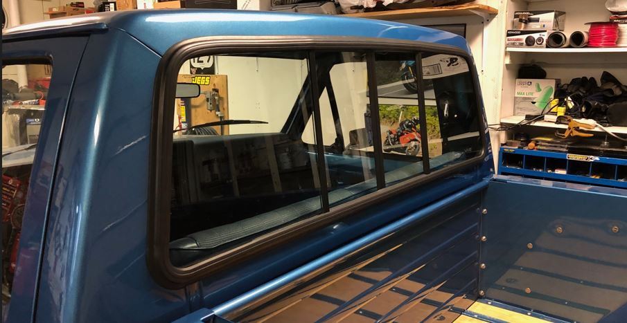

'Morning KraigJ- Im planning to upgrade to a slider. In my case, I am looking at an older slider and gasket (with the lock strip) unsure of the exact year but pre-90's for sure.
So does your picture show the Steele gasket or is it the 1996 Ford gasket that came with the window that you got at the junkyard? It looks to have the lock strip.
Do you remember if the sliding window frame is the same width as your solid glass frame?
Im thinking I might get the older slider and use my original gasket ( with no lock strip)

That is not a locking strip like used on the pre 80's trucks it is just a plastic chrome strip that most likely has gone looking bad.
My rear solid glass has the plastic chrome strip and I left it in the rubber before putting it on the glass and then in the truck.
Dave ----
Pawnee - Those are not my pics, they are from Rembrant's posting.
