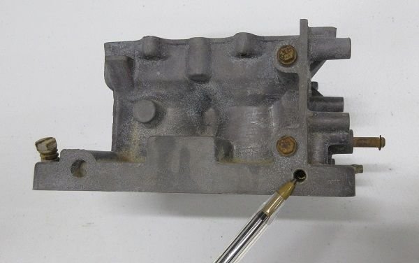

I'm rebuilding a Motorcraft 2150 from a 1976 302. I'm cleaning it for final assembly and I can't get any compressed air to go through this port. This is the port that the choke pull-off hooks to. It looks like there is a brass restrictor in it but no air will go through. How do you get the brass restrictor out?

Circled in Orange on this assembled unit.

Never knew there was one in there. Far as that goes have never removed the tube. If it's pressed in you may have to drill it out. Good luck.

I doubt that its designed to be removed as its pressed in from the factory. Is the restrictor plugged or is it the passage behind the restrictor? I would try another good soaking in carb cleaner to try and free up what ever gunk is in there then blast it with compressed air and/or maybe try a jet drill or piece of fine wire to poke in there and try to clear it out.

Ultra sonic cleaners seem to work on some carb circuits better than anything in the past.

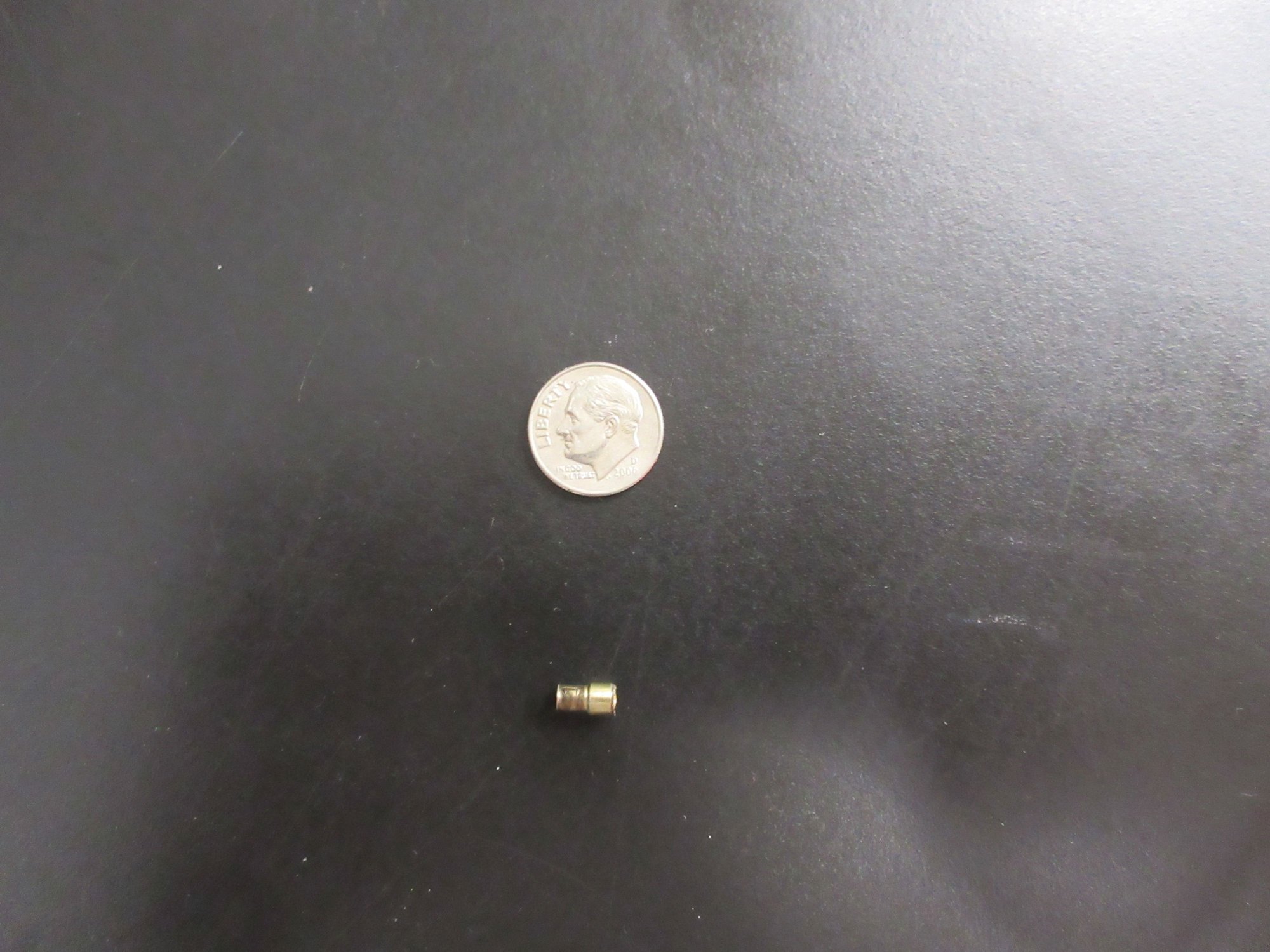

Update - I was able to get it out with my smallest spiral easy-out. Dime shown for scale. Using a magnifying glass I can see the numbers "1" and "8" stamped on it. But I still can't get any air through it and my smallest torch tip cleaner wire will not go it.
