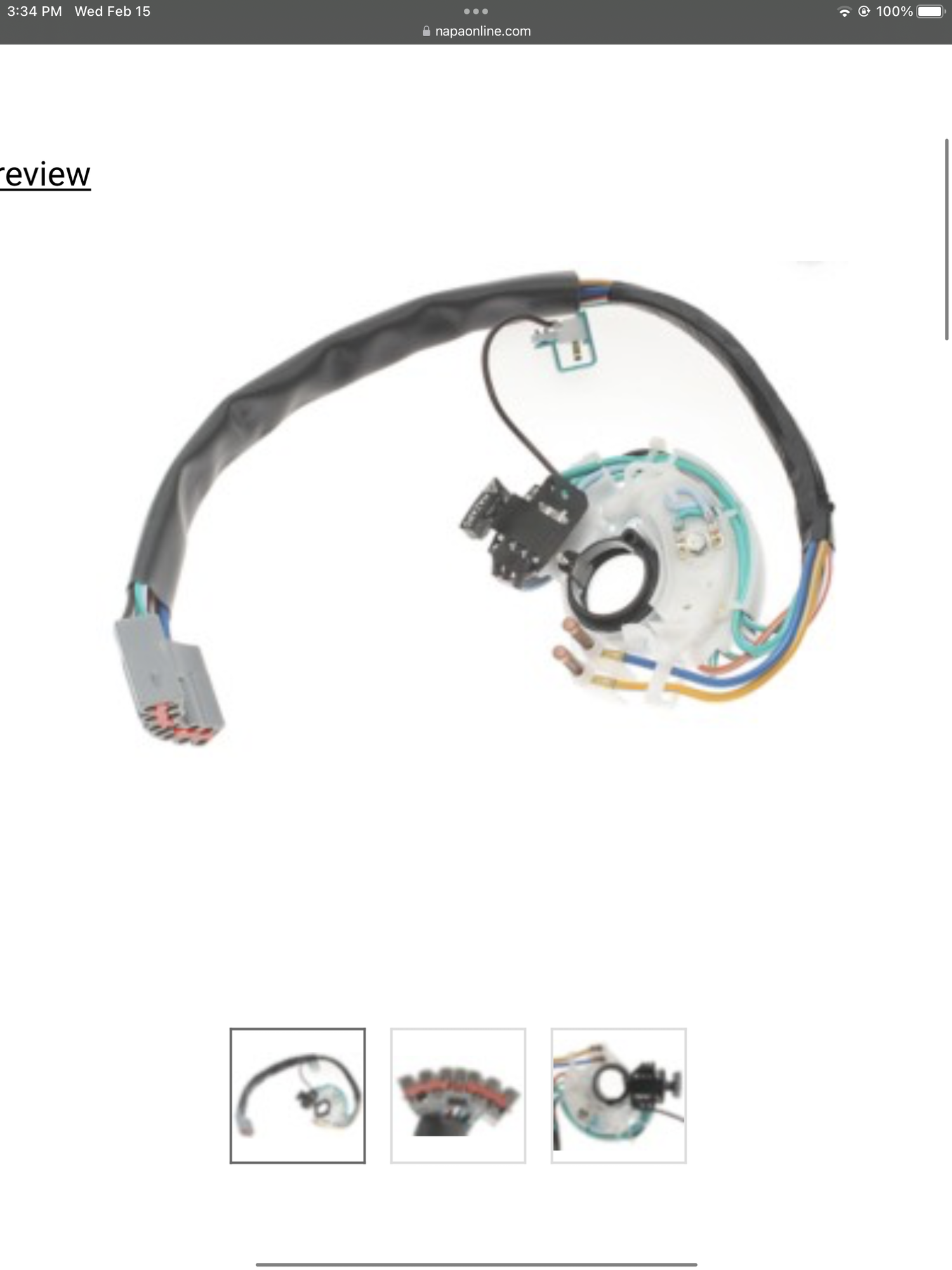

Here’s a picture of one with tilt. I’m sure this is the curved connector your talking about, it’s the same connector tilt and no tilts, but this part will look different for the no tilt.

Yea, sounds like a turn signal switch for sure. The hazard switch is part of the turn signal switch.
