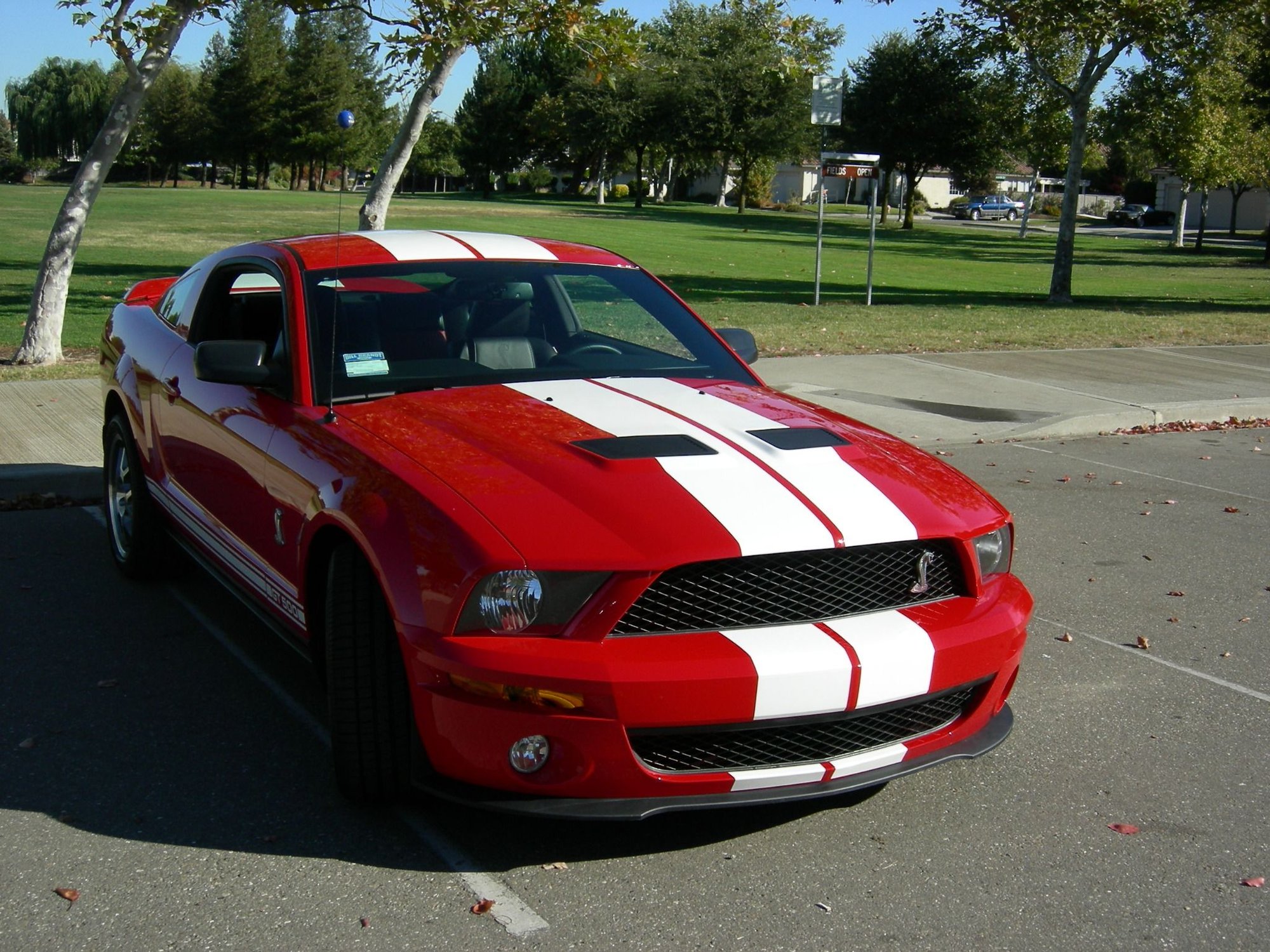

Is tyhat a 07 GT500 and a 70 GT500? I have a 07

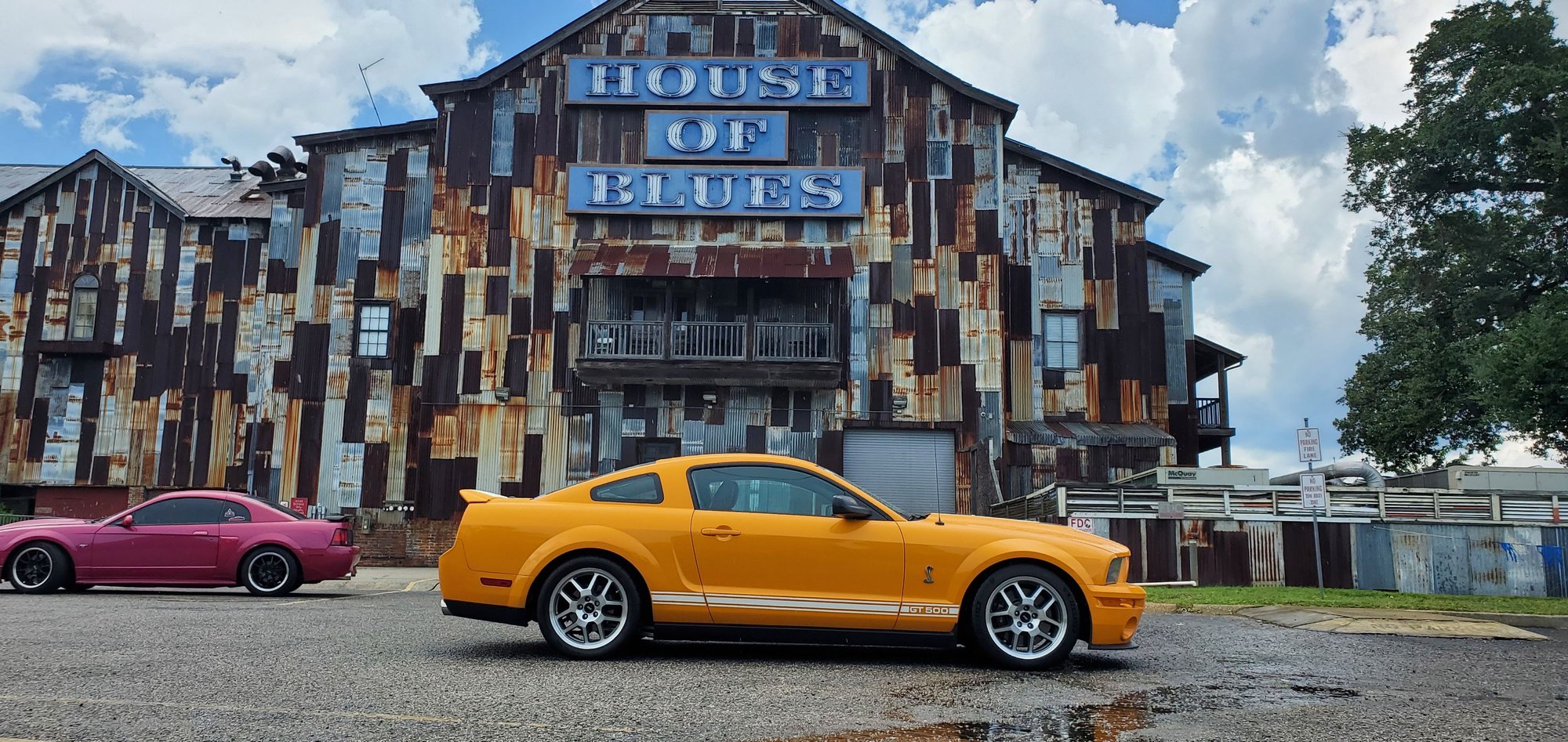

I have a 1969 Shelby GT350H (Hertz Rent-A-Racer) and like yours, a 2007 GT500.
