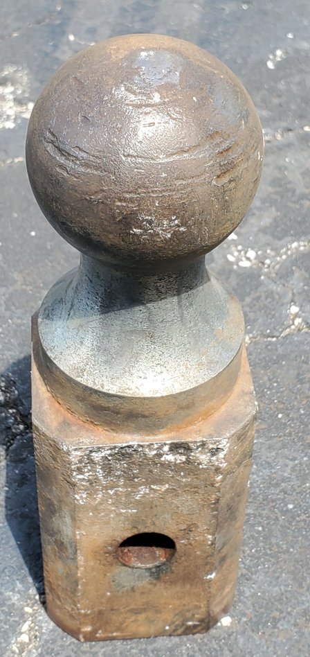

My new to me 2015 F350 has 247k miles on the odometer. The gooseneck ball looks very used and even has some grooves in it. It was a Texas truck with destinations in Arizona in its GPS. I can only guess is that this truck was used to tow something heavy long distances. It also has a layer of brown dirt on everything that they could not easily wipe down. I've found it under the carpets, in the A/C vents, in the seats, etc. So I have no idea on the history of this truck. With that in mind, I think the S&S DPC is a good investment. I ordered the kit and had it in hand before I took the fuel regulator off as if it had debris on/in its screen, I was going to have to replace the CP4 pump. Luckily, it was clean. Does that mean it has not had a failure, that it has and the CP4 has already been replaced? So no, the new S&S pump is not what I need at $2k, unless/until my current pump fails. It's nice to know I now have an option.
I also replaced the cold side turbo pipe. There was nothing wrong with the one on the truck, but I'd rather have the metal one than waiting for a possible random blowout.
It's either the original CP4 or if it was replaced because of failure, I'm thinking the new pump comes with a new fuel control actuator (control valve) as the one from the failed pump would have metal shavings in it.
My understanding is, if the CP4 fails, everything from the pump to the injectors needs to be replaced, so yes, the FCA should be replaced as well. It does make me wonder as with 247kmiles, the FCA screens looked very clean. Maybe the filters have been doing a fantastic job! The vacuum pump was leaking, so there was a bit of oil all over the front of the engine. Hard to tell if it was the original or if the CP4 had been replaced. Oh, and I found a broken piece of plastic from the cold side turbo hose laying on the top of the engine (below the intake), so I'm guessing that one already failed and was replaced with another factory ford hose.

I'm no expert or have experience with replacing the CP4.2, but it appears to come with the FCA (control valve) on it already when purchasing a replacement. That's all I meant.
https://marylandperfdiesel.com/i-238...p4-2-pump.html
https://rcdperf.com/products/6-7l-fo...ke-bosch-cp4-2
As to the CAC cold pipe, that could very well be the case.

Yes, that does seem to be the case.
