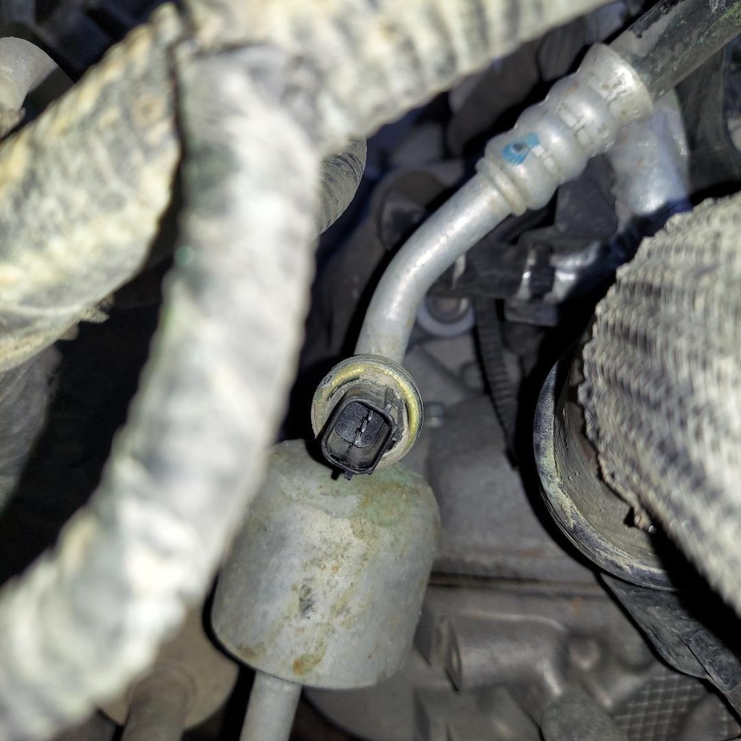

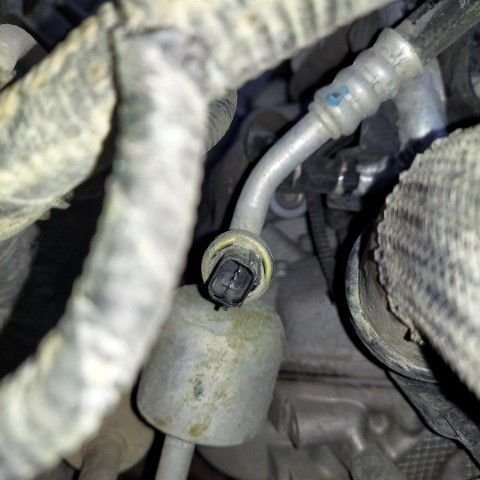

My ac clutch doesn't want to engage. I have checked fuses, relays and freon and all are ok so I think it is still electrical. Inside fan and controls all work fine.

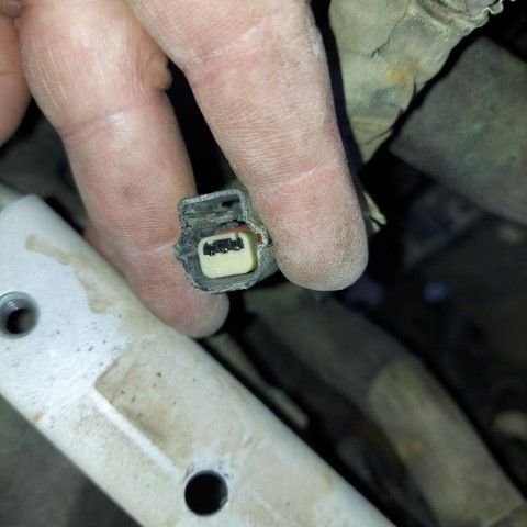

There is an electrical connector coming off of the compressor on the line to the condenser. It has 3 pins in it. How do I troubleshoot this device? (think it is a low pressure cutout switch) I'm used to a two pin switch that is closed or open. The three wires have thrown me for a loop. Guess its for the ECM. Also, if I unscrew the switch from the freon line am I going to dump all my freon? Some of these connections have schrader valves to hold the freon in but I've seen some that don't also.
