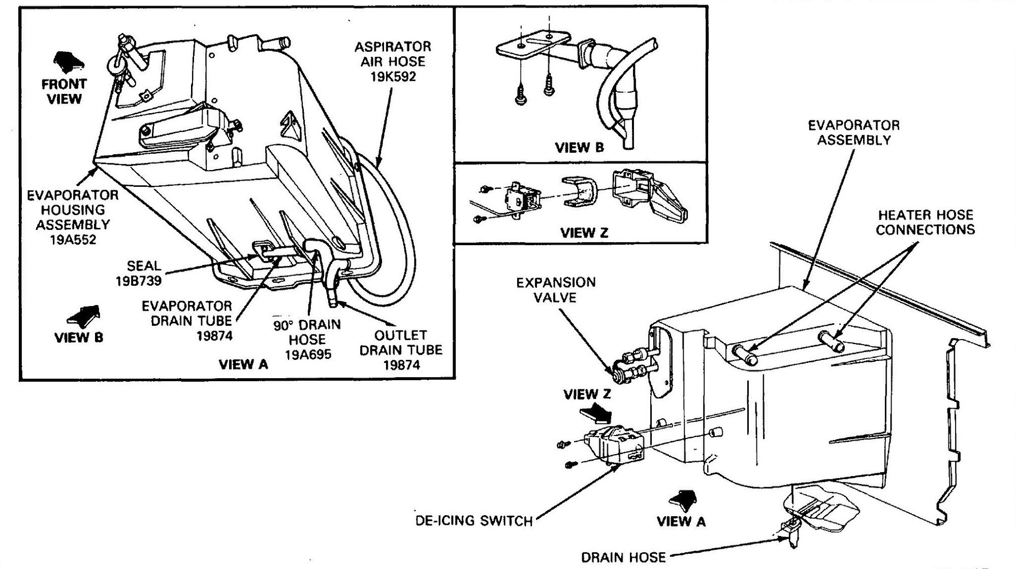

you may have one of two different types of switches that control the compressor. Ford calls them de-icing switches. one operates like a thermostat while the other does operate off of pressure in the system.
Here is the one that operates similar to a thermostat.
It looks like this and the tube is inserted inside the evaporator core. When the evaporator reaches 25F, the switch opens the contacts and the compressor shuts off. To test it, mix up a solution of ice water and salt. insert the capillary tube into the solution. Use a test light or meter and when the temperature reaches 25F, the switch should open. Something i have never checked is to see if there is an adjustment on the switch. I do not know if this type of de-icing switch needs to be replaced when you convert to R134a or not. When converting a system that uses the pressure type switch, there are 2 switches listed. one for r12 and one foe R134a. The pressure switch is also adjustable though.
Here is what the thermostatic de-icing switch might look like

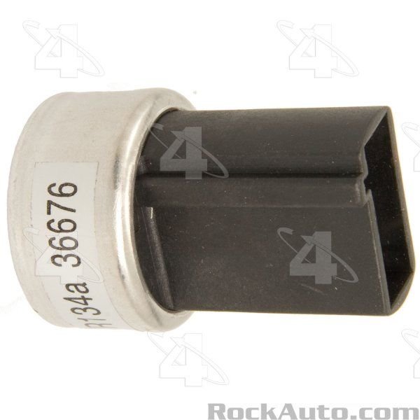

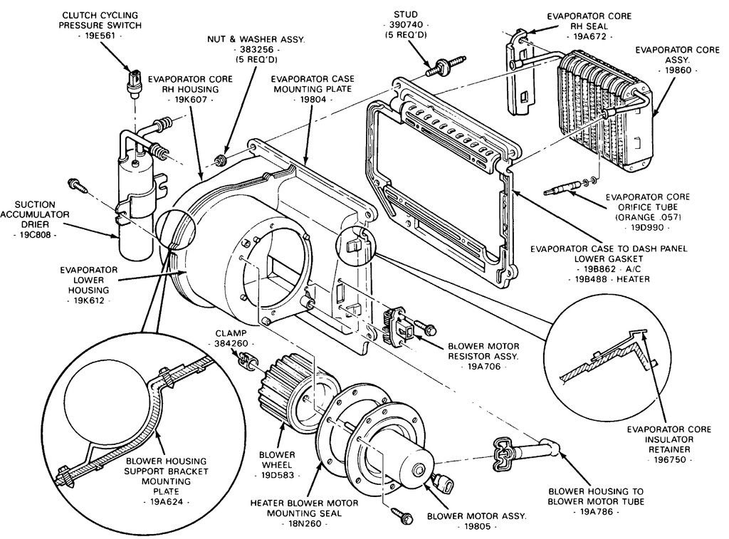

here is what the pressure type deicing switch looks like also known as clutch cycling switch.
and it screws on top of the accumulator. the fitting on the accumulator looks like a schrader valve.

I personally don't know about the one that operates like a thermostat. if it is not adjustable then perhaps they a company like 4-seasons sells one that is designed for R134a.
the pressure type switches are adjustable but i do not know if the cut in and cut out differential is the same for R12 and R134a.. I know thye sell a pressure switch that is preset for r134a..
