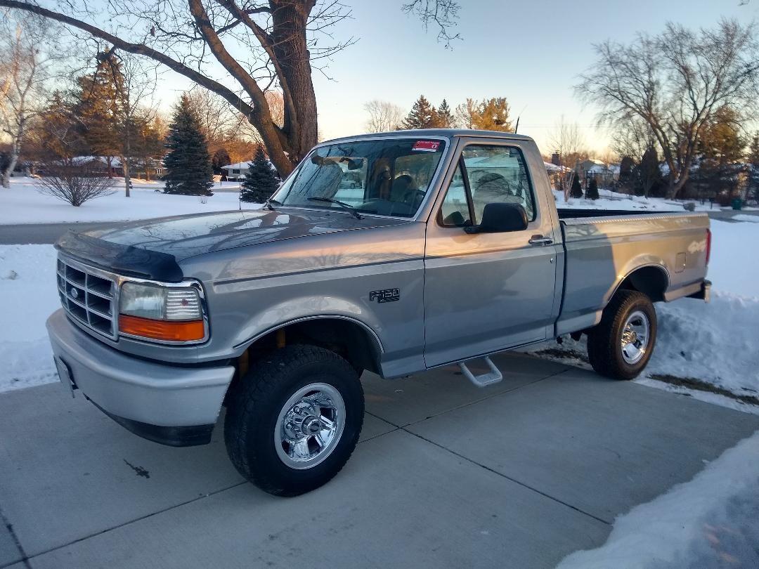

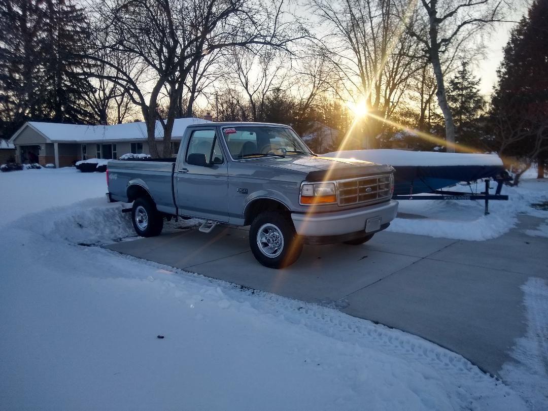

Old Feb 11, 2023 | 04:03 PM
yeet's Avatar
yeet
Joined: Feb 2023
Posts: 278
Likes: 86
yeet's Avatar
yeet
Joined: Feb 2023
Posts: 278
Likes: 86
Old Feb 11, 2023 | 04:06 PM
yeet's Avatar
yeet
Joined: Feb 2023
Posts: 278
Likes: 86
Thats all I have for now. More to come
Old Feb 11, 2023 | 04:25 PM
sandymane's Avatar
sandymane
Joined: Oct 2016
Posts: 6,185
Likes: 633
From: Houston/Sugar Land
Those pictures didn't disappoint me. Great looking ride.
