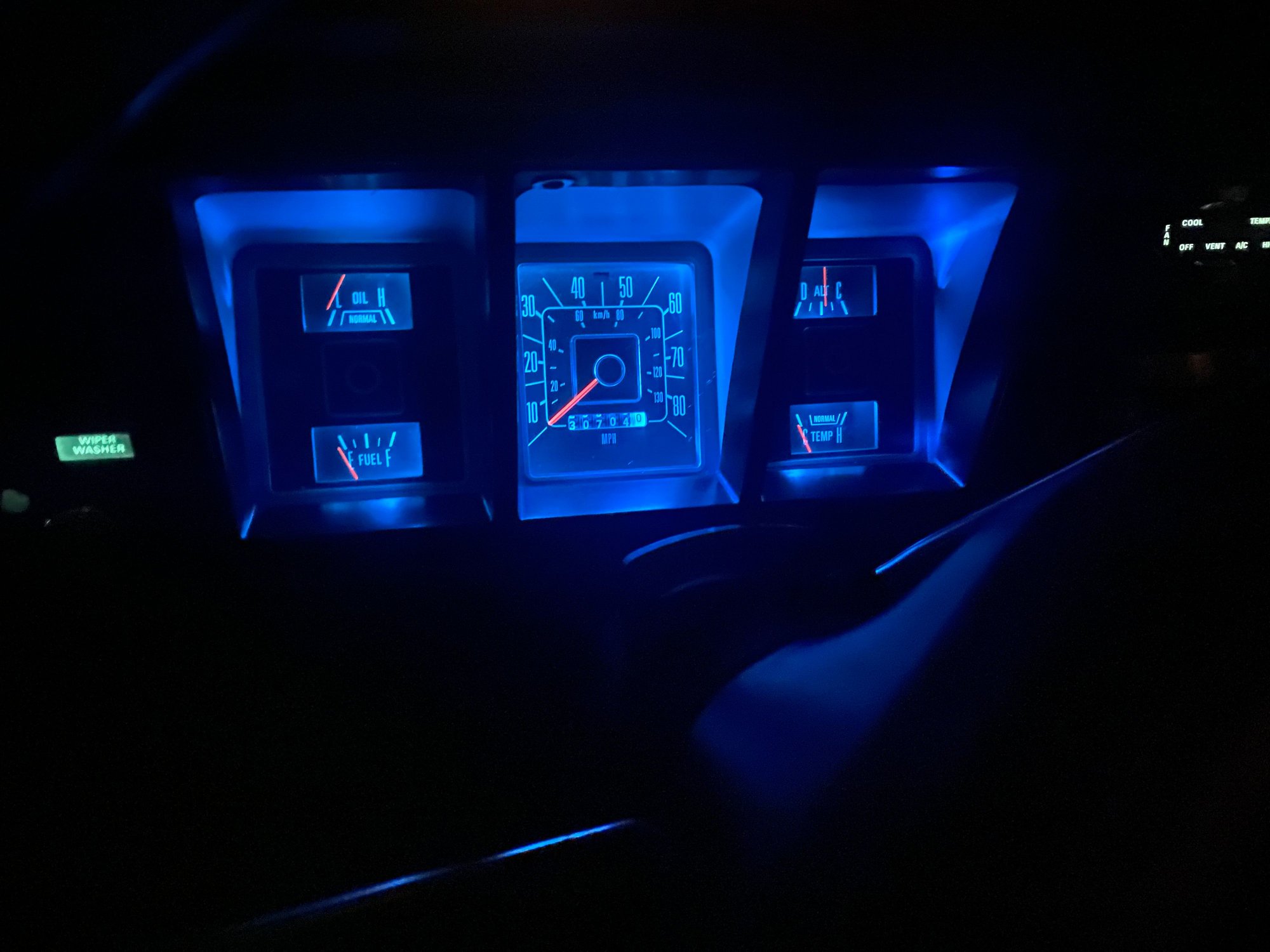

Old Feb 11, 2023 | 06:48 PM
Ljblue's Avatar
Ljblue
Joined: Aug 2021
Posts: 91
Likes: 25
These are just white LEDs in the backlights but they make it really blue. I think someday I’ll change the wiper and the hvac lights to blue I guess so it matches better
Old Feb 11, 2023 | 08:39 PM
vettman's Avatar
vettman
Joined: Jul 2001
Posts: 432
Likes: 38
Good looking dash
The kit I ordered from HiPo is supposed to have LEDs that mimic the original dash lights. We shall see. Thanks for sharing the pic.
