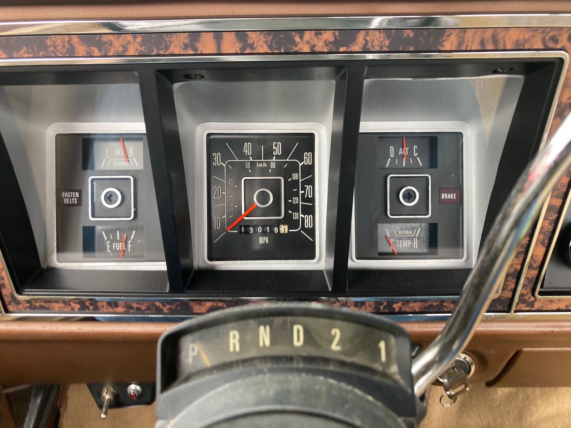

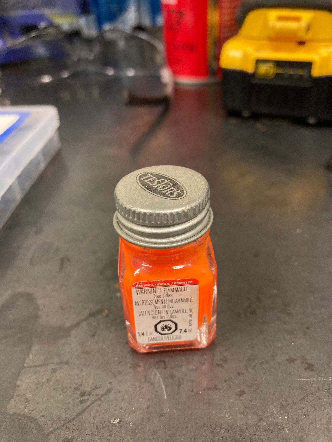

Painting gauges
My gauge needles were faded to the point they were almost white. I used testors model paint and a fine brush. The needles look much better now.
I simply inserted a sheet of paper between the needle and gauge while painting in case I slipped or dropped a bit of paint.
