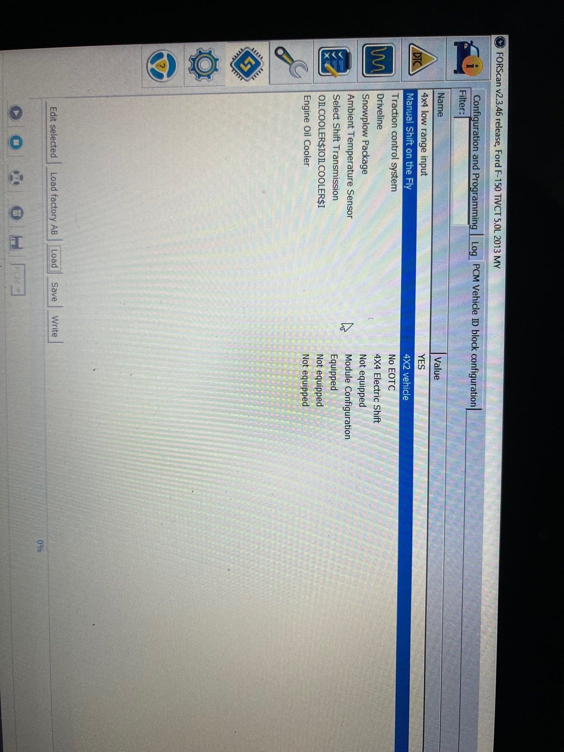

I have a 2014 Coyote, 6R80 and the F-150 Transfer case that I have put in a 1980 Scout Terra. I can not get the PCM to recognize that 4x4 selector switch, says invalid. The PCM recognizes the TCCM, but not the switch. Subsequently I can not change the transfer case. Can anyone help? The highlighted option in the screenshot will not let me change it. Maybe someone has the codes in a spread sheet so I can change it that way in Forscan?

I can not find spread sheets for the TCCM (761), the PCM (7E0) and the SCCM (724).
