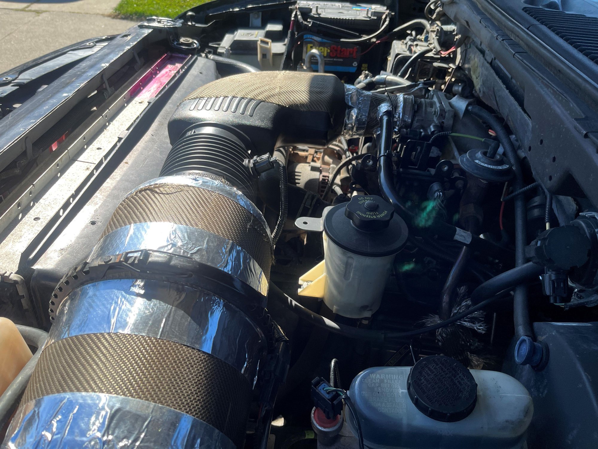

I was board last night, so I dug up some leftovers from the last project. I ran short on the LavaRock, but more is on the way.
I know it is not finished, but I wanted to share.
Air Box w/LavaRock

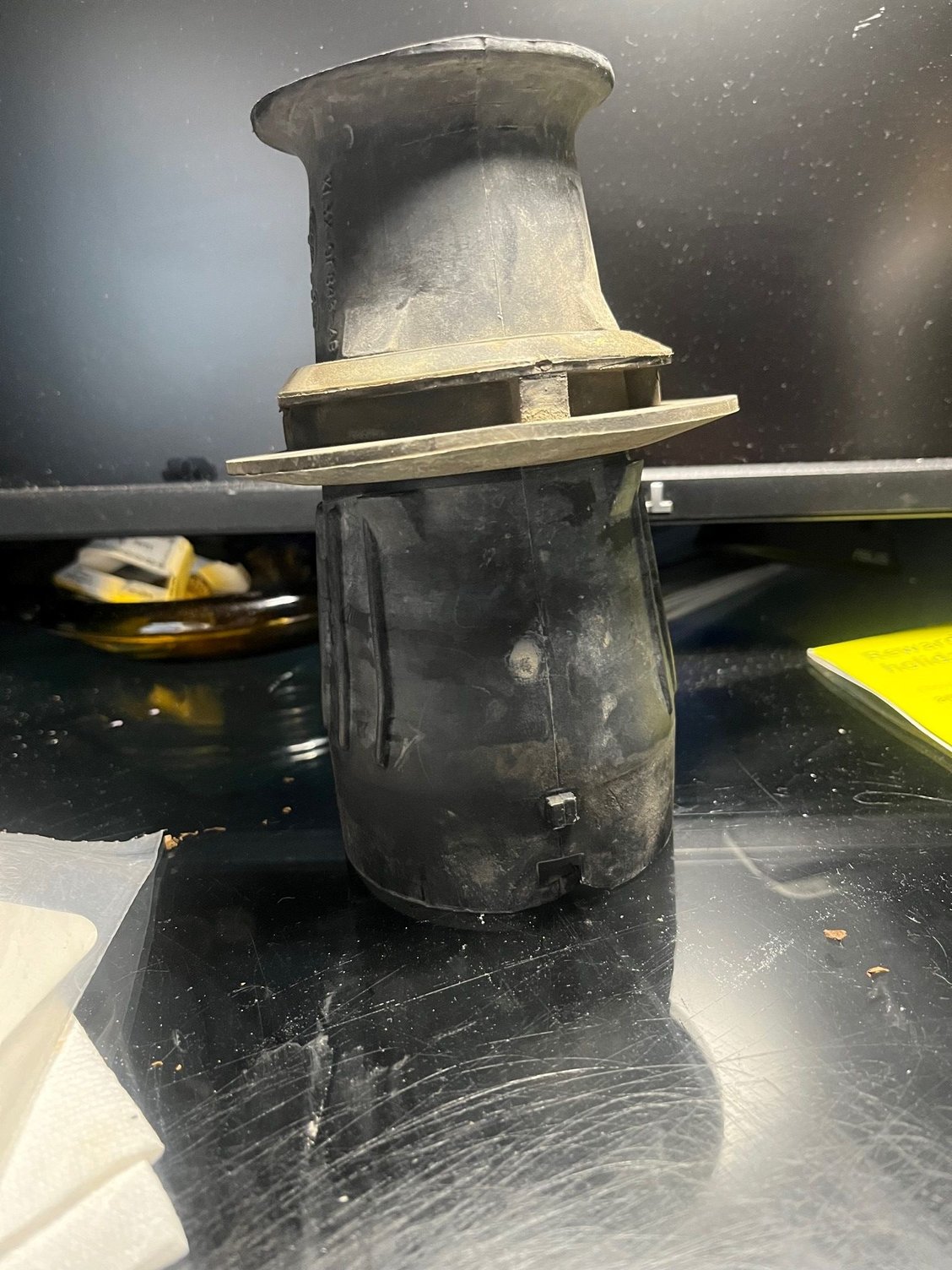

Here is the air silencer I removed.
Air silencer removed and a short piece of ABS pipe was installed in its place.

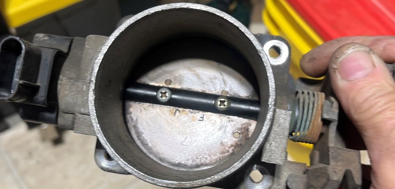

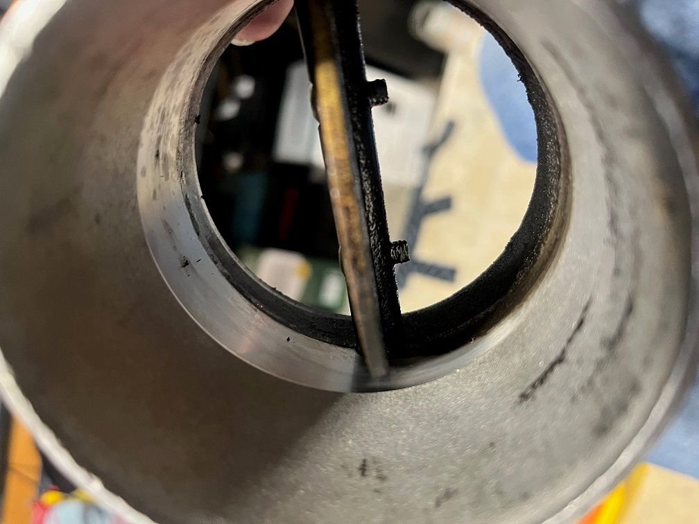

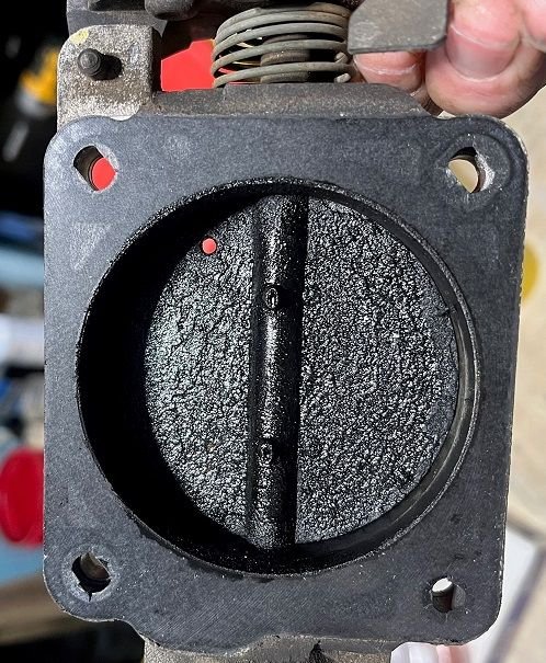

I couldn't help my self so I peeked into the TB, here is what I found.
5kmi ago I Sea Foamed the upper intake, What's wrong with these pic's? I'm not sure what is going on but something is..... With it being cleaned not to long ago there should not be all that gunk behind the butterfly an not Infront of it. Also, if it burned that much oil in such short amount of miles, I should see on the dipstick or am I the dipstick??
This is where you-all chime in, confirm with Im having issues (Gremlins) or I'm smokin crack :-).

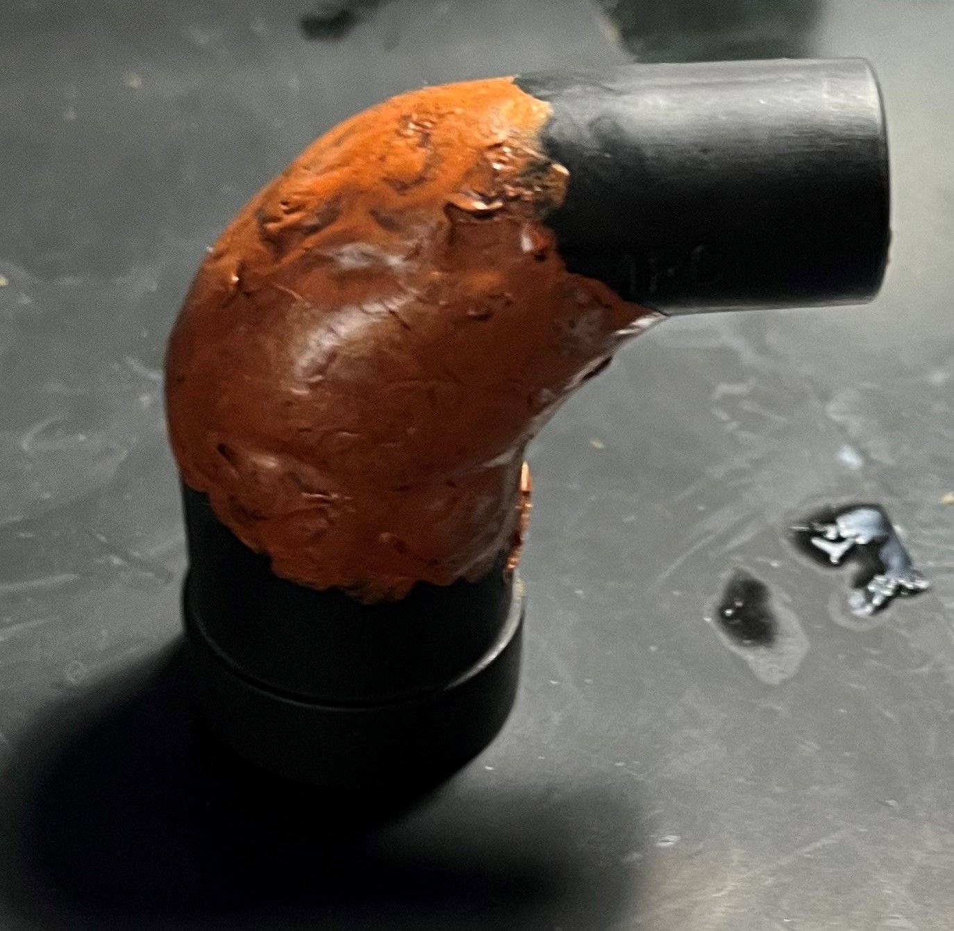

What started out as a simple DIY CAI ended up being the proverbial can of worms. Of-course it was expected and needed. After some cleaning, smoothing, and a little polishing the Expedition is back together, for this elbow on the back of the intake manifold.
Napa found a set in the lower intake gskt set, but no such luck it was way to big. So in the mean time I needed to effect an emergency repair.
ow about a round of Name that part, Not the prettiest job but it doesn't leak so it should work till I find one. I have searched several different ways to no avail and manuals have not arrived as of yet so how about a round of name that part. PLZ PLZ

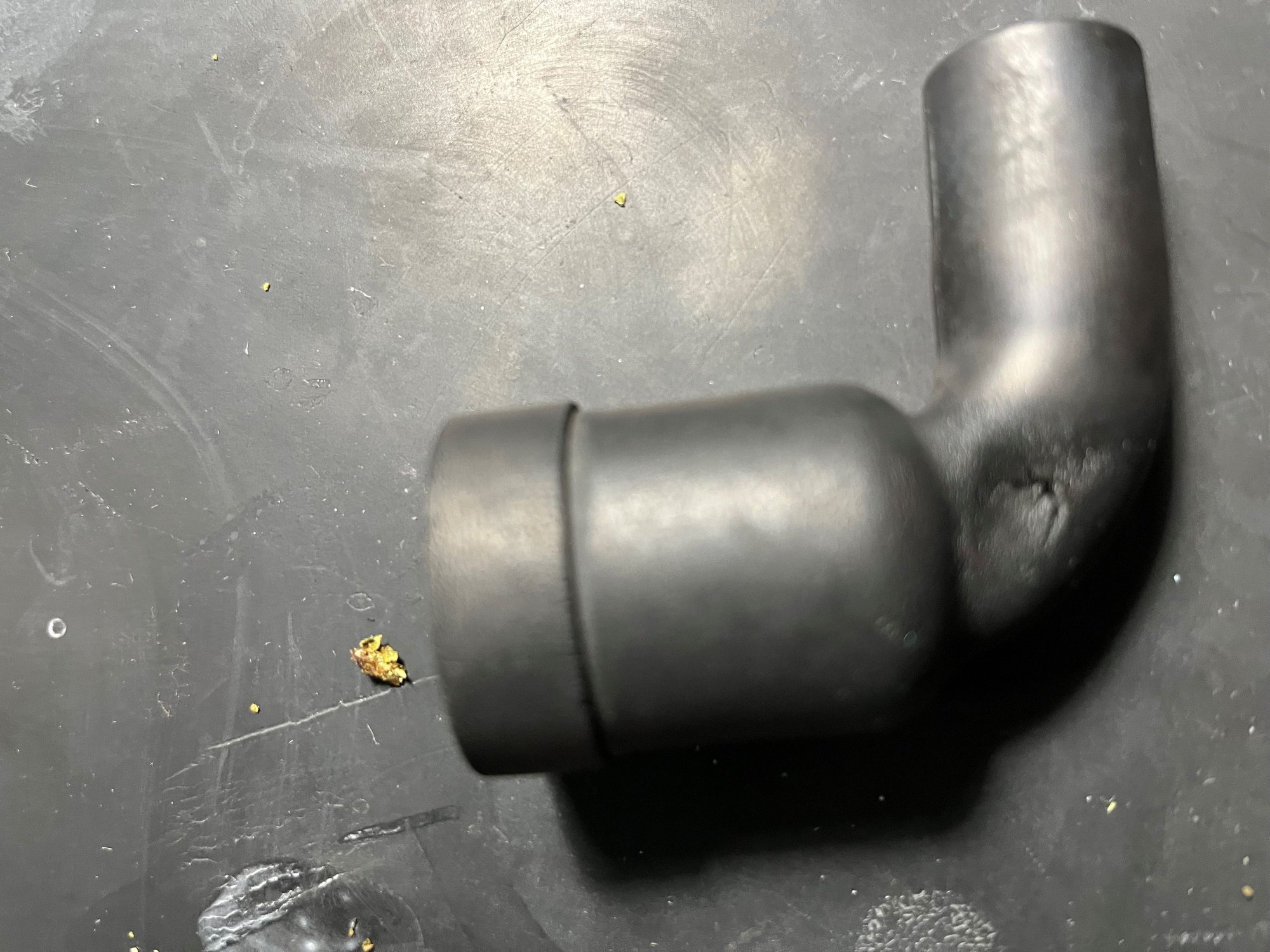

Part # for this elbow is F75Z 6C324-JA, but that number crosses to just the elbow and the complete line from intake to pcv. Now to find one.

How did you do the seafoam, through the vacuum line at brakebooster? Follow that line back to it's vacuum source. If not mistaken, that line attaches to the engine side of the throttle body? So it would not clean that side of the butterfly

I used seafoam in the fuel for the injector and cylinders, and the spray into the TB just before the butterfly. it's a moot point now the top end is sparkly clean no leaks. I didn't check the milage on my shack down, but I was having so much fun I tuned out the world then ran out of gas :-(. I knew I would need fuel when I left town and just kept passing station after station. I missed it by that much LOL AAA to the rescue all is good. Yesterday was dent and scratch removal today I'm thinking new sounds, and a few pic's for show an tell.

We know cuz it is black and wet looking so it is burnt oil and oil usually comes from the pcv. In the expedition the pcv port is at the rear of the lower intake, and you would expect for the trace to start there. except when the TB slams shut then everything in the intake swirls around. also, when the engine is turned off the gasses will rise coating everything. My thoughts are leaning toward massive blow by would need to be present in order to coat the intake so heavily in a short time (3 months). with the butterfly coated on the back side only the pcv is the most likely injection point. I also found a white residue in the brake booster vacuum line. Maybe someone didn't like the PO and put something in it??? Unkown, so a compression test setting a base line is certainly warranted. I guess if or when I start seeing smoke out the pipe it will be motor time. Till then rod the **** out of it LOL Mike/EZ
