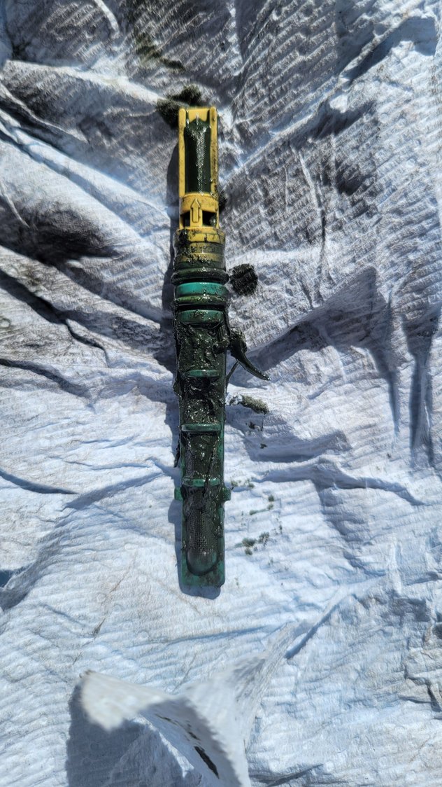

Replaced this and dryer, pulled vacuum, recharged, pressure high on low side, any ideas
The black beach sand is the desiccant sack has ruptured, the color and the chunks of material are internal compressor pieces. Your compressor is shot. Make sure you flush all the lines, condenser, evaporator AFTER you remove the old compressor.
Once all the lines and other components flush clear, then install new compressor etc, evac and recharge.
What are the actual numbers (low and high sides) including testing conditions? Outlet temp? EVAP inlet temp? Clutch cycling behavior?
Did you replace the compressor condenser, and accumulator? Flush the lines and evaporator?
