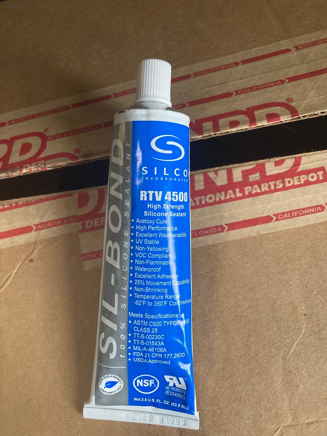

1browski
What do you use to glue them in? Im redoing mine and all I could figure is some type of silicone adhesive.
Correct, the ones I've installed came with RTV Silicone adhesive. Here is a picture of the tube that came with the last dash cover...
