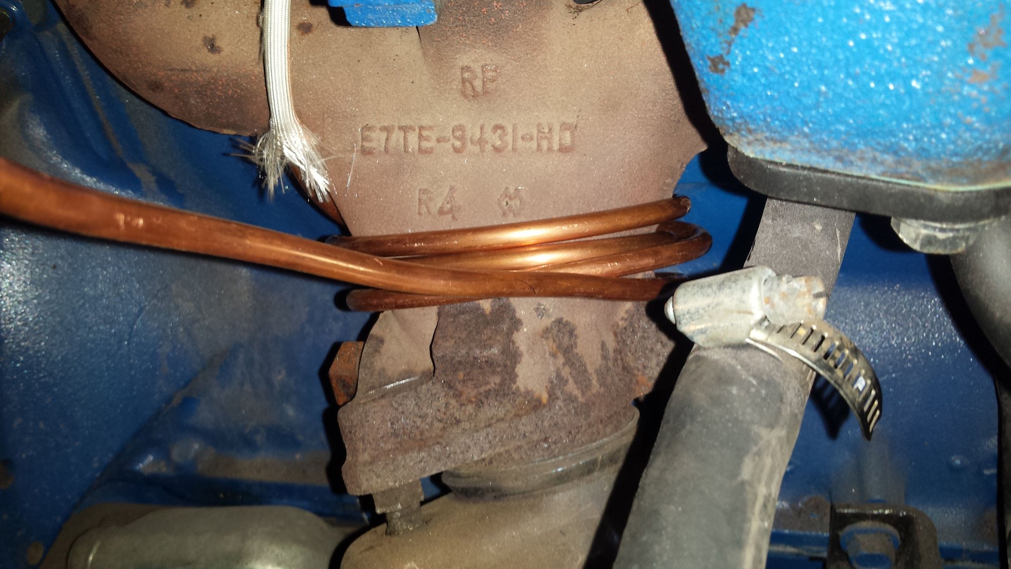

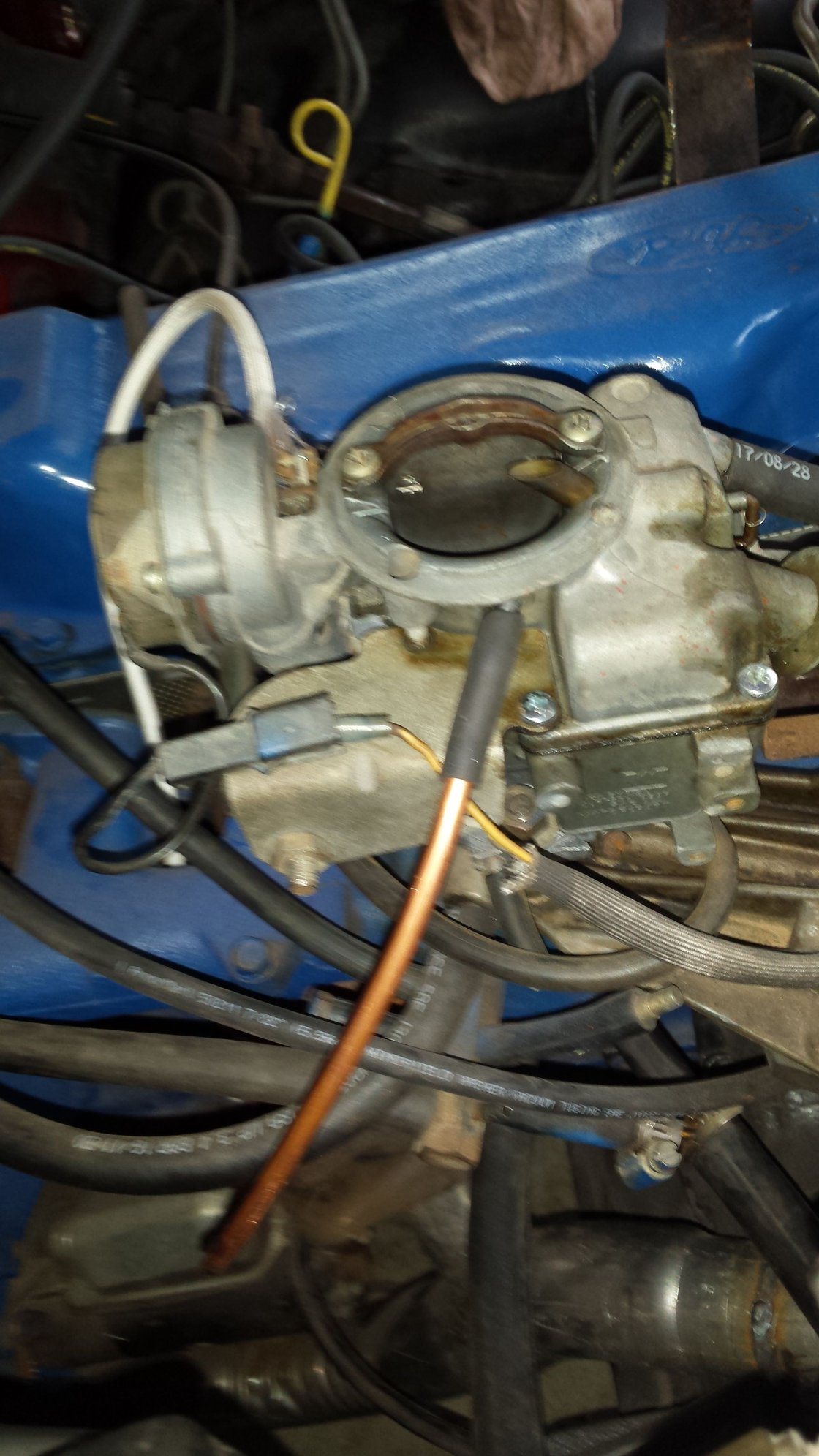

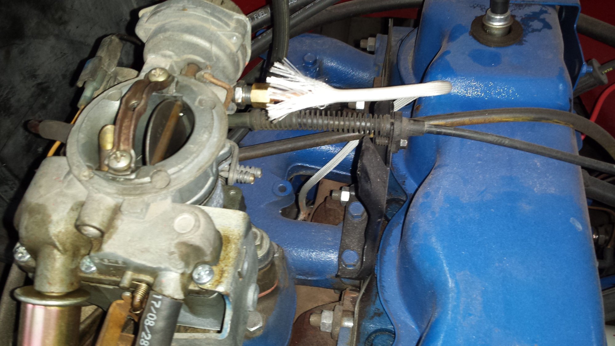

1 is the hot air asst. choke. The EFI manifolds dont have a way to hook up the hot air to open the choke.
I took copper tubing and wrapped it around the manifold, do a few more wraps than I did, and hooked it to the carb like the factory did.
Because I did not do enough wraps when it got down into the 20's (F) the choke would not come off fast idle.
I took header wrap and covered the tubing & manifold to keep the heat in and it worked great.
You also need to heat the intake manifold floor or the fule will drop out if the mixture.
I bought a plate that has nipples for hoses and I run heater hose from motor to the intake> to heater core> back to motor.
You can see part of this in the first picture. Others have have made them and some dont run them at all.
