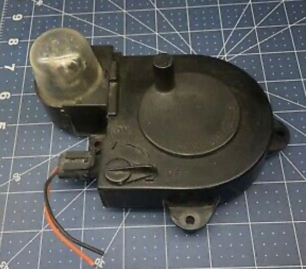

Almost all cars and trucks in a JY have a under hood light that is tilt controlled. I know a 99 Dodge Ram 2500 has a nice big one that is tilt controlled. The 80-86 Ford truck light pulls out on a wire and it is spring retractable. I have seen that same light set up under other brands and it is hand wound up.

I put one of these on my 79 F350 and on my 69 bronco. They came from 80’s to 90’s Chevy trucks. The light has a magnetic base and can bet stuck to the hood and it has a ton of retractable wire (like 10’ or more). Switch is on the unit so wire it, mount it to the fender and be done.

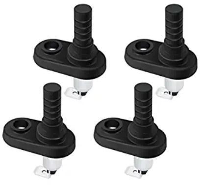

Even a pin switch would work, but it would not allow you to turn them off if the hood was left open for a long time. You could do a pin switch and a toggle with the pin allowing the lights to come on automatically, with a toggle to kill power if needed.
