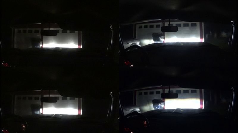

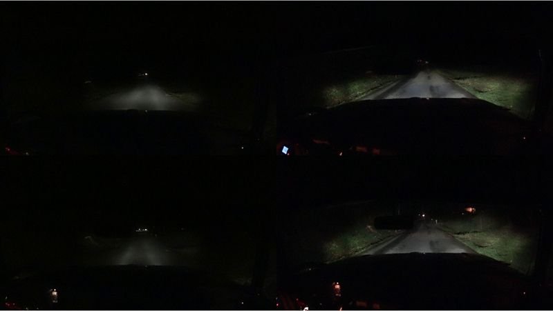

I'm a little late to the show now but...I went with JW Speaker LED Headlights about 8 years ago. The look of those, in particular are definitely not for everyone but the functionality blows sealed beams out of the water. At the time that I purchased them, I thought they were the best LEDs on the market The low beam with those LEDs is just about as bright as the High beam of the sealed beam. These have 28w low beam and 42w high beam
If it is a driver, where you need to be able to see, seriously consider some upgrade from sealed beams, whether that is an H4 upgrade or LED. I think there are more correct looking LED headlight for older vehicles now.
Here are before and after, sealed beam left, LED right. Low beam top, High beam bottom. The 2nd picture does not do the LED high beam justice, even though it does illustrate a significant difference in how well the road is illuminated..
