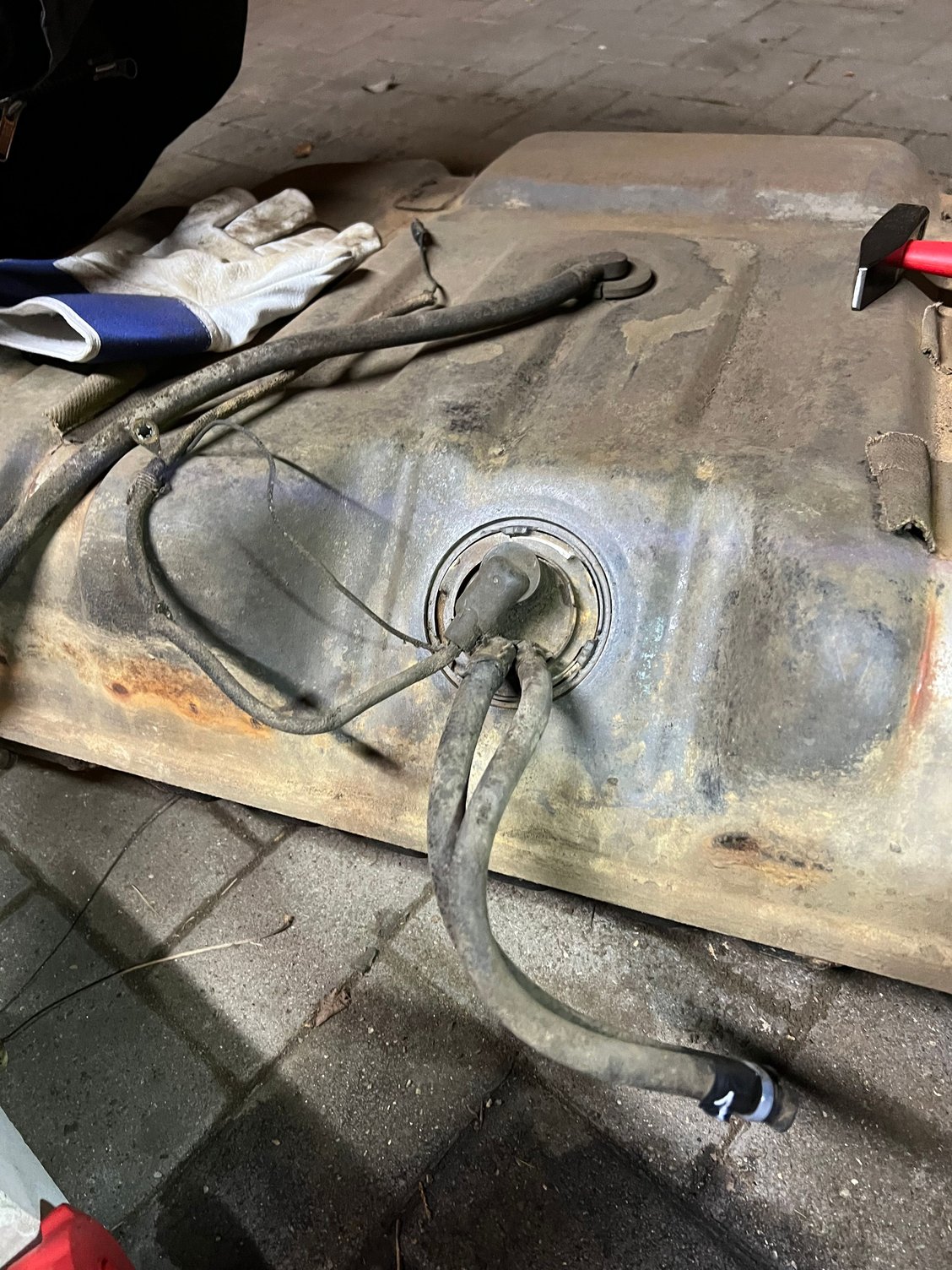

Hi
I‘m jan-Philip Form Germany and Inhaber a Ford F100 Form 1973.
my English isn’t the best but I hope it is enough for you to understand haha
i Need your help! Does anyone now something about tank sending units from this truck?
my issue is that I wanted to buy a new sending unit for my 19 gallon rear mounted tank ‘cause the old one is rusted. but I can not find the same unit that I have right now in my truck. All sending units I found on the internet that might fit just have one pipe connector for the fuel line. But my old unit has two pipes. One for the supply line and one for the return line. Why do I just find sending units that have 1 pipe ? And no units with 2 pipes (supply & return line) ? Is my sending unit not stock?
I attached a picture of my sending unit.
i hope someone can help me
thank you!!

I am also not finding any Ford Sending Units with a feed and return line. I found Chevy sending units though. Weird.
Wenn du Englisch Hilfe brauchst, ich bin Amerikaner hier in Deutschland und kann helfen.

The LILAND GLOBAL ISU1732 here seems to have 2 connections according to the picture, but it's not available. At least you have a part number now you can search for.
https://www.rockauto.com/en/catalog/...ding+unit,4436

thank you! This is really weird.
but I have heard that the ford mustang and the F100 had the same sending unit… is this possible? Because I have seen a sending unit with supply and return line that looks like mine, but was for a mustang ?
And thank you for your offer! In wich city are you in Germany?
I’m from Hamburg ✌🏻
