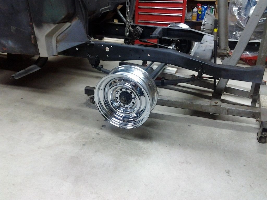

Front wheel make,size,Vintiques 12-5605334 15 X 6 3.63 BS
Front tire, size: 205/70R15
Rear wheel make, size: Vintiques 12-5805042 15 X 8 4.5 BS
Rear tire, size: 275/60R15

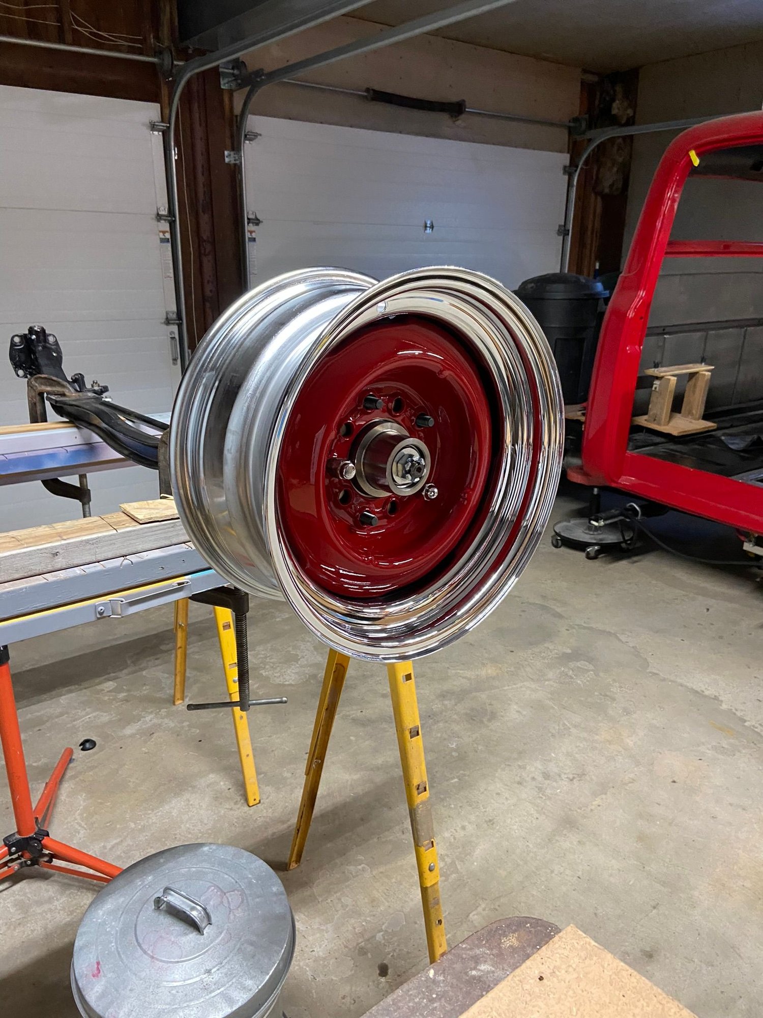

My wheels are from Summit Racing, US wheel 52 series chrome smoothie, 15x6x5.5 bolt circle w/3.75 backspace on my 49 F1 (front) & 15x8x5.5 w/4,25 backspace (rear)

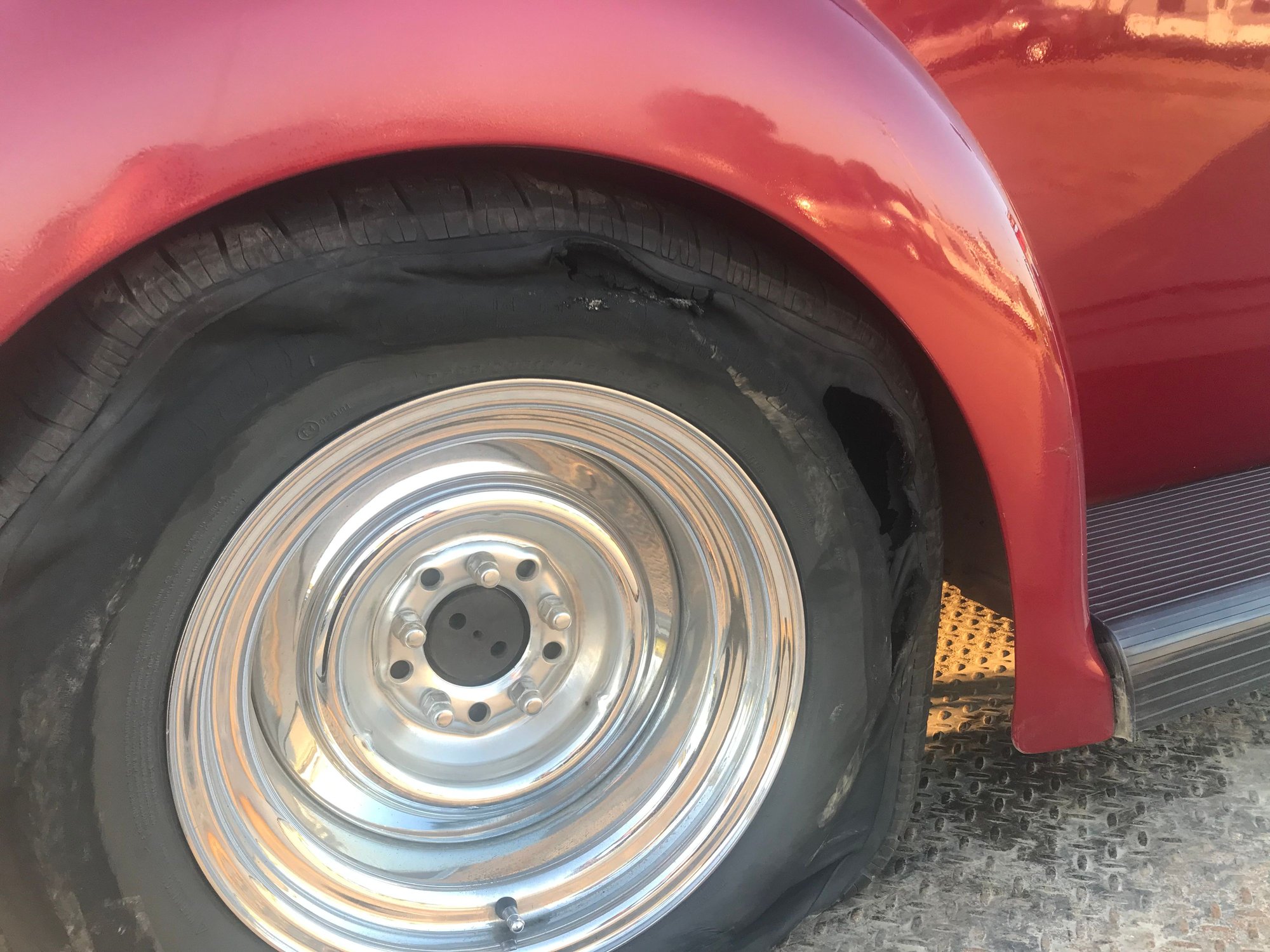

Yes BJ I blew a tire on my coupe 200 miles from home near a town with at least 3 tire shops and most car dealerships . There were no 15" tires my size ( not shocking being a 255 60 15 ) but absolutely no 15"s the same height . I ended up buying a pair of 235 70 15 's as they were the only thing in town , a substantially larger tire . After watching the shop try for hours I asked if he had any 15"s at all and he told me of the 235's saying he was sure they were far too large . My answer was the car had air shocks I will make them fit . The car got new wheels 2 springs ago with the repaint but I serious wish I would have gone to 16's .

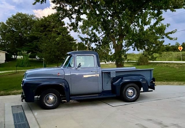

My 53 is running 8" rims from Early Wheel in CA. Fronts are zero offset w/ 255 / 60-15 tires ,
rears are 3/4" negative offset w/ 275/ 60-15 tires, stock suspension.

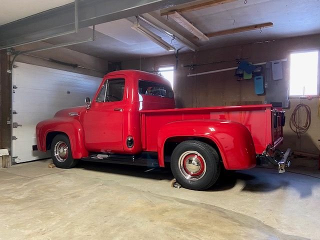

U.S.Wheel, Deuce 456 Series, 15 x 7, 4" back space. Tires are 225/75/R15
