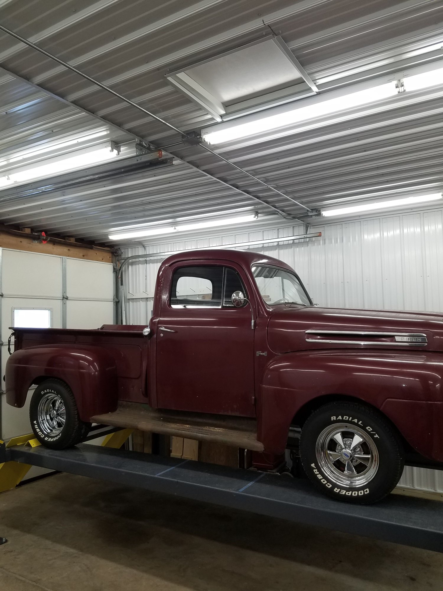

My 49F1 has 7" crager s/s on back and i'm not sure of fronts. Tires are P275/60R15 rear and P215/70R15 fronts. Using wheel adapters- no probelm.
A friend is looking for Cragar SS wheels. What thickness are your adapters? Are your running Drum or Disk Brakes up front?

Not sure on adapters. Maybe 1". Stock suspension with new Possies super slide leaf springs. Really didn't lower truck as originals were weak.
