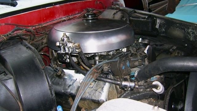

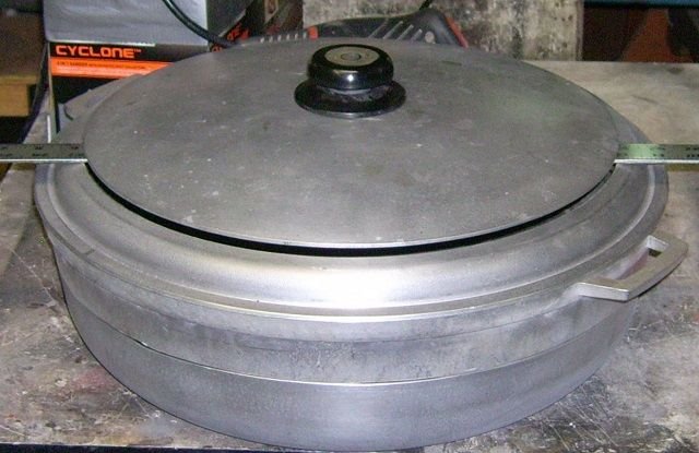

Carburetor threads can end with air cleaner posts can't they ... and "Yeah, I know I posted some of this before" ... but that was in a more "general topic" thread.
My current air cleaner evolved after I spotted this big aluminum roaster with lid at an indoor antique / flea market dealer down in Floyd, Va.back in 2021 (as I recall). My truck was going through it's 3rd redo since leaving Norfolk, Va. and it was a most major redo. I knew I wanted something different for it's air cleaner, something to that shed water running off an open hood too, and this cast aluminum roaster shouted at me. Once back home, it sat on a shelf for a long while as I was deciding on that first cut, etc. I almost painted it too, but the idea of a fine sanding and polish won out. It's got tapered sides, was 5" deep, is now 3-1/4" deep. 17" diameter on the big open end, it fit over a 14" filter nicely. The rounded top used a second wing nut at first. There is a near 1-1/2" open space all the way around the base for air to be pulled upwards into the interior through the filter element.
Bottom of roaster. Two holes, one dead center, the offset one will move it a little away from the firewall. It cleared dead center, but it was really too close to the firewall pinch weld with the "then" flat (non recessid) base. I plugged the now un-needed offset hole with a countersunk screw & locknut since recessing my filter base plate 1/2".

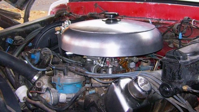

As used on the truck, first step has stud protruding up through the center, a piece of rubber inner tube, a 3" aluminum disc "washer", and then a regular wing nut.
Inside is over 3" deep. The flat is near about 13' diameter, maybe a little more? The 14" element is 12" ID, The outer edge fits just as the sides curve up from the bottom flat. When tightened, the outer edge of the filter top slightly compresses, the inner edge will meet the inner lid. I think the shiny surface is from something cooked in it?
The Roaster just setting in place after cuts, but you can see what I did. The lid was trimmed on my bandsaw to near about 14" diameter too and it's dome shape blends well into the sides, and it hides the first wing nut and washer disc under it. Black **** has a steel insert now, it is used as the last / very top most wingnut. It's still black with some grey JB Weld showing where it was made of two pieces, but I included the steel 1/4-20 threaded T-nut insert like used in wood projects. Might yet paint the **** solid black.
I'm pleased with just a sanded finish ... it doesn't look bad at all. As an aside, it might even reduce evaporation of fuel in float bowls as any vapor would now have to fall outside of the air cleaner to rise up and dissipate, I think. I know a small portion can evaporate into a space above the liquid, like the fumes in a half full gas tank, but once they reach a certain density above the liquid, it stops. I'll report if so. That top lid's Bakelite handle makes a superb top nut, spins loose fast ... and impossible to lose down a carburetor throat.
