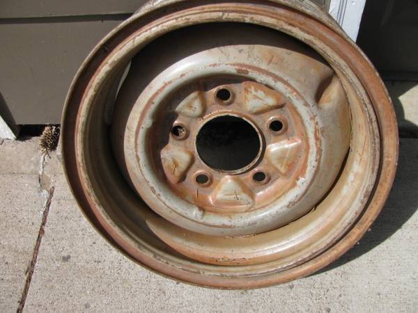

Likes: 647
Depends, standard wheel was the drop center 1 pc 15" innie ( inner tabs for hubcap retention), the 2 pc heavy duty flat base 15" innie was optional. Vintage photo shows 2 pc on rear, 1 pc on front of this '65 4x4. The owner probably decided to upgrade his capacity with just using 2 on the rear ( actually quite common practice back in the day) Factory would have installed all four matching rims.

Are the wheels on a 65 F100 with the 352 engine split rims, 2 piece?
An optional F-100 wheel in 1965 was a two piece lock ring style. These multi-part wheels were a heavy duty option, but seldom found on trucks so most likely yours doesn’t have them. Picture below so you can assess for yourself.
I have no idea what impact this would have on a disc brake conversion. Stu
Edit - I didn’t see your picture. So ditto what tripleframe said. Stu

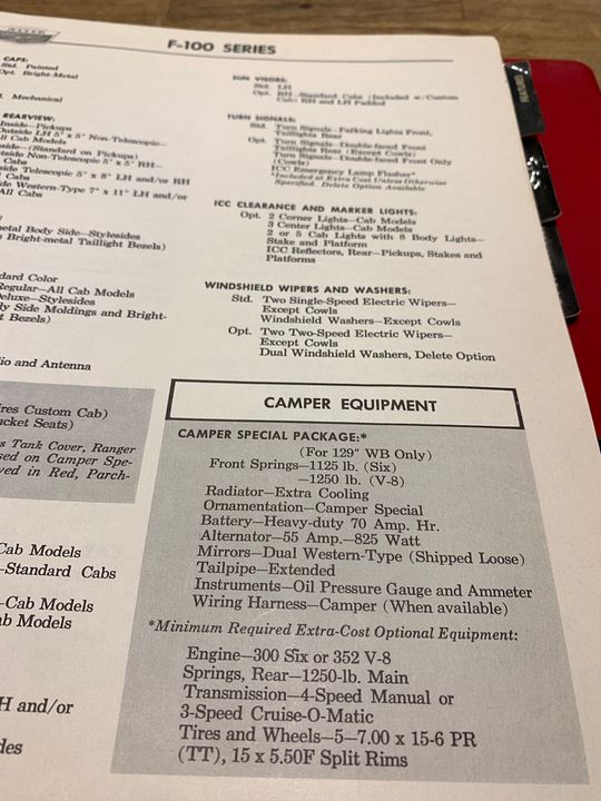

From: Vancouver
I know of an unmolested '66 with 15" lock-ring wheels. It is a Mercury 100 Camper Special with a 300. Maybe part of the CS package when ordered on a half-ton?

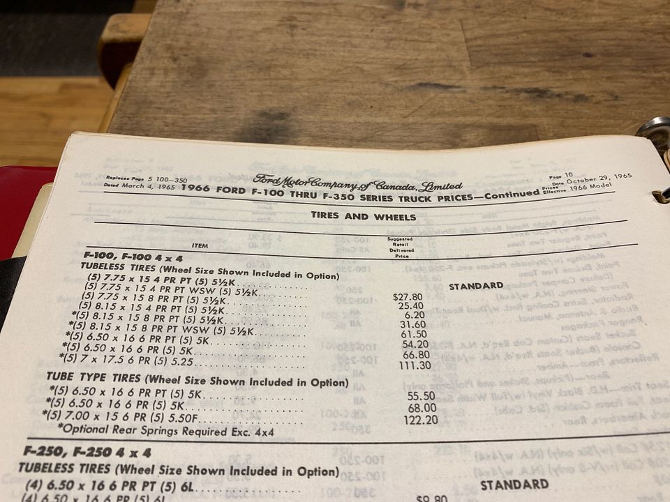

From: Seattle
That's correct, they were part of the required extra equipment on the 100 Series Camper Specials. They were also available to order as an option on any F or M100 but would require the optional rear springs. In that case the wheels were a $122.20 extra Canadian according to the price list and the springs were an extra $5.30 on a 4 x 2 truck.

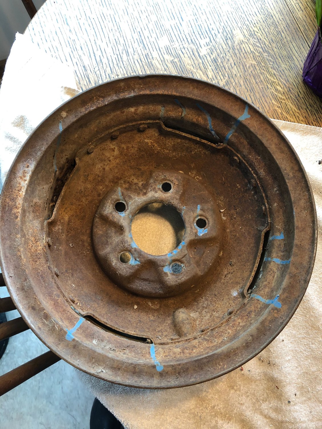

From: South East Kansas
Glad this thread came up. I am in the process of putting original wheels back on my 63. I still have a set of the 2 piece wheels that Dad bought to improve the load capacity, as he hauled a camper on it.
Kind of a weird wheel, as it was not totally split ring. You have to rotate the ring until two places lined up, and it will come apart.
