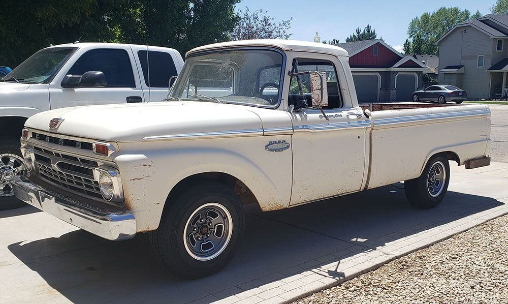

I have a 1966 F-100 that I want to put a set of new rims on. I have done a little research on what backspacing I should have, and I am getting all kinds of different answers. I want to go with a 15x8" rim, tires 235x75R15. Some say 0 backspace is needed some say 4.5. What to get the rims ordered and on the way to my garage. Here is my build thread 66 F100 Market Place Build - Ford Truck Enthusiasts Forums (ford-trucks.com)

Regarding wheels and backspacing. With a 66 2WD F100 that has the stock 5 x 5.5" bolt pattern, you could go with anywhere from 3.75-4.5" of backspace on a 15 x 8" wheel. On an 8" wide wheel 4.5" of backspace is considered 0 offset which would center the wheel on the hub. The lesser the amount of backspace the more the wheel would stick out from the truck. The same holds true for offset. Here are all of the 15 x 8" wheels we offer in a 5 x 5.5" bolt pattern in that range of backspacing. Some of those such as the Bart modified or stock car wheels are non-DOT. Obviously, you don't want to go with any non-DOT-approved wheel.
Here's some helpful info on wheel backspacing and offset. The third link down is a chart which is a helpful tool to show the relationship between backspacing and offset.
- Backspacing
- Offset
- Backspacing to Offset conversion chart
Your planned tire choice of 235/75-15 is a good choice as well to fit a 15 x 8" wheel and your truck. Let us know if we can be of any further assistance.
