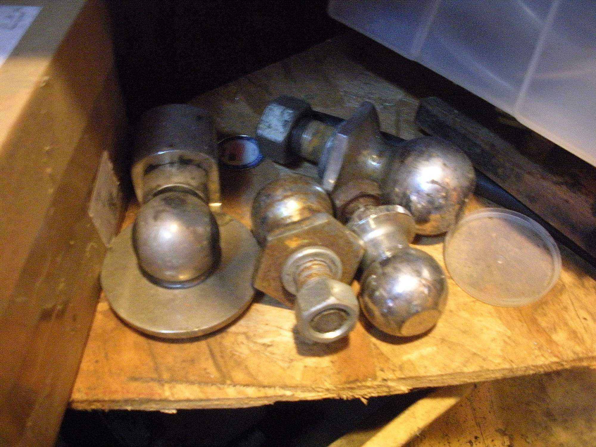

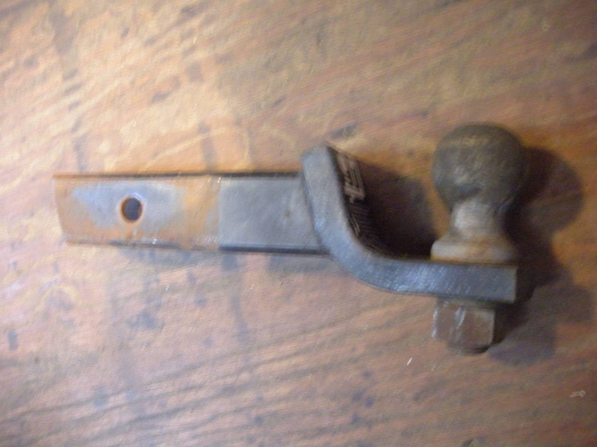

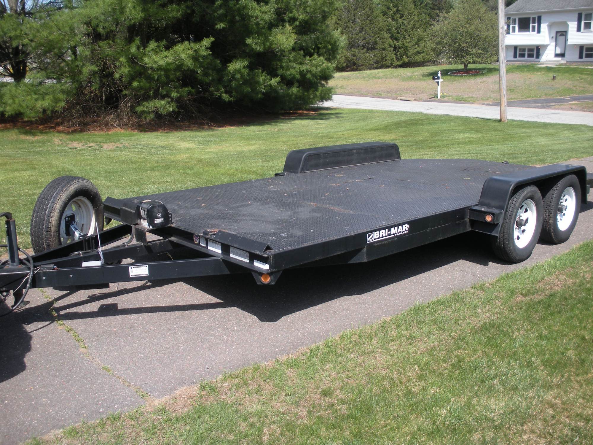

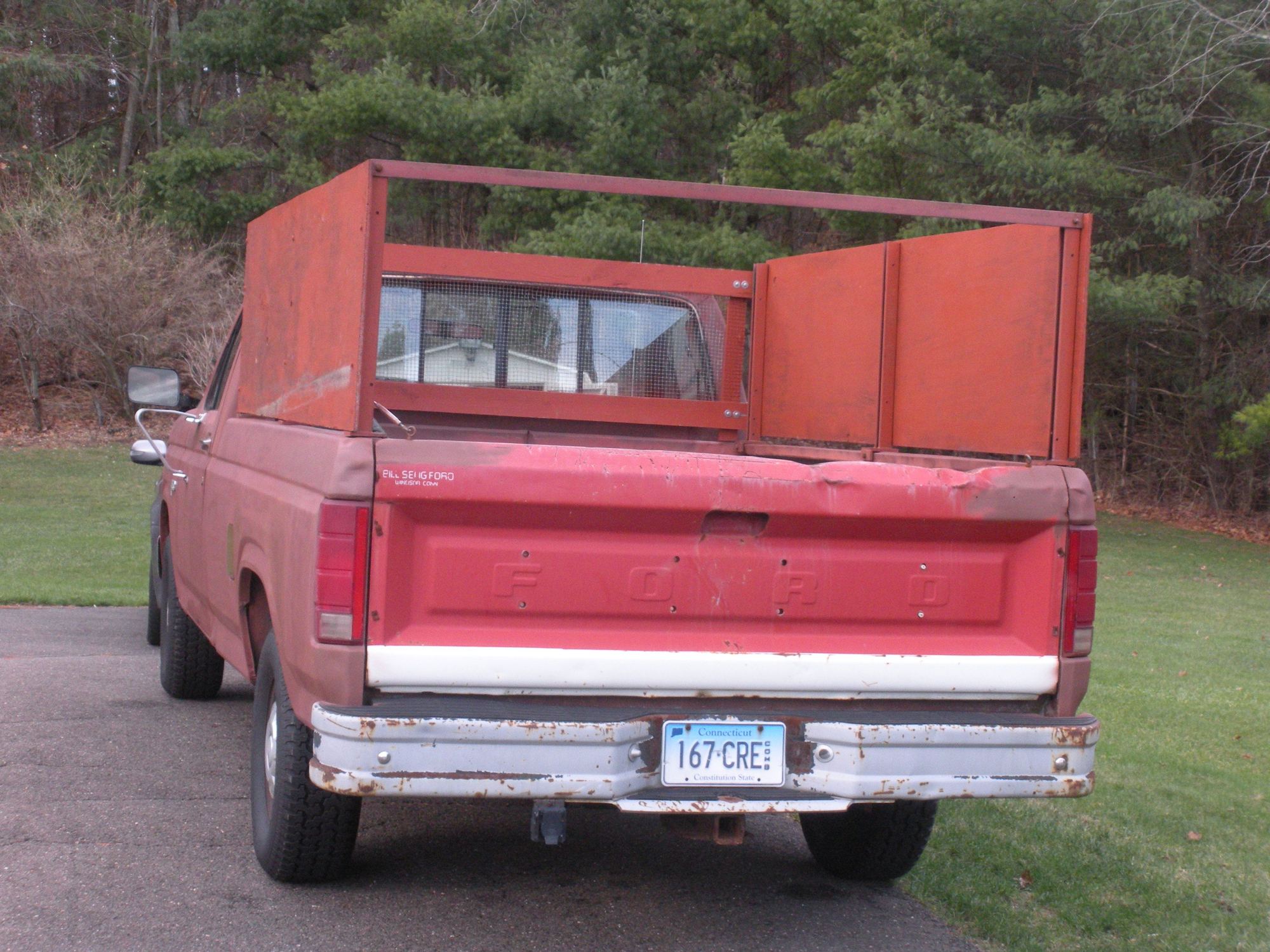

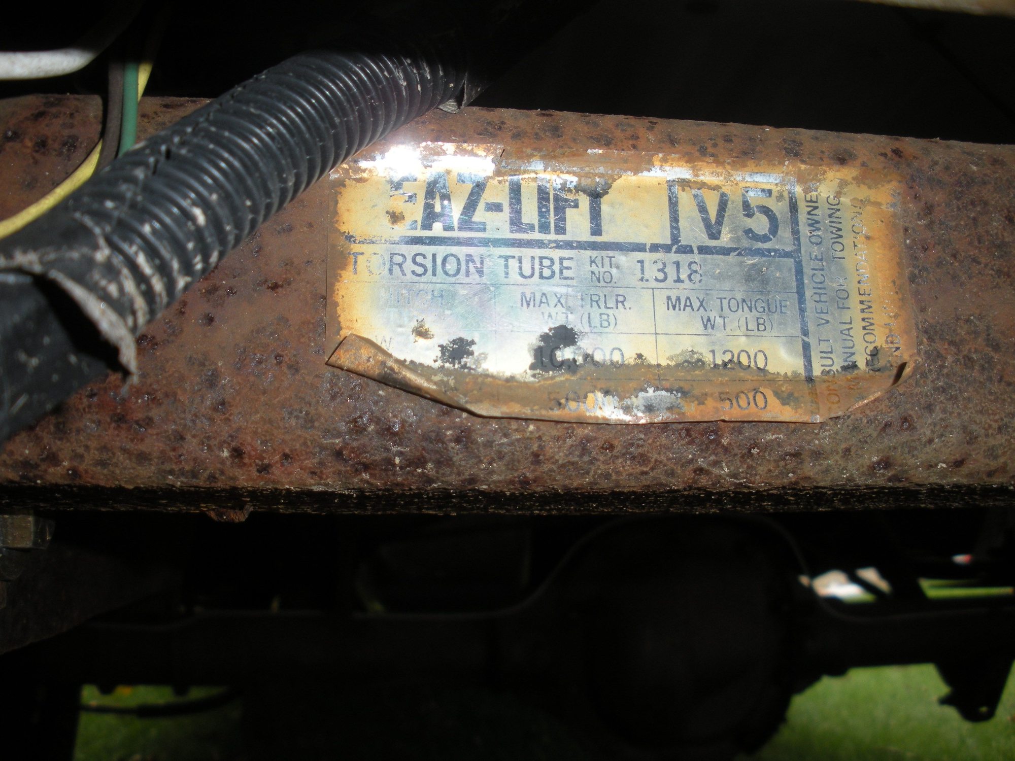

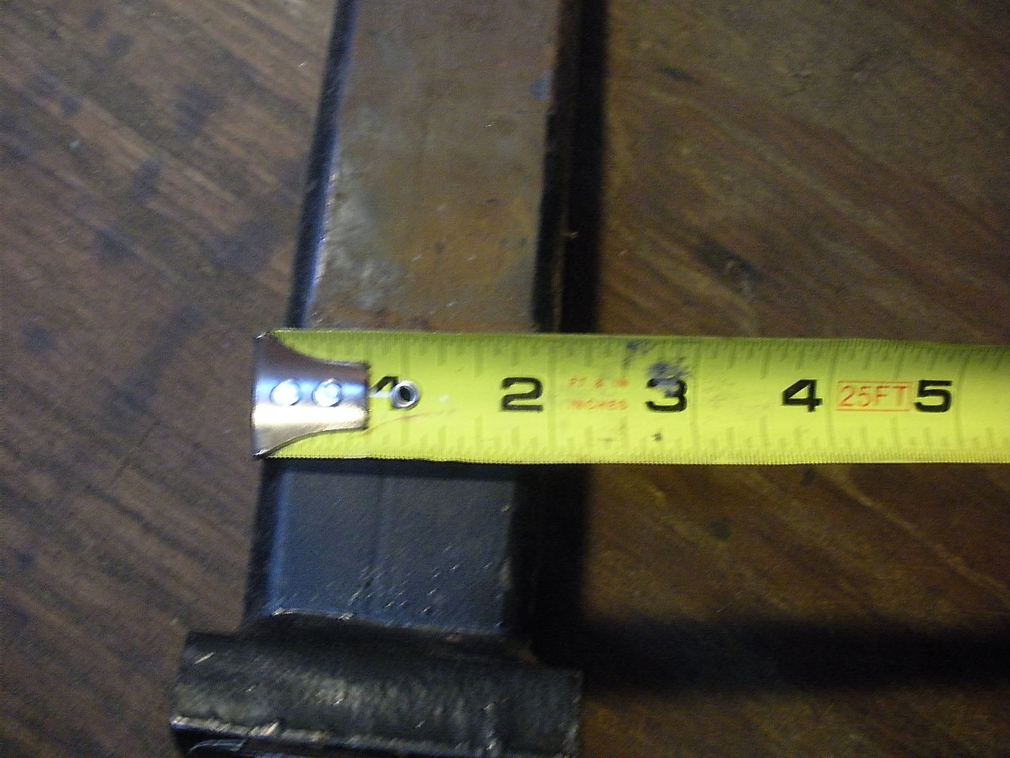

I'm asking if the hitch female opening will take the 2" square slide in piece that will hold most any size ball. I believe mine is a 2" opening, my trailer took a 2 5/16" Ball.
Sorry for the crappy pictures, it's cold in the shed.
