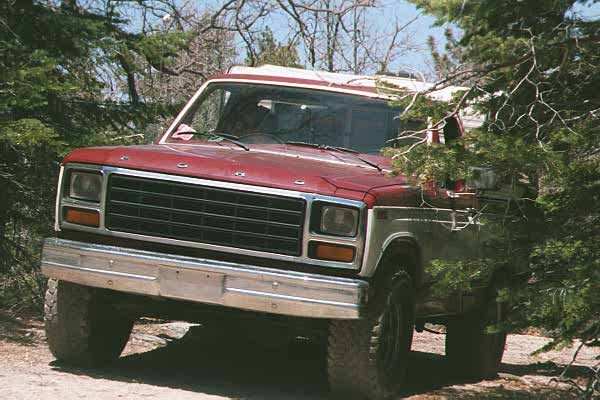

A number of years ago I had a 1981 F-150 4X4 with the 300ci (4.9L) I-6 engine and the 4-Speed manual transmission. I added a 4" lift and locked both front and rear differentials. It was a pretty capable and fun truck for the Off Road Vehicle trails here in NW Oregon, until the rear diff blew apart. My hunch was the the rear diff locker was improperly installed causing excessive metal fatigue in the ring gear, but I will never know for sure.
I really liked driving this old truck and I am thinking I might want to have another similar truck to have some fun in. Anybody with thoughts or recommendations? I like the two tone paint job as well as the engine and transmission combination, so I think I'm stuck in the '80 to '86 range. Did this truck model ever come with a fuel injected 300ci engine? Was this engine/transmission option offered in the F-250?
