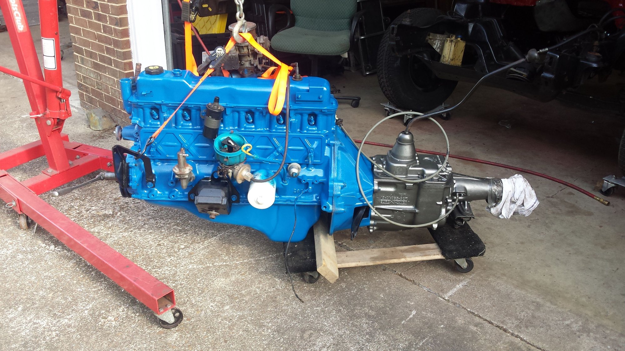

This is a NP435 stick and if you look at where the boot sits is only 7.5 inches back from factory because of the overdrive I have in the truck now.

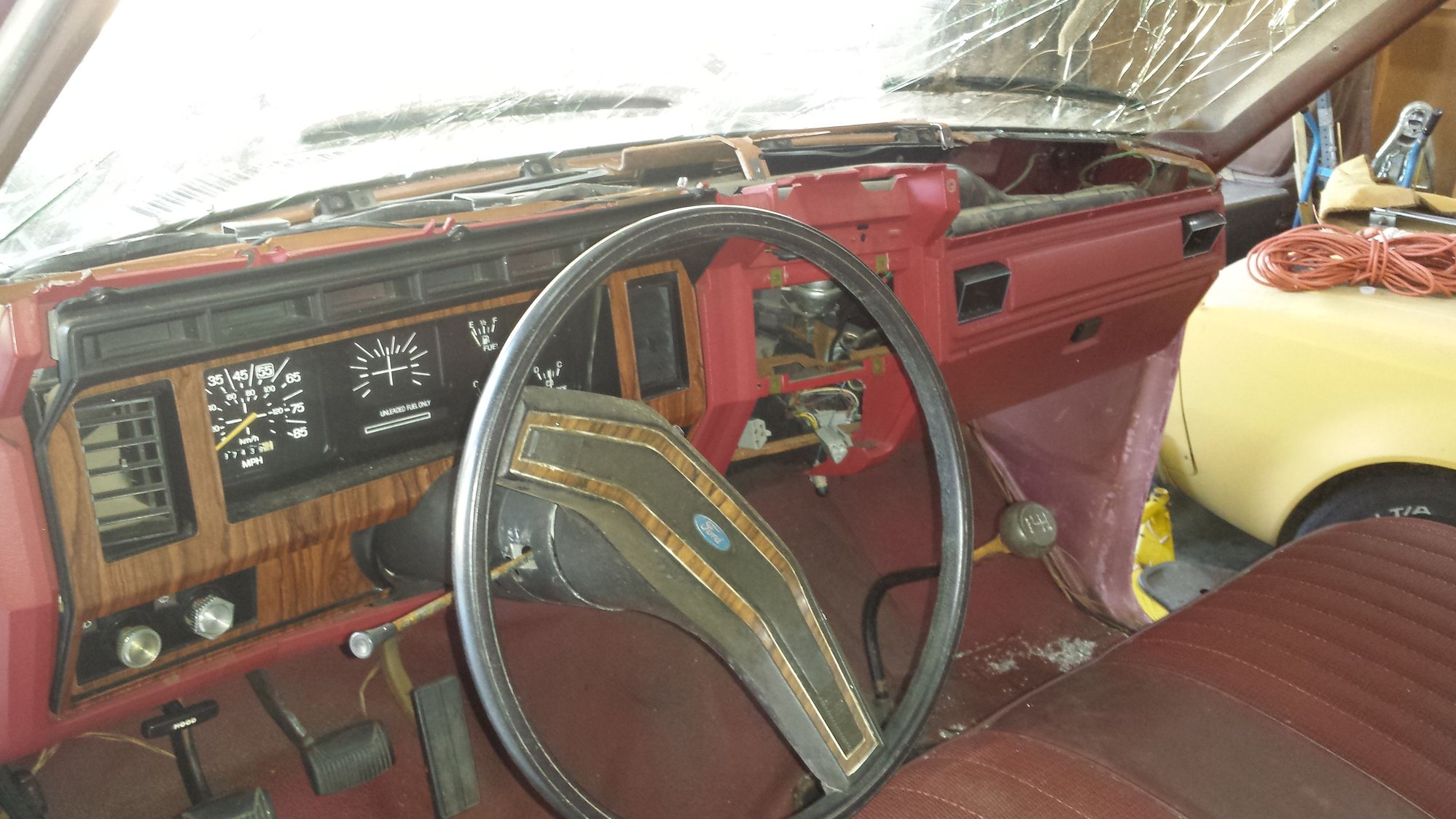

This is a T18 the truck came with and you can see the stick is more straight than the NP435. BTW both have granny first gears.

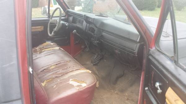

This is the shifter for a SROD
I dont have a picture of this trans out of the truck and I have not seen the shifter stick since I pulled the trans from the parts truck.
