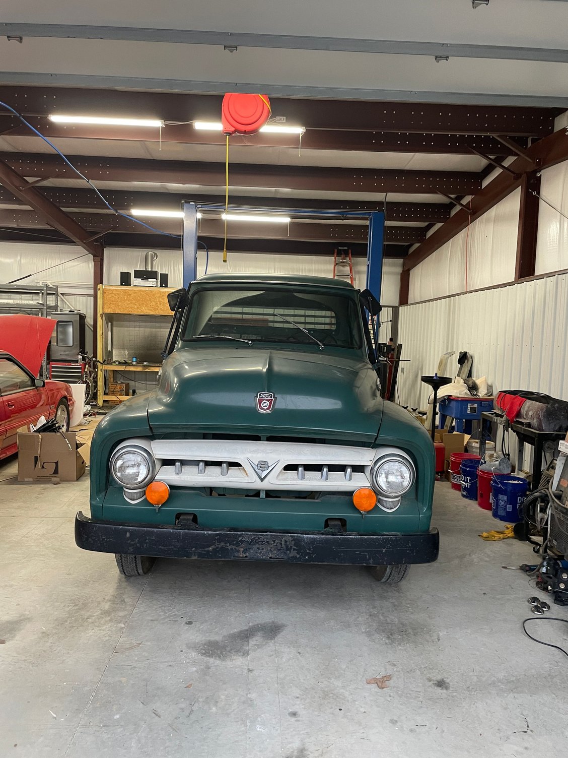

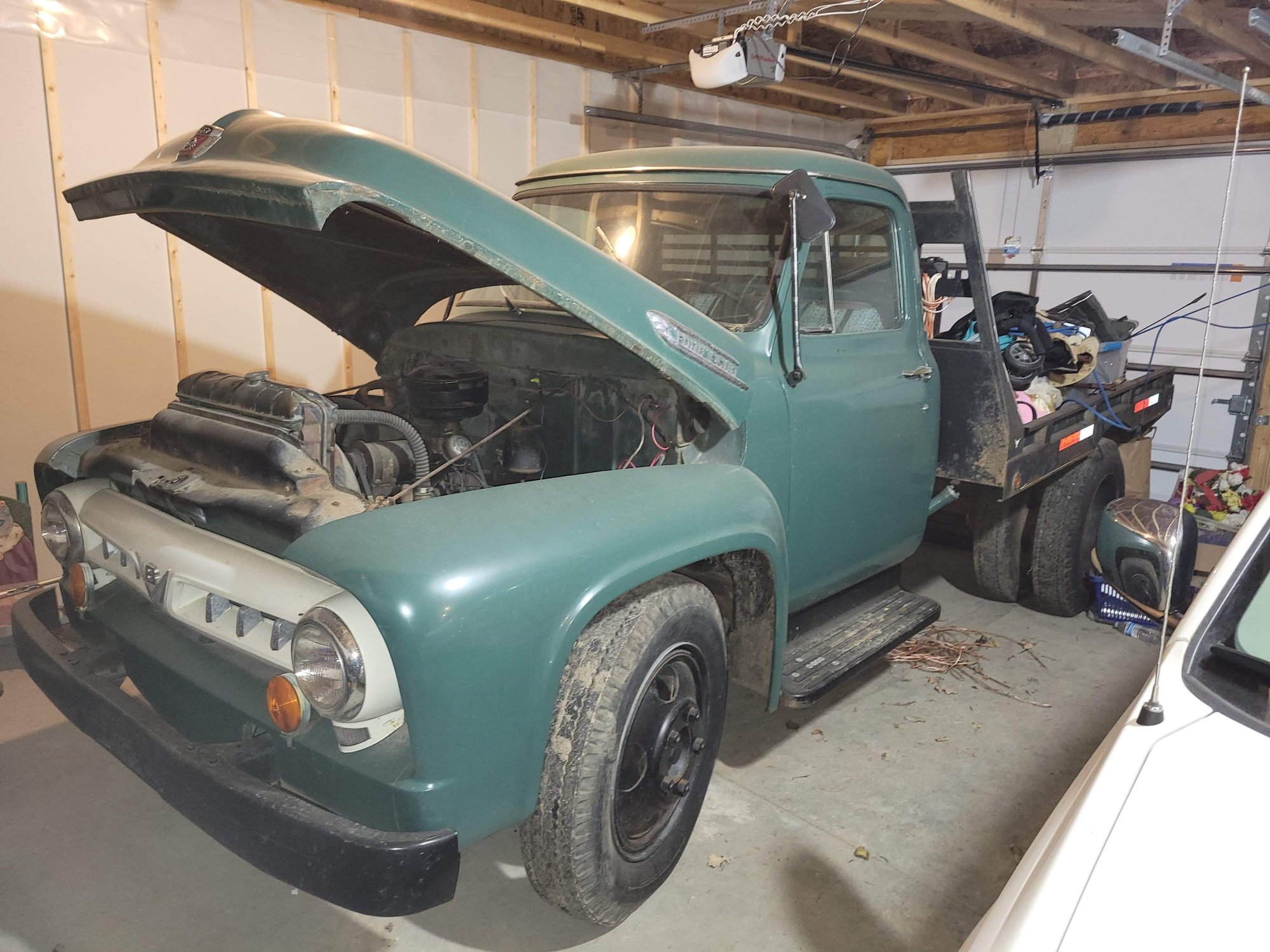

I recently picked up this solid 1953 F500. As far as I can tell, it’s all original except it has lock ring wheels and an electric fuel pump. It runs and drives, but the brakes need attention.
The plan is for a 1-2 year project to make this a safe reliable truck. I have found a lot of great information on here already. Brakes are first on the list and I’ve already talked to Chucks Trucks. Lots and lots of options going through my head. I wanted to keep the flathead, but after talking to some engine builders very familiar with the 239, that’s all but off the table. HP is just too expensive. I haven’t ruled anything out, but thinking about trying to find a donor truck with a mechanical 7.3. Swap over the engine, trans, and axles.

Nice old truck, looks like that paint might buff out to a nice shine yet. Looks like a good one!

Nice truck...good start for a project. abe will approve of the color!

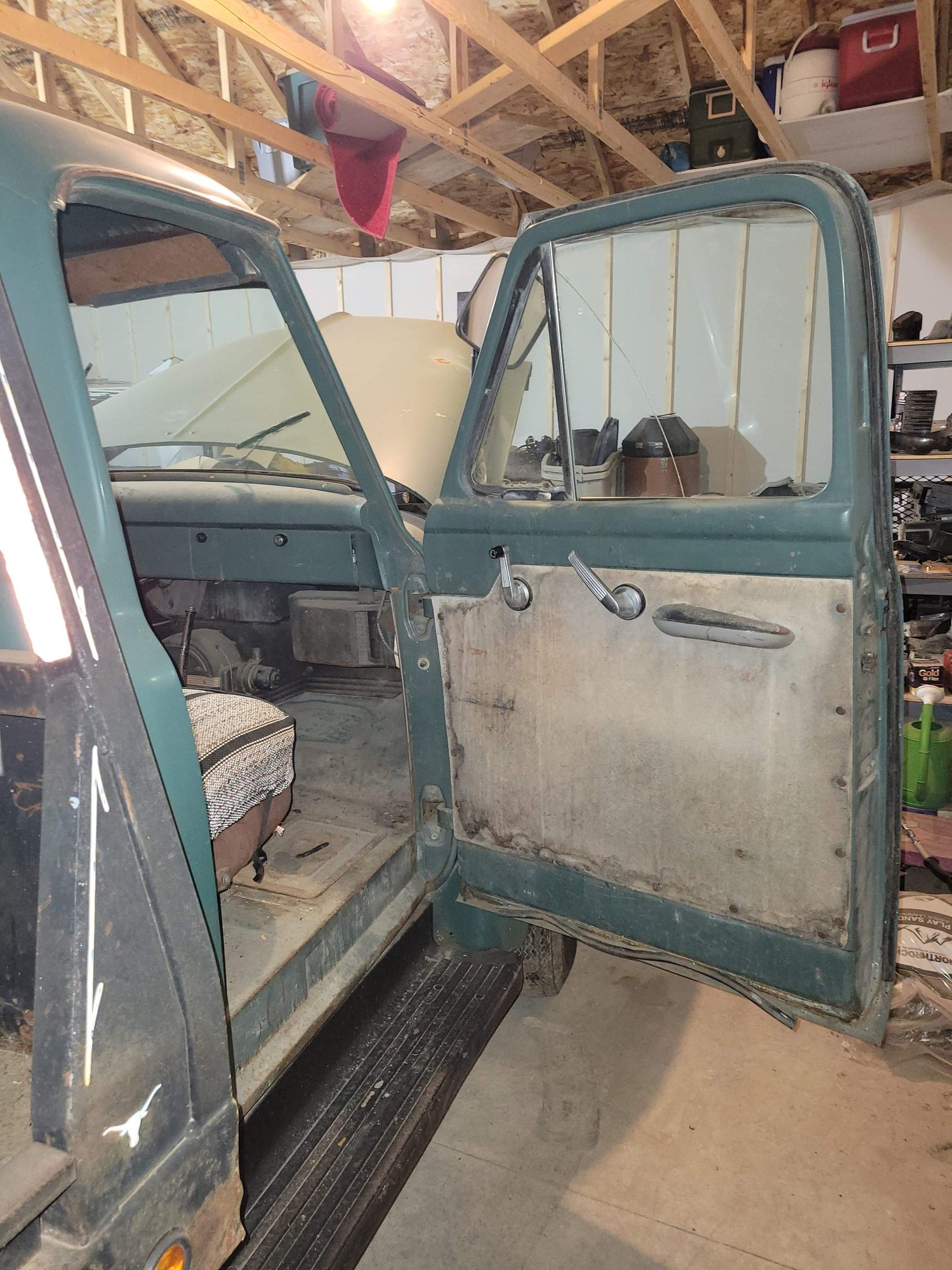

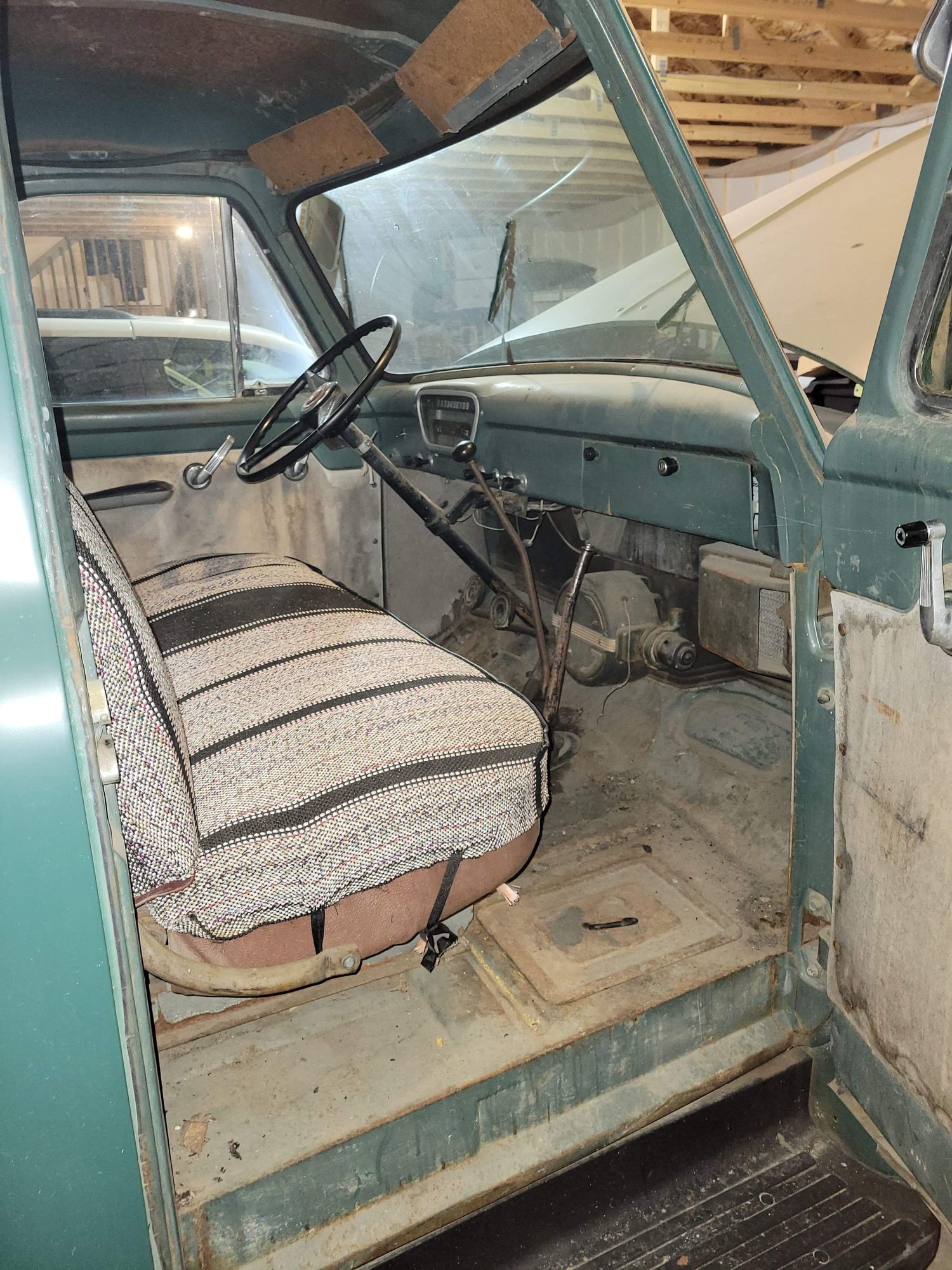

I added a few more pictures for attention.

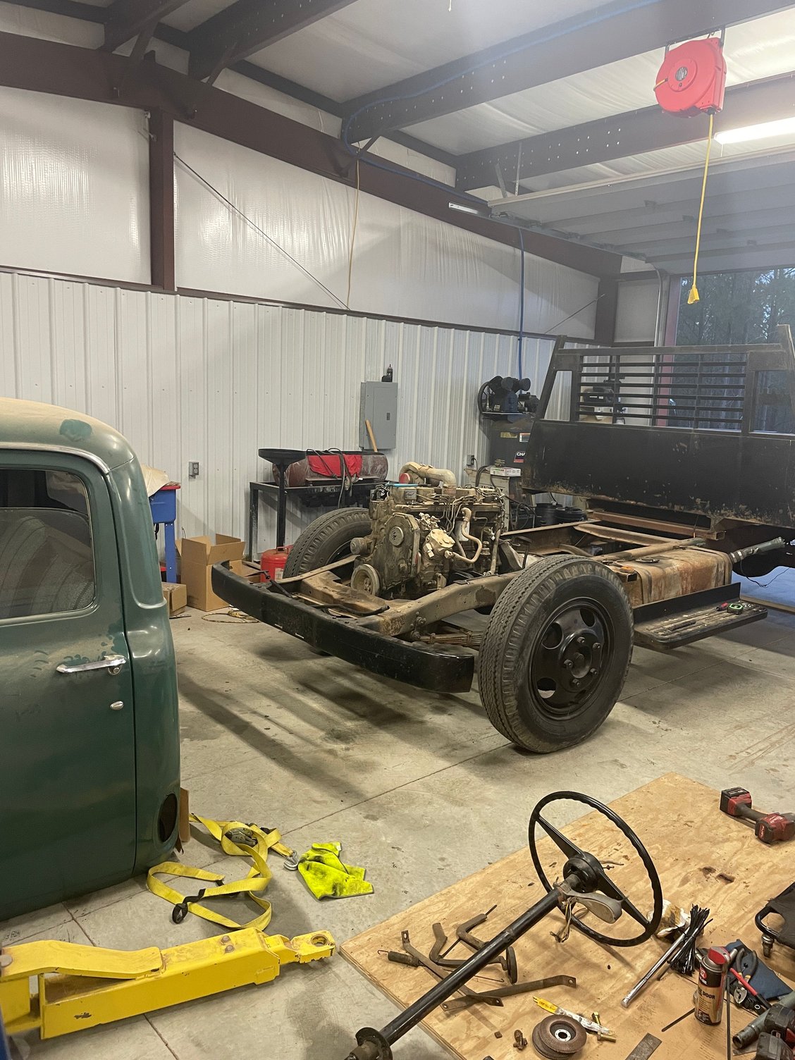

I met with two builders very familiar with flatheads. After discussing what I plan to do with the truck, and what it would take to get there, we decided to do a swap. It’s not all bad though, I found a local who has been searching for a 53 Flathead for his 47 build. He wanted a 53 for the changes, mainly the distributor location.
So, current state is still tear down. Got the 5.9 Cummins and auto trans mocked up, mounts built, cab off. The flatbed is welded on, so I’ll have to cut that off. Then the chassis will go to the fab shop who is going to box and sand blast the frame.
