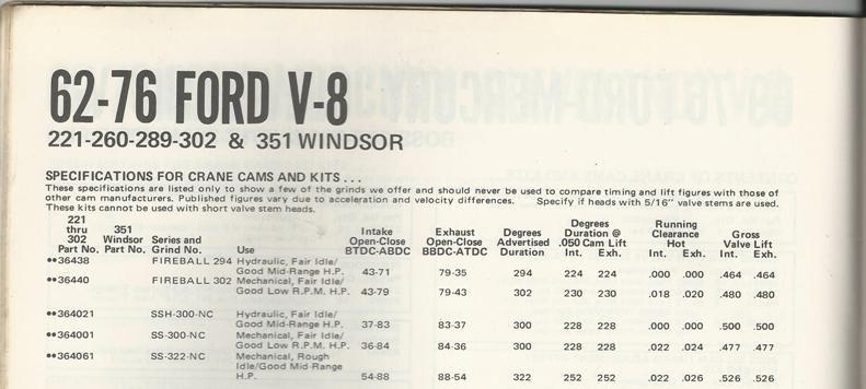

.I would assume that the same lobe is used on either engine. According to the catalog.300 lobe lift goes from .480 valve lift with a 1.6 rocker ratio to .519 with the 1.73 used in the Cleveland engine. Lash goes up to .020 and .022. I didn't know that there were solid lifter Fireball cams. I wonder what the "A" suffix means too. Was that a different lobe in the series with similar duration but other differences?
