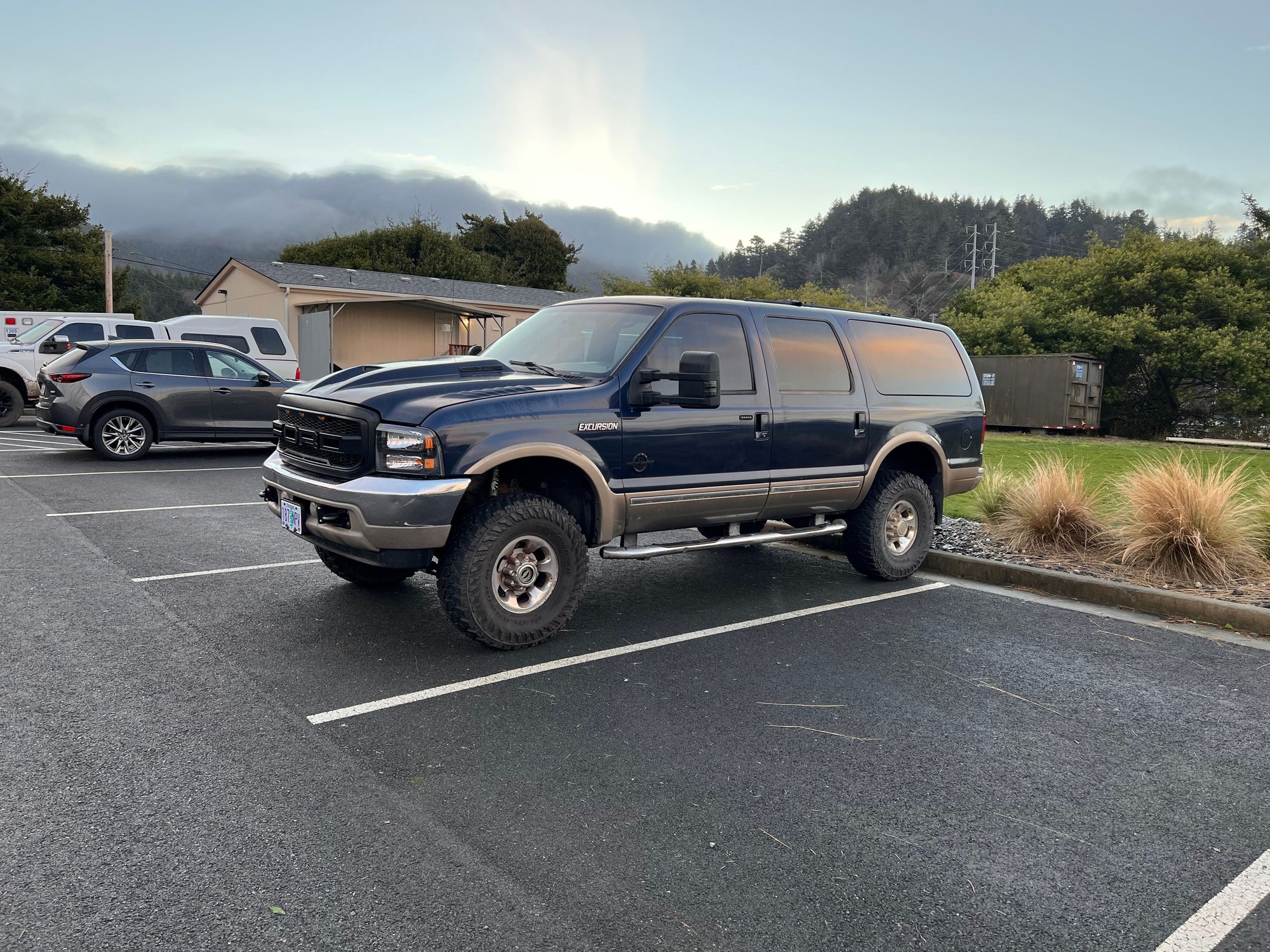

6.8 V10 X's up here in Oregon aren't going for much. Had the chance to buy a very clean 2003 4WD X with 35's and about 125k on it for 10k... but wasn't sold on V10. Ended up flying to Montana and buying my current 7.3 with 215k for 14k... probably still overpaid but it is what it is.
The V10 market isn't nearly as high as 7.3. Anything above 100k miles shouldn't be more than 11-12k. If it is, then open up your search area to less expensive areas and buy yourself a place ticket... that's what I did for my 7.3 as where I am they are going for 25-30k. A plane ticket and a road trip saved me a lot of money.
