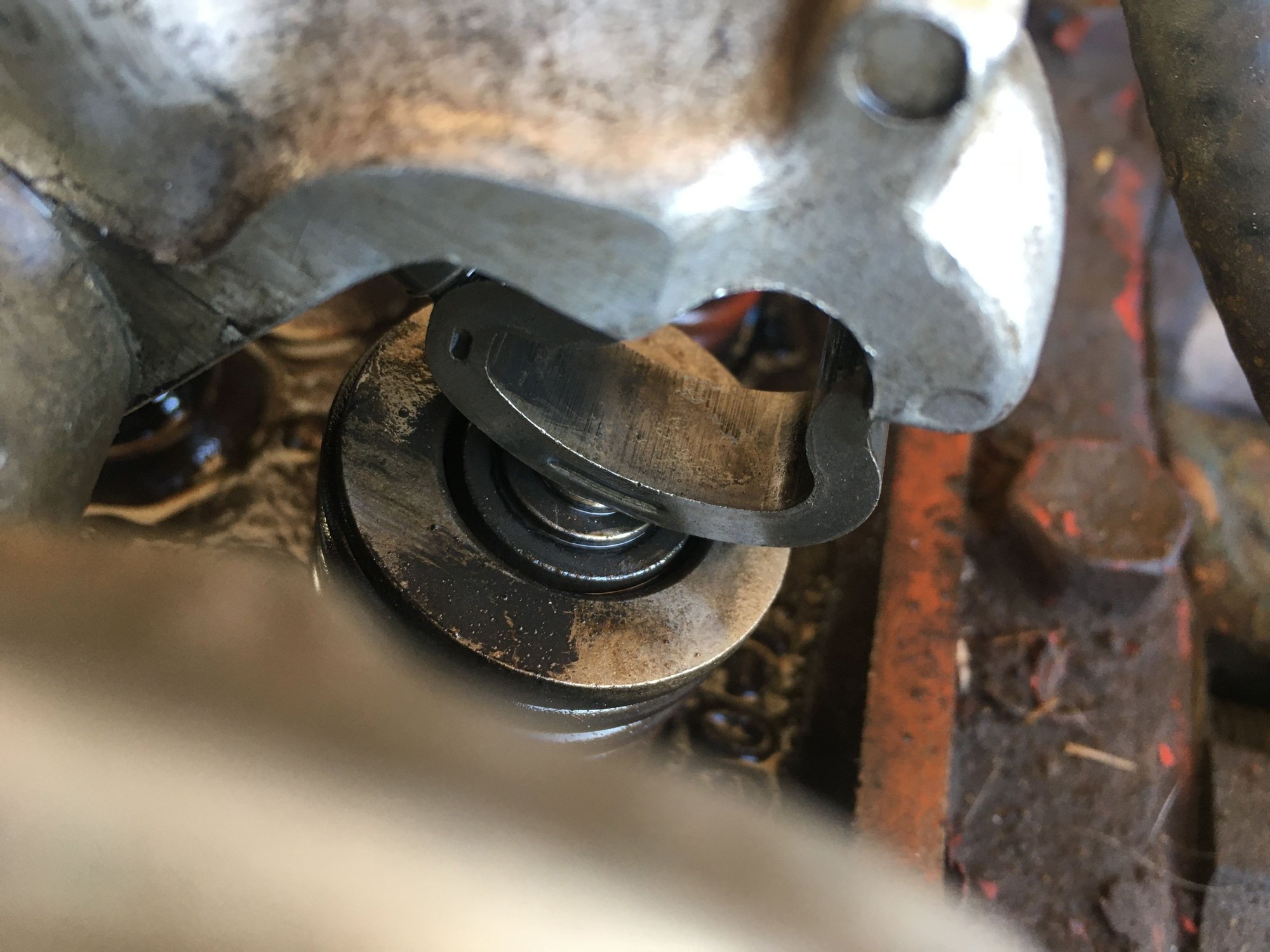

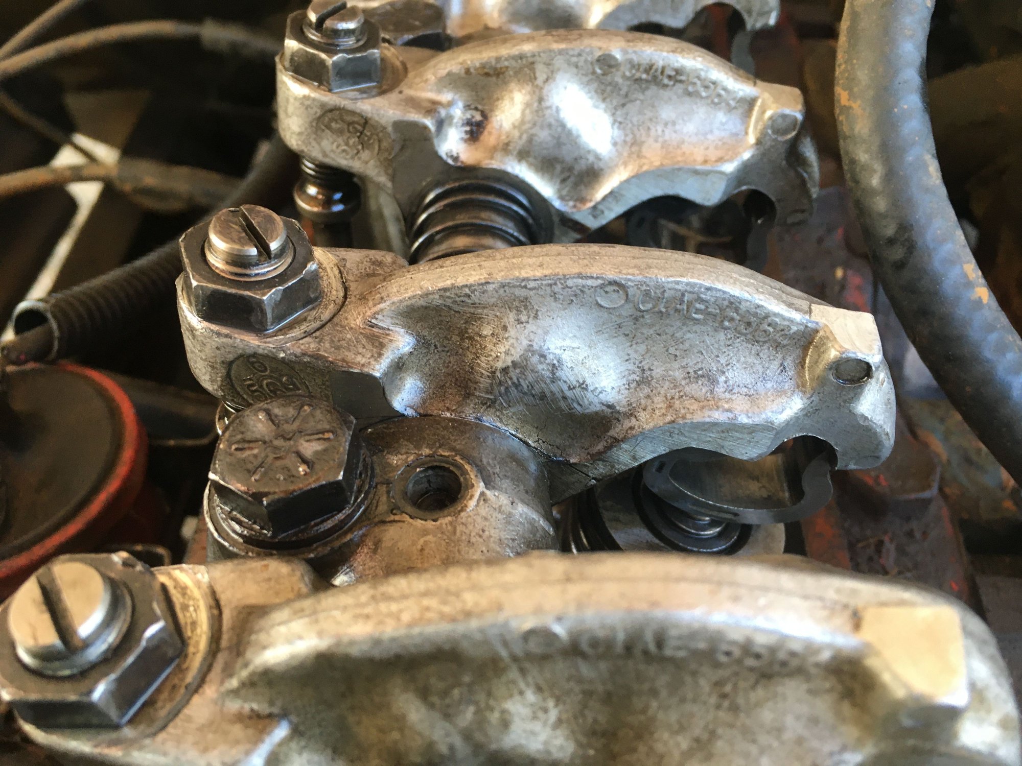

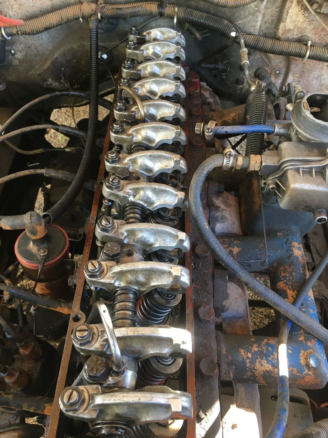

Hello! First time posting here, definitely not a first time reader! I have a 1958 F100, but I’ve put in a 223 i6 from a different 1964 f100. Everything is virtually the same, but this damn valvetrain. I have struggled getting it to run properly for the past odd months. I thought maybe it was just has too low of compression. Finally did a compression test and all cylinders are reading just above 90psi. With the exception of one cylinder at 115. Not the best, but should run/drive fine enough. My biggest question here is if anyone has any information on how to tune these things? I’ve scoured the internet and read that you just bring cylinder to DTC and center mark the actuator over the valve stem. So, I did that today, and now the truck won’t even keep at idle. Any advice/help would be greatly appreciated. Thank you for reading! I’ve attached some pictures to hopefully visualize

Another problem I see is that Blue hose. Unless you have a distributor that has been converted to a dual advance, you have a Load-O-Matic distributor. That fitting is for the spark control valve and should be connected to the vacuum canister on the distributor.

Also the oil tube for the overflow isn't seated properly into the rocker stand. The hole in the shaft needs to align with the hole in the stand for the tube to fully seat.
I had been meaning to fix that! Tube was bottoming out and hitting. I trimmed it up and it’s back in place correctly. Thank you!

And for the distributor hose- it is hooked up, just over at the intake manifold instead. That’s how every engine I’ve had for this truck has been. So I figured I’d just leave it. There used to be a rubber cap on the carb vaccine port, but it fell apart. Thank you for the responses! It’s all much appreciated

Try hooking your distributor up to where that blue hose is and see how it runs. The Load-O-Matic distributors that came in those engines do not work the same as the dual advance distributors. It MUST be connected to a carburetor with a working spark control valve in it. If you hook one to full manifold vacuum, you will have all sorts of drivability problems.
After you tighten the valve, "with the eccentric all the way back" until it stays back, very slowly loosen the adjustment until the mark on the eccentric is centered on the valve stem. Start it up and see where the mark is if it isn't centered, and the valves are ticking you have to readjust them with the engine idling.
Trimming your oil return tube IS NOT the solution.
As Hiball said you have to have the hole in the shaft aligned with the hole in the rocker.
