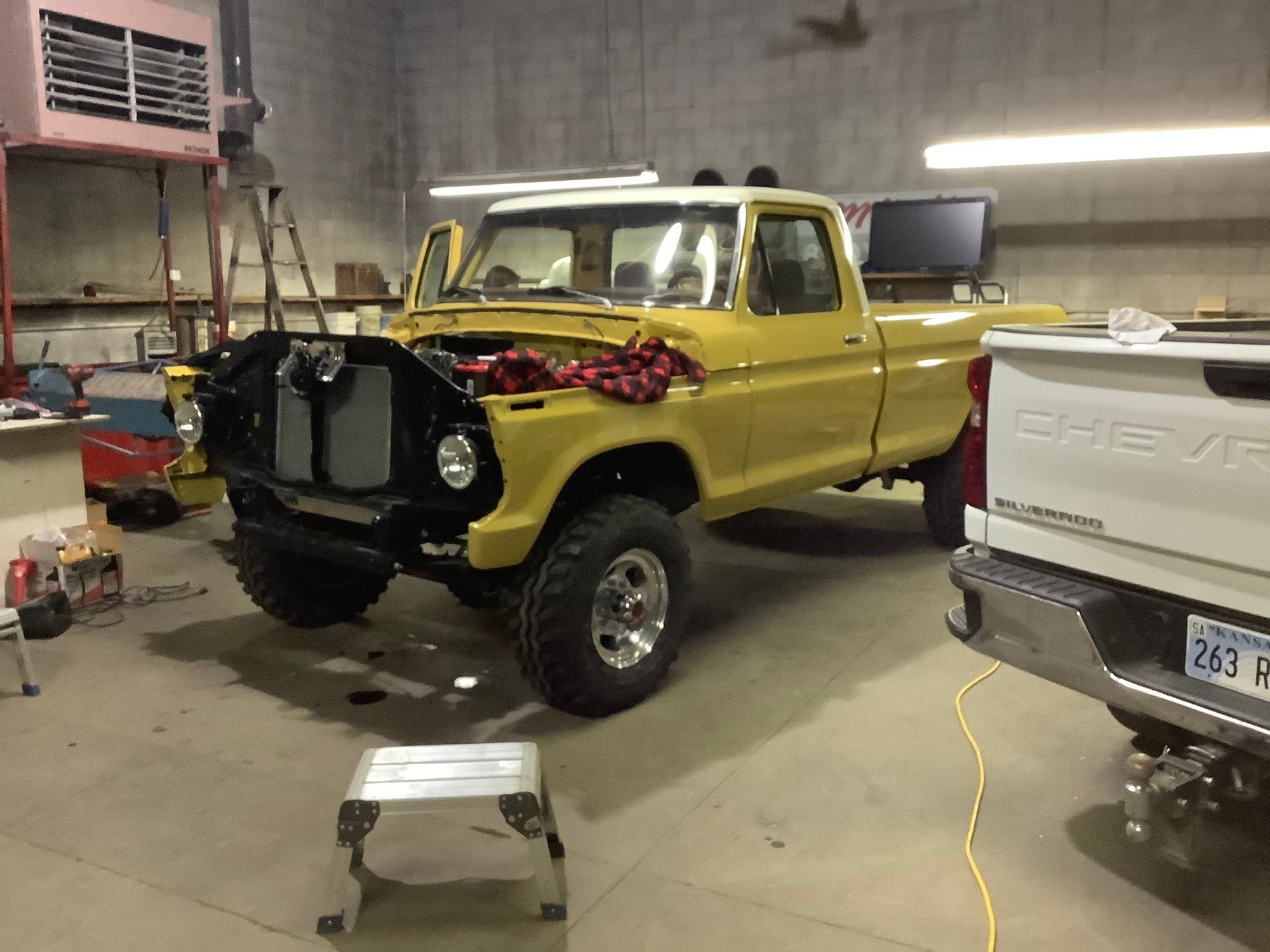

Old school 16.5 slot rims and some timeless Super Swampers!

Nice! Too much tech for me. But glad to see those that can figure it out. I ran Thornbirds and Super Swampers for years. You just turn a deaf ear to the on-road noise. Truck looks great.

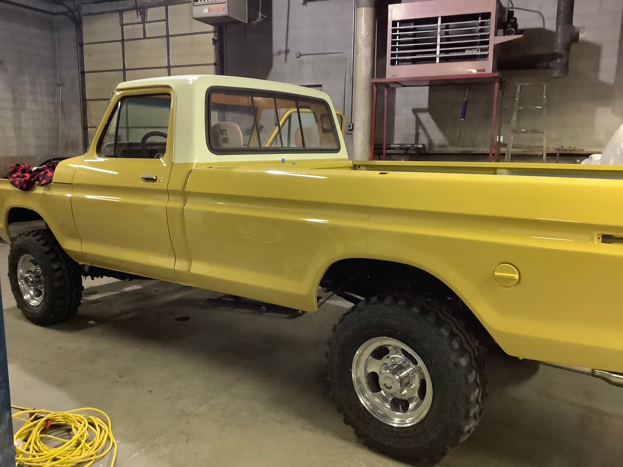

Out of the shop! First test run today! Awesome just awesome! Need to tweak it more but it is moving again.

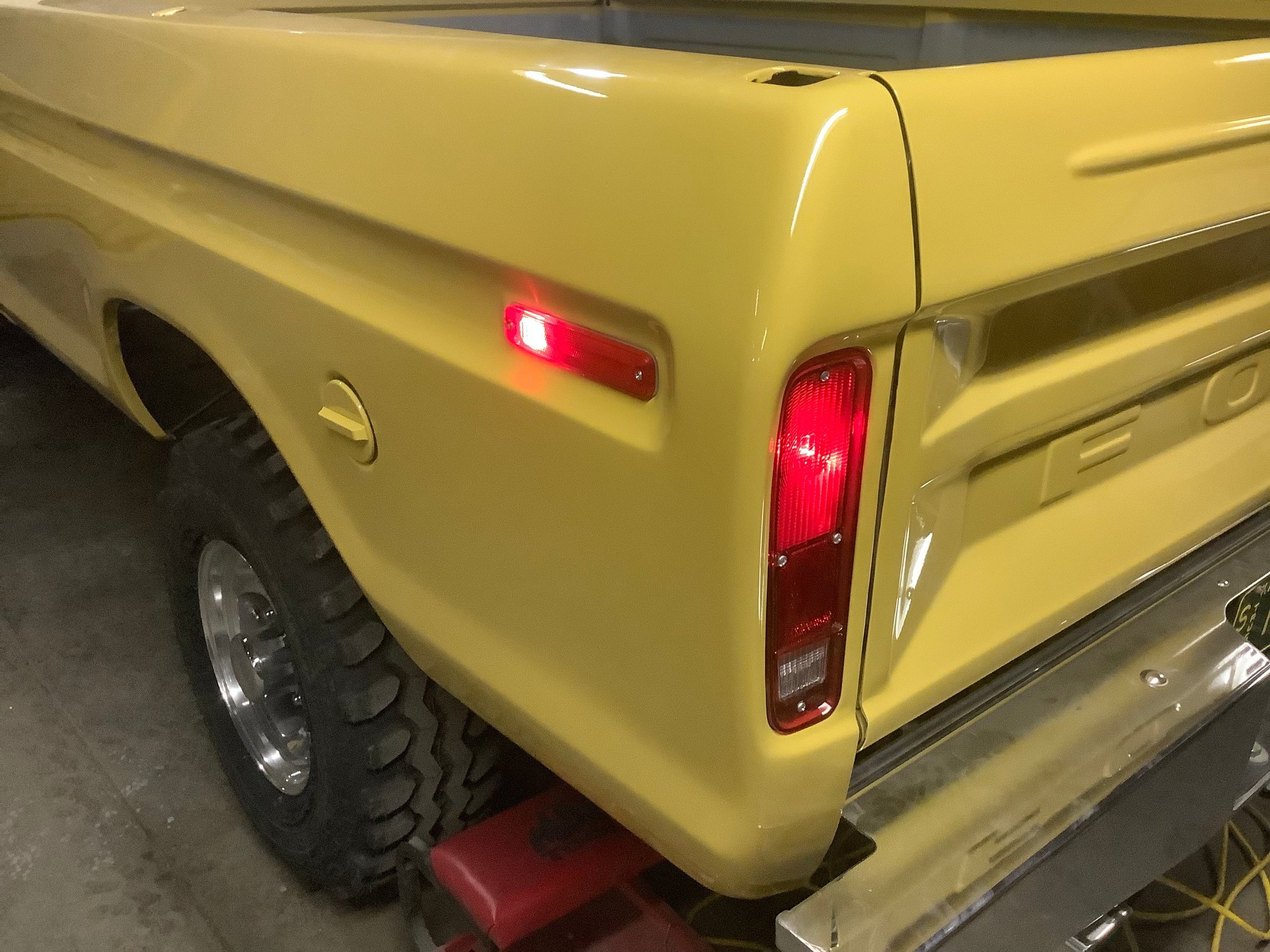

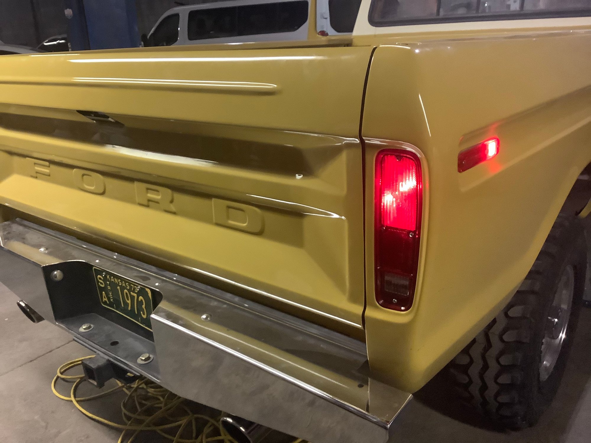

Got the tail lights in. All done with the rewiring! American Auto wire kit was awesome! I used the painless wire loom and that stuff is great also. Still trying to get a video on YouTube so I can post here of it running.

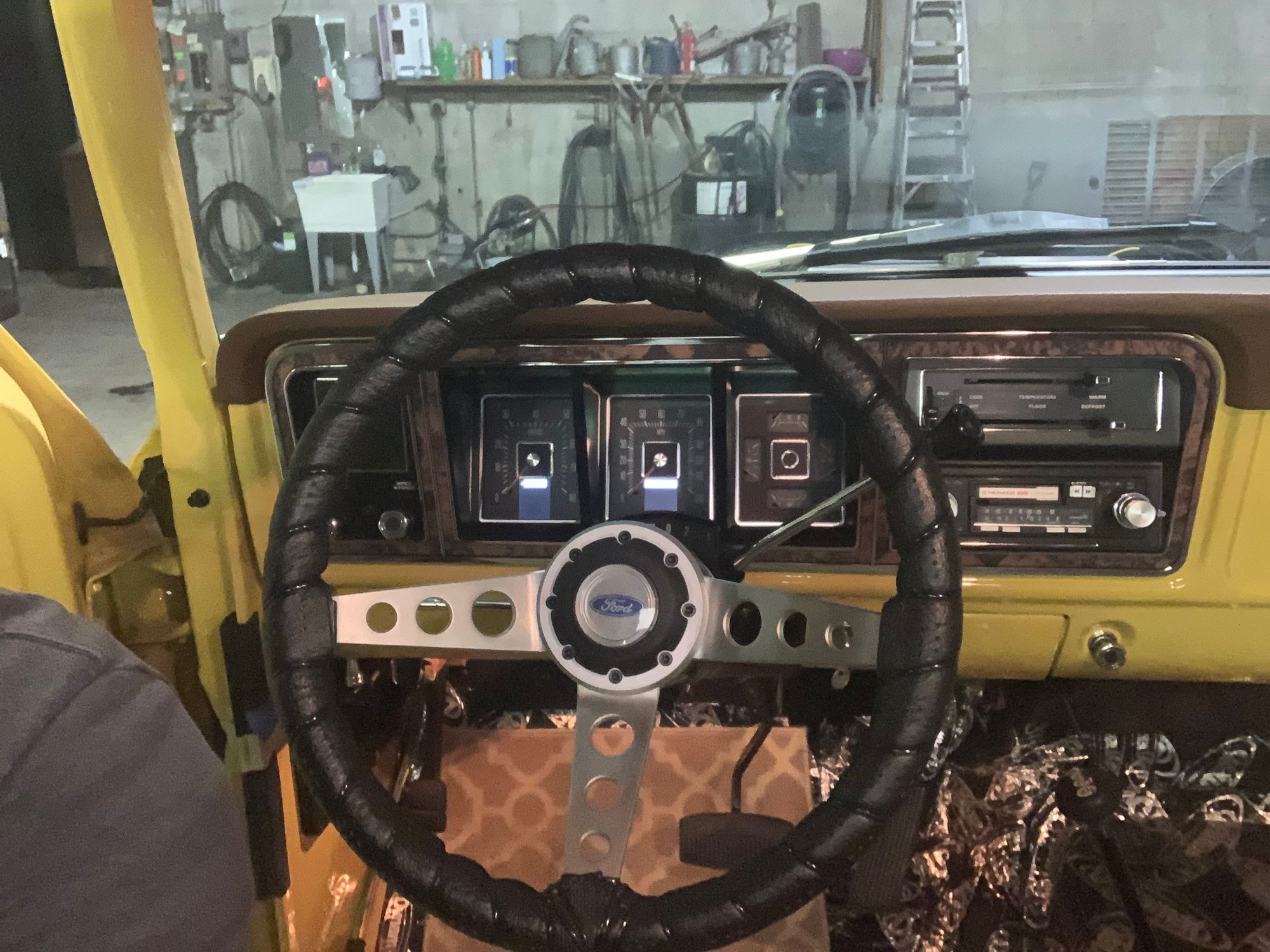

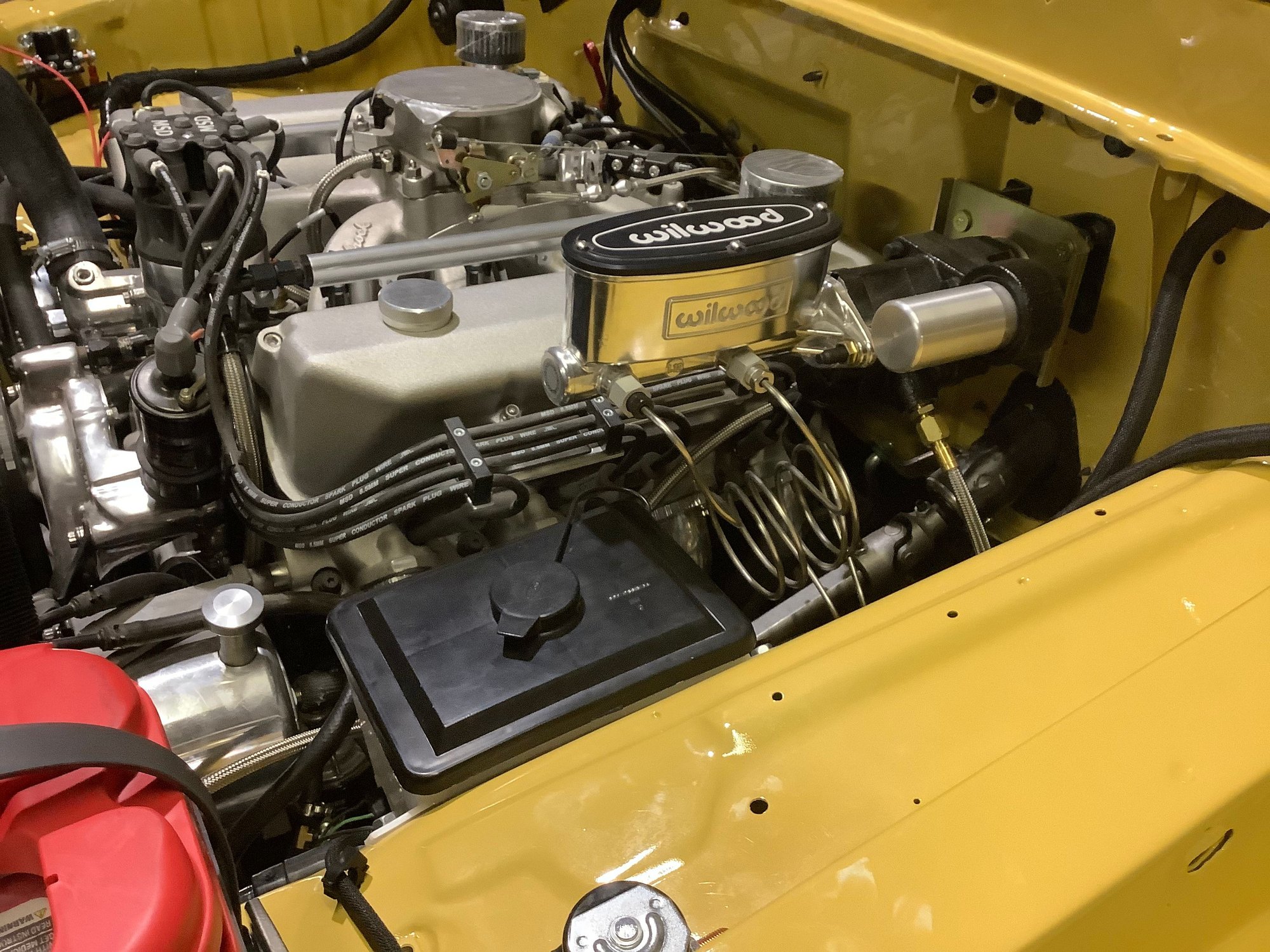

Beautiful truck! What is the purpose of a starter solenoid looking thing on each side of the engine bay?
How was the edelbrock EFI to install and work out?

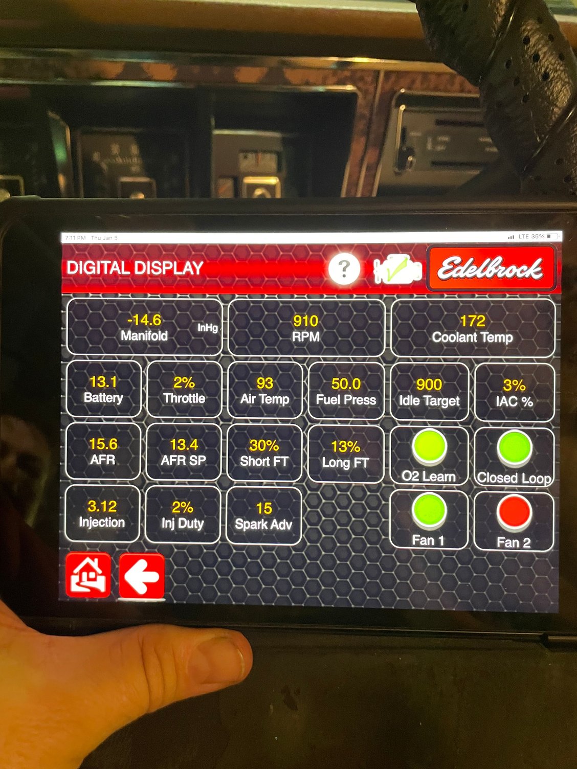

The one on the passenger side of the truck is the starter solenoid and the one on the drivers is for the second battery. It opens up when there is 12 volts applied and charges the battery when running. When you turn the key to off it closes the line and lets you use that battery only for the extra stuff with out draining the main battery. Not impressed with the Pro Flo 4 yet. I am still working on getting it running right. Of course everything is on back order still. I am sure it will be killer once I get it figured out! I know it’s not high tech for most but for me it is like rock science, lol. I will get it though.
