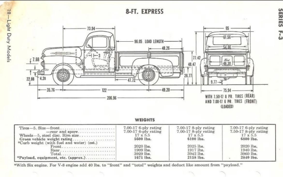

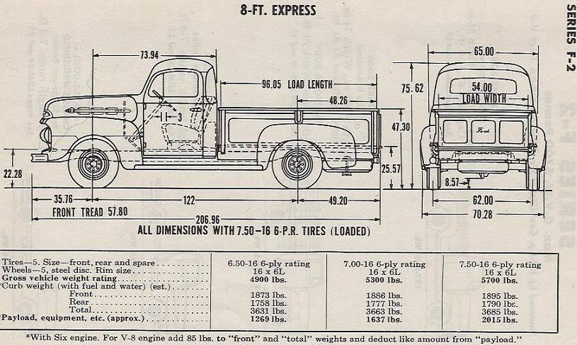

I thought it might be helpful to add that there is a big difference between the F-2 and F-3. You’ll see in Tim’s F-2 schematic that there are 16” wheels where your F-3 has the 17” wheels. The F-2 model could use the 16” wheels because it had 12” Lockheed rear drums. Below is the F-3 schematic.
I should also add that there are replacement options for the 17” widow makes that allow you keep the truck OEM stock in all other ways. Beginning in 1956 Ford offered both 17.5” and 19.5” tubeless wheels for F-250s. Finding a set of either of these gives you a bolt on fix. If either of these solutions interest you we can go into it deeper. Stu
